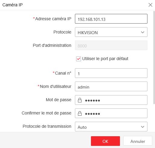

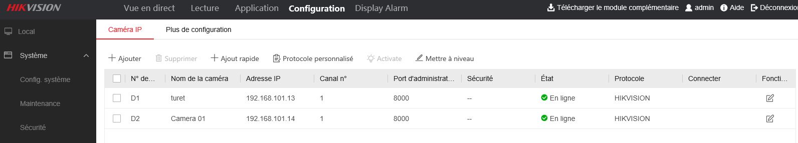

About camera management from NVR, I go through: (sorry if mistake from menu translation from french to english) Configuration > System > camera management. Then à Click on Modify (pen icon) at the end of camera raw...
But as shown on screen, I do not get many options, this is just to connect camera, not to manage/configure cameras...

To configure the directly connected cameras you need to enable Virtual Host which generates virtual links to each camera which allow direct access to each camera's settings (these links should appear under the Connect/Connecter column on the camera management table).
Thanks.
This is just a link to the page of the camera, (the IP of camera is just 2 colomns next not a good integration... )
Thanks for your information even if I'm not "satisfied" with the integration NVR/camera... for example if I want to rename all my cameras, I have to connect on each of them... (and browser seems not to retain password for cameras/NVR, same for bitwarden, it can't paste password to access nvr/cameras) disappointed...

Camera name can be changed in the NVR settings, you need to go to Configuration > Image > OSD Settings and you should see a box labelled "Camera Name" which will let you edit both the on-screen camera name and the name that appears in the device list.
Other more camera-specific settings (e.g. certain smart event settings, advanced image settings, etc...) can only be edited by accessing the cameras directly.
