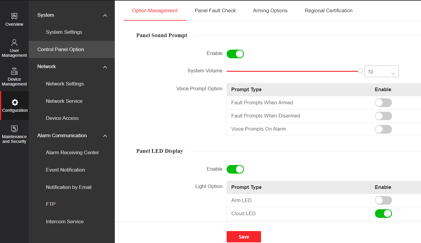

Looking on the AX Pro web console I think the only way to turn that off would be to "disable" the panel sound prompt on the "Configuration" >> "Control Panel Option" page, but that would mean no sound from the ax pro hub when the alarm is triggered right? Does anyone know a workaround so that I don't have the hub announcing "system armed/disarmed" but still alerting when the alarm is triggered?

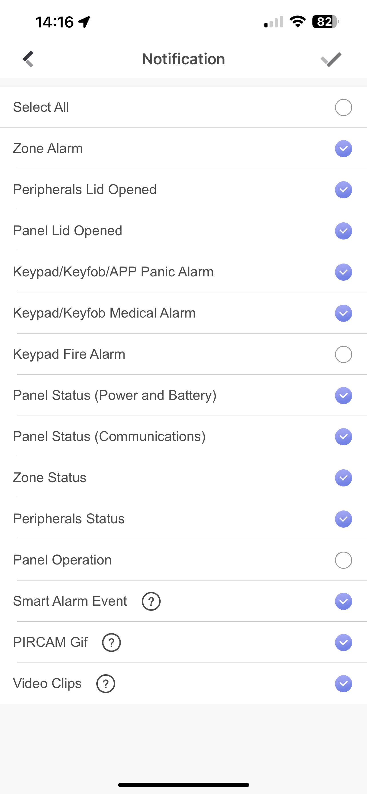

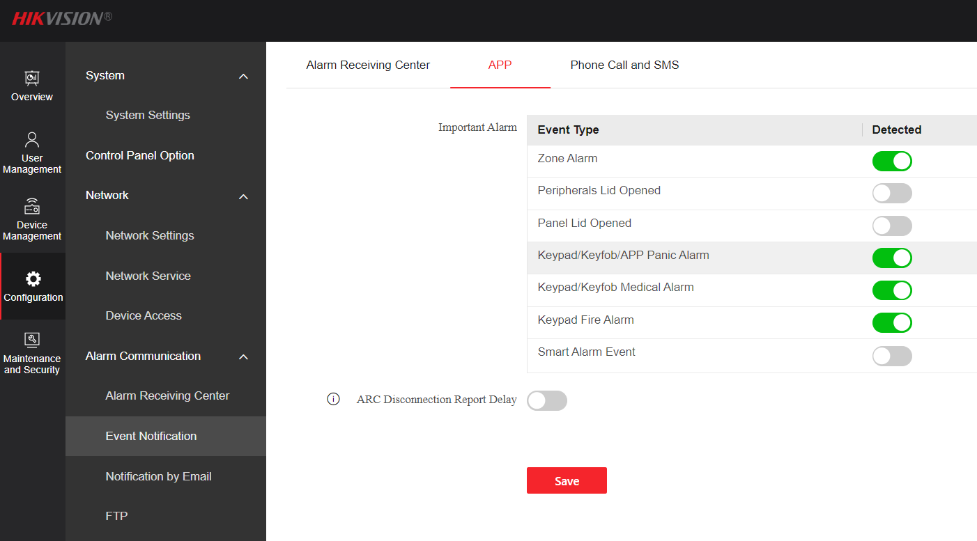

Also, the app on my phone is getting an alert whenever the alarm is armed/disarmed as well. I've checked the notification page and can't see how to turn it off. I've attached screen shots of the 2 pages I've referred to in case that helps.

You can disable the app alerts relatively easily. Notifications changed a lot in the 1.2.9 update so assuming you are on that. If you can login as admin and go to the admin user, you will see notification checkboxes. Untick “panel operation. Image attached.

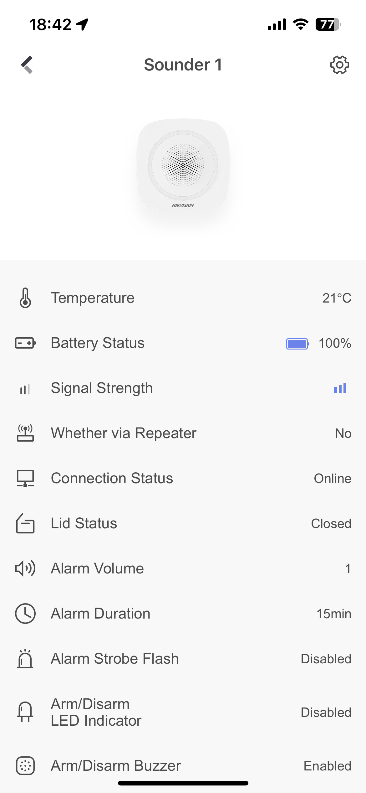

As far as the noise from the auto arm and disarm. I haven’t really played around with that. If you switch off the sound prompt you mention, does that definitely switch off the alarm noises? One work around is if that is the case is to buy an internal sounder. Set that up and then disable everything from the control panel. The sounder can be configured so no noise is made when the alarm is armed/disarmed but will be vocal if an alarm occurs.

I have my panel completely silent at all times, and have integrated an additional internal sounder. That has the ability to control arm/disarm sounds and alarm trigger audio levels. That might be the easiest solution. I have mine set to an audible beep for auto arm and auto disarm - but you can set it so that the only sound it makes is when the alarm is triggered.

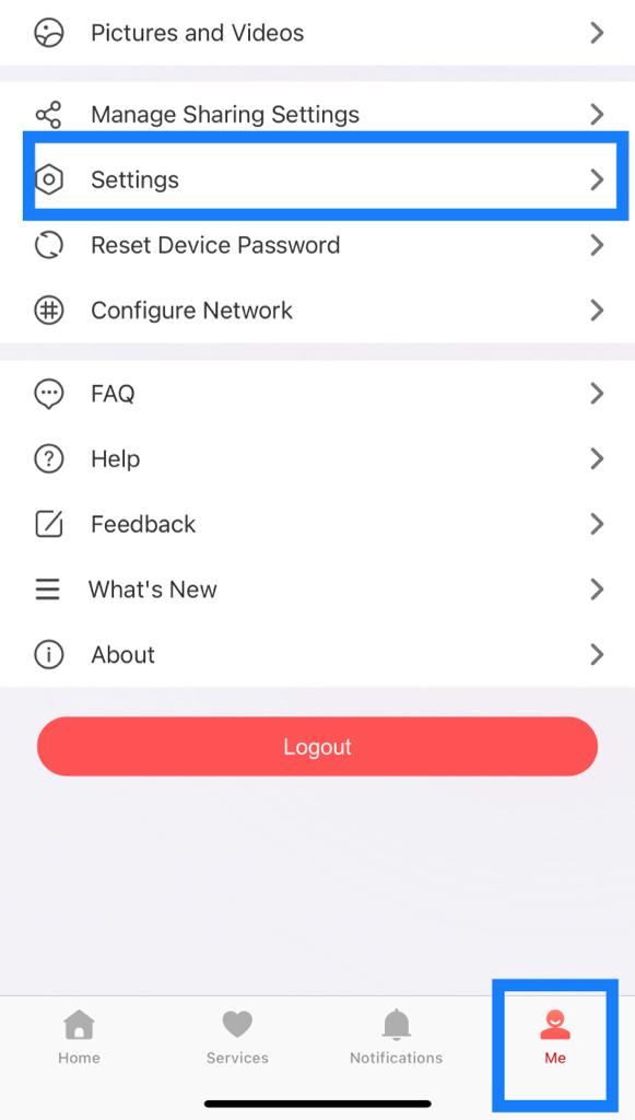

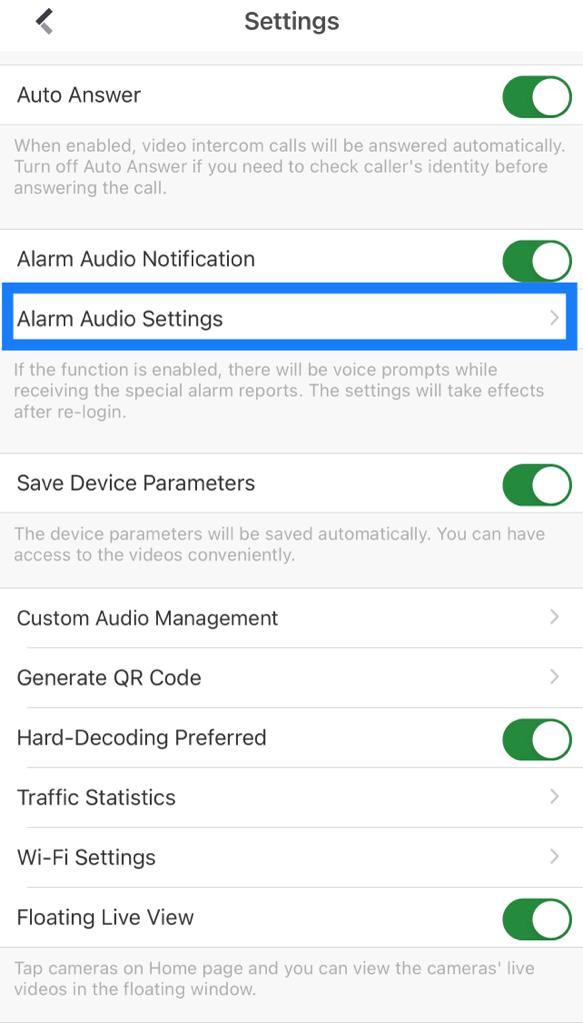

Open Hik-Connect app and select "Me" and then select "Settings". Under settings select "Alarm Audio Settings" and then you will see Arm and Disarm is set to "Voice". Change this to "Ringtone". I hope this will resolve your problem. Screen shots attached
While this is definitely better than the Voice, the downside is that in iOS the only sound is a siren, which is inappropriate for arming and disarming. Any ideas?
I created "custom alarm audios" to avoid scaring the absolute crap out of me.
There are many websites capable of converting text to voice; one I used is "ttsmp3." Among the voice options, "German/Hans" stands out as both cool and authoritative.
You simply need to create an audio file for each "Audio Setting" you require. For basic events, I have the audio repeat the message once, while for others, it repeats twice, depending on the alarm type.

To add custom audio, please follow these steps within the app:
• Navigate to Me > Settings > Notification Settings > Alarm Audio Settings.
For creating a custom audio clip, you should search online for "custom audio beeps" or any specific type of audio you prefer. After locating the desired sound, download the file in MP3 format.
It's advisable to select distinct sounds for each prompt. Using the same sound for multiple notifications can be confusing, as it becomes difficult to differentiate between them. To address this, I recommend using a text-to-voice website to create audio clips that verbally describe each notification. This approach ensures you immediately understand the type of notification without needing to check your device.
Yeah only works for android. I cant see the customize alarm audio (*.mp3) in the arm sanction only android.. wish hik connect can fix this issue
I installed the app on my iPhone, and you're right—it currently doesn't allow that feature. It's only available on the Android version of the app.
