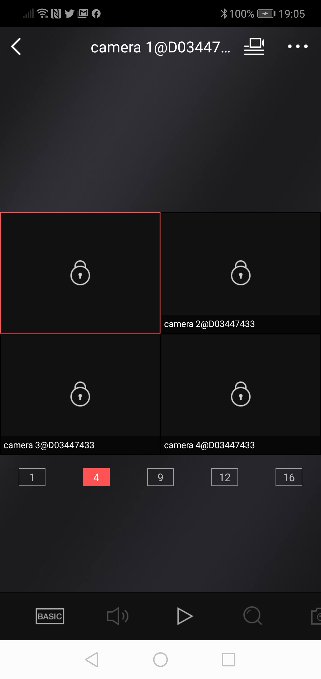

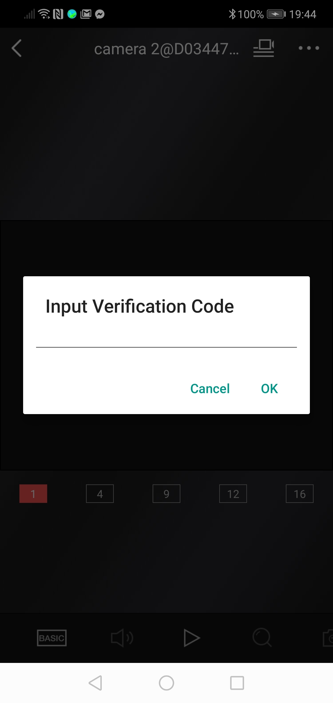

paulpa66 Member Messages 20 Points 3 Oct 31, 2019 #1 On my hik connect just keeps asking for verification code, click ok just keeps giving same message, if i click cancel i get this image attached. Can't see how to put in verification code? Attachments Screenshot_20191031_190534_com.hikvision.hikconnect.jpg 179.6 KB · Views: 170 Screenshot_20191031_194453_com.hikvision.hikconnect.jpg 135.5 KB · Views: 174

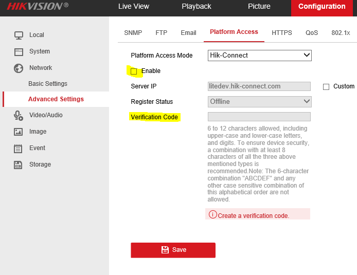

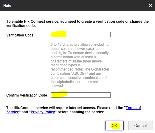

S StewartM Knows a LOT of stuff Trusted Member Messages 518 Points 28 Oct 31, 2019 #2 *Edit - this has been answered in an earlier post. On your camera/NVR check here: Last edited: Oct 31, 2019
