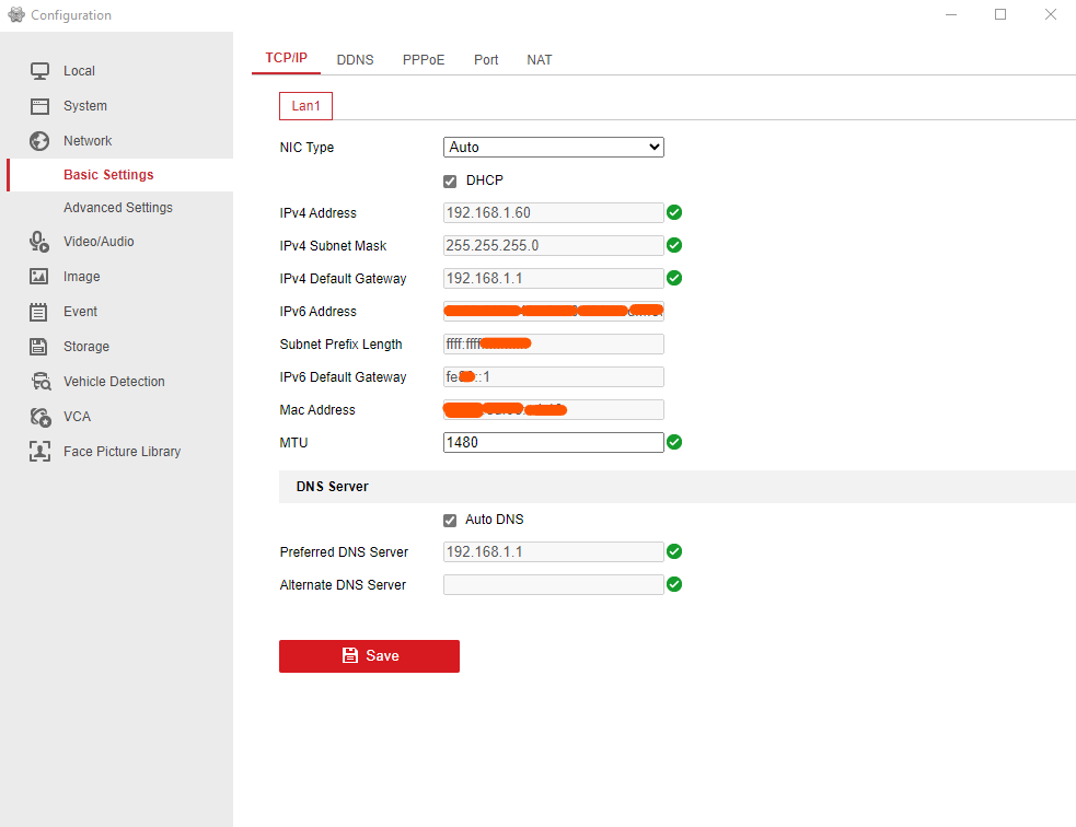

I managed to sort it out. For some reason, my gateway IP had appeared in the DNS address!! Very strange. Set it back to the normal Google 8.8.8.8 and it's working fine. I had an issue with the notifications last week, very strange, I had to delete all events and set them all back up again, now working fine though!
My NVR is using the Gateway IP as primary DNS when in auto. It works OK with that.
By using 8.8.8.8 and 8.8.4.4 it does not connect to litedev.eu.hik-connect.com
I don't know why it is the opposite.
That sounds very odd!!
I don't know if I have to add 8.8.8.8 and 8.8.4.4 also on my router preferred and alternate DNS or I simply have to reboot and wait 15 to 30 minutes as seemed yesterday.
