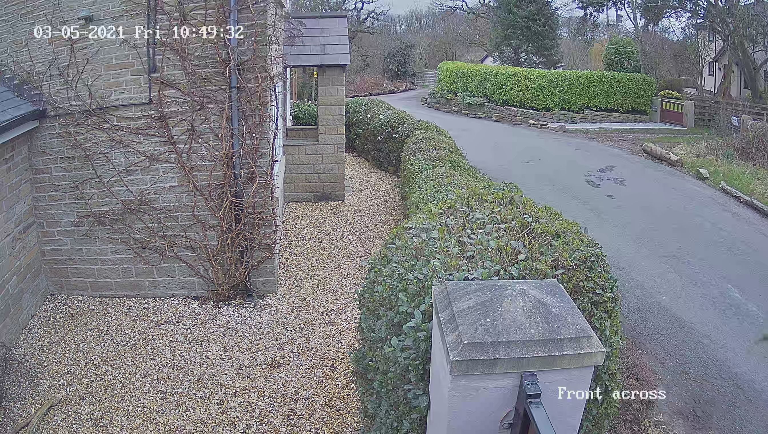

Good point on low light in the area however unfortunately the IR illuminator + camera is preferable given the camera location (see attached).

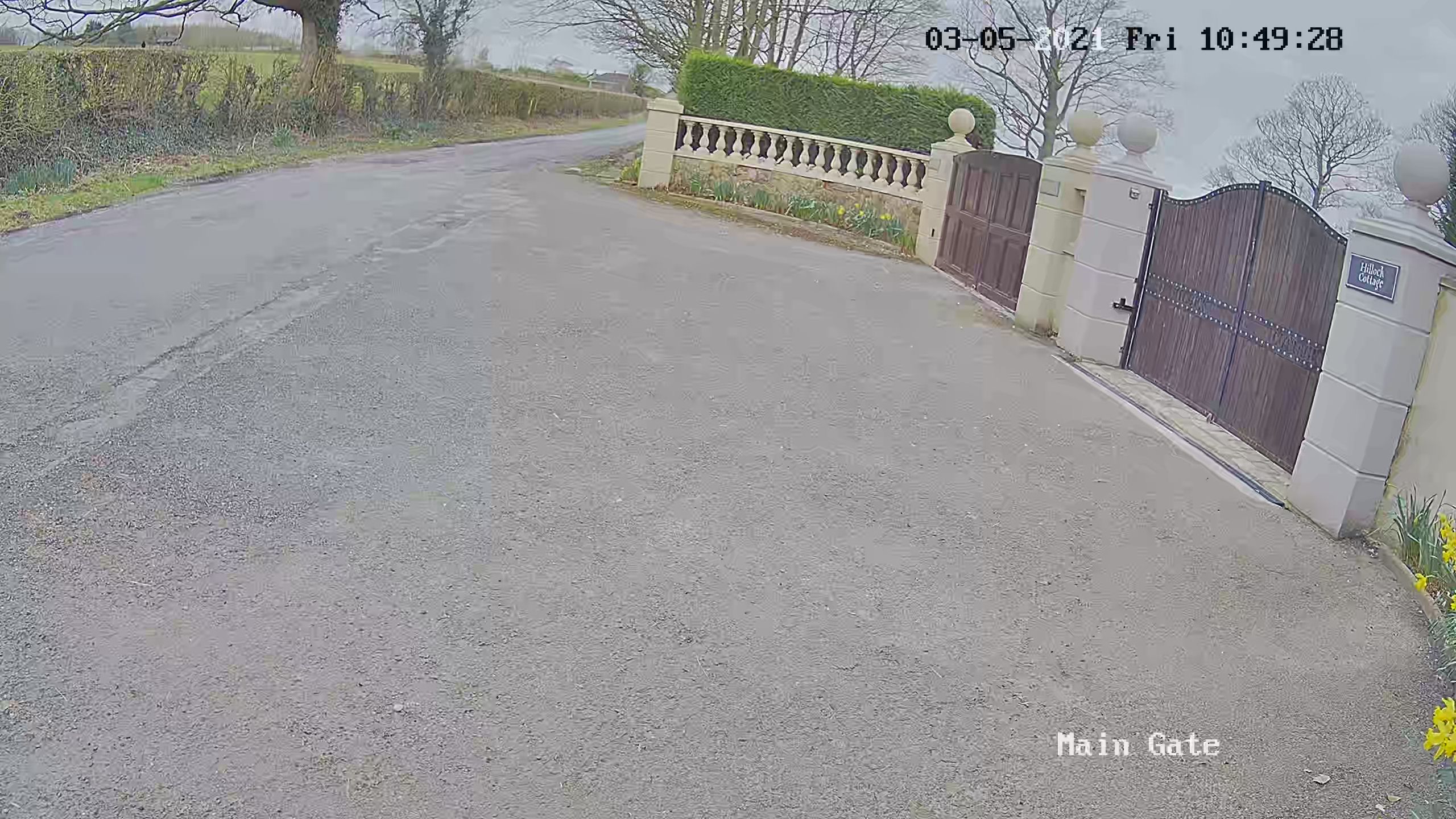

The annoying and interesting thing is that on the camera covering the drive/two gates is a 2163G0 with low-exposure set and at night i can just see the 2nd set of gates to neighbour, whereas on the other camera showing across the house in the opposite direction is a 2346G1 and i can see the far field gate!
Whilst i know the 2346G1 is 50m IR, I'm really disappointed with the supposed 30m on the 2163G0.
My thinking now is 2163G0 augmented with IR Illuminator or replaced with G2 mini-dome (needs to be IK10). @Dan any other options for G2?
And on the 2346g1 to replace with 8mb G2 turret (this is on a pole in a conifer on my property so less vandal access).
