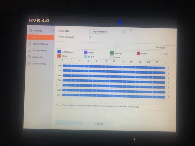

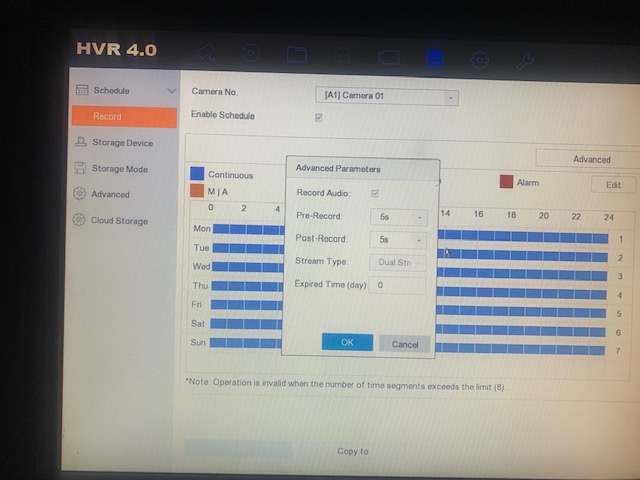

Please see images attached as requested.
I have checked all SATA physical connections as advised and all is fine.
I then shut down the recorder (iDS-7208HUHI-M1-FA-A), but on boot up after selecting the language and entering password the local monitor (connected via VGA) is blank. I cant get past this stage.
Red light is flashing on recorder and beeps on start up.

Thanks - yes, there's a good chance the drive has failed.
Can you send a screenshot of the Storage Device page please (in the left-hand pane of your screenshots), as this should indicate if there's a problem with the drive?
