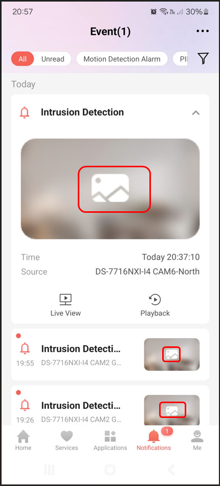

I have a Hikvision NVR 7716NXI V4.62 and various 4mp and 2mp Hikvision cameras, all on their latest versions.
I don't get preview pictures on the Notifications Tab in Hik-Connect - it used to work previously, and I guess it also had been earlier firmware versions, but now there are none shown.
Live view and Playback work fine, and in Search on the NVR, the event pictures are there.

What are the model numbers of your cameras please @RandMental?
Also, which version of Hik-Connect are you using and on what phone?
Have you got stream encryption enabled on your NVR?

NVR: DS7716NXI-I4/S (C) Firmware version V4.62.255 Build 240123
Android OS 14, Samsung S21, Hik-Connect V6.2.18
Apple IOS17.4 iPhone 14 Pro , Hik-Connect 6.2.3.240226.3
Cameras : Mostly Hikvision Colorvue G1 and G2 eg. DS-2CD2T47G2-L and DS02CD2T46G1

Thanks, we've seen a similar issue with the M-Series NVRs which appeared when the new firmware was released and didn't work properly with the G5 platform camera firmware.
Can you please log into each camera and list the firmware version installed on each so I can check there are definitely no new updates for them?
Also, can you check if you have stream encryption enabled in Network>Advanced Settings>Platform Access, and test with it disabled if you do, please?

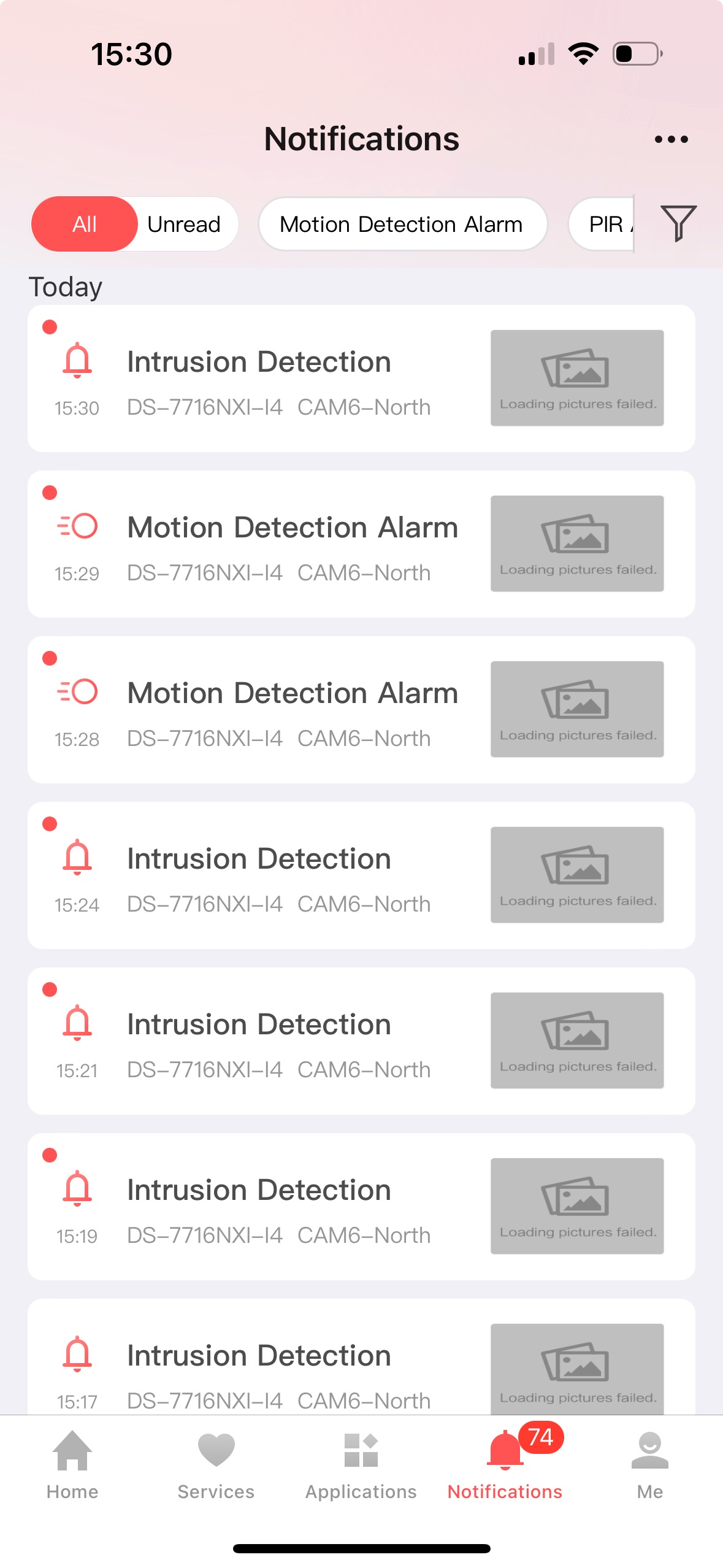

We found that the thumbnails were only broken for certain events on the other NVRs - are you only seeing them broken for intrusion detection, or all events please?
I also found that tweaking some video settings for the Main and Main (event) streams on the NVR's video settings helped to get some working.
As a test, does reducing the maximum bitrate and/or video quality for these streams help?
Also, are you seeing the broken thumbnails on all cameras, and are your cameras directly connected to the NVR, or connected to a separate POE switch?
I have only Intrusion and line Crossing Detection enabled on all cameras, 3 has the NVR do the analysis, the others are on the Cameras.
All of them fails to display.
I'll check the basic events on one camera
As you can see on this iPhone 14 Pro screen dump , the thumbnails also don't show for a standard motion detection

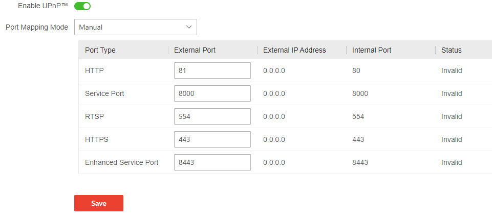

Some thing I also now realised and tested, the UPNP on the Cameras works fine with my OPNSense Router/Firewall, however the NVR's UPNP tab keeps showing invalid.
On the cameras I needed to reboot to get valid UPNP setting, on the NVR did make no difference .
NVR DDNS page is attached.
