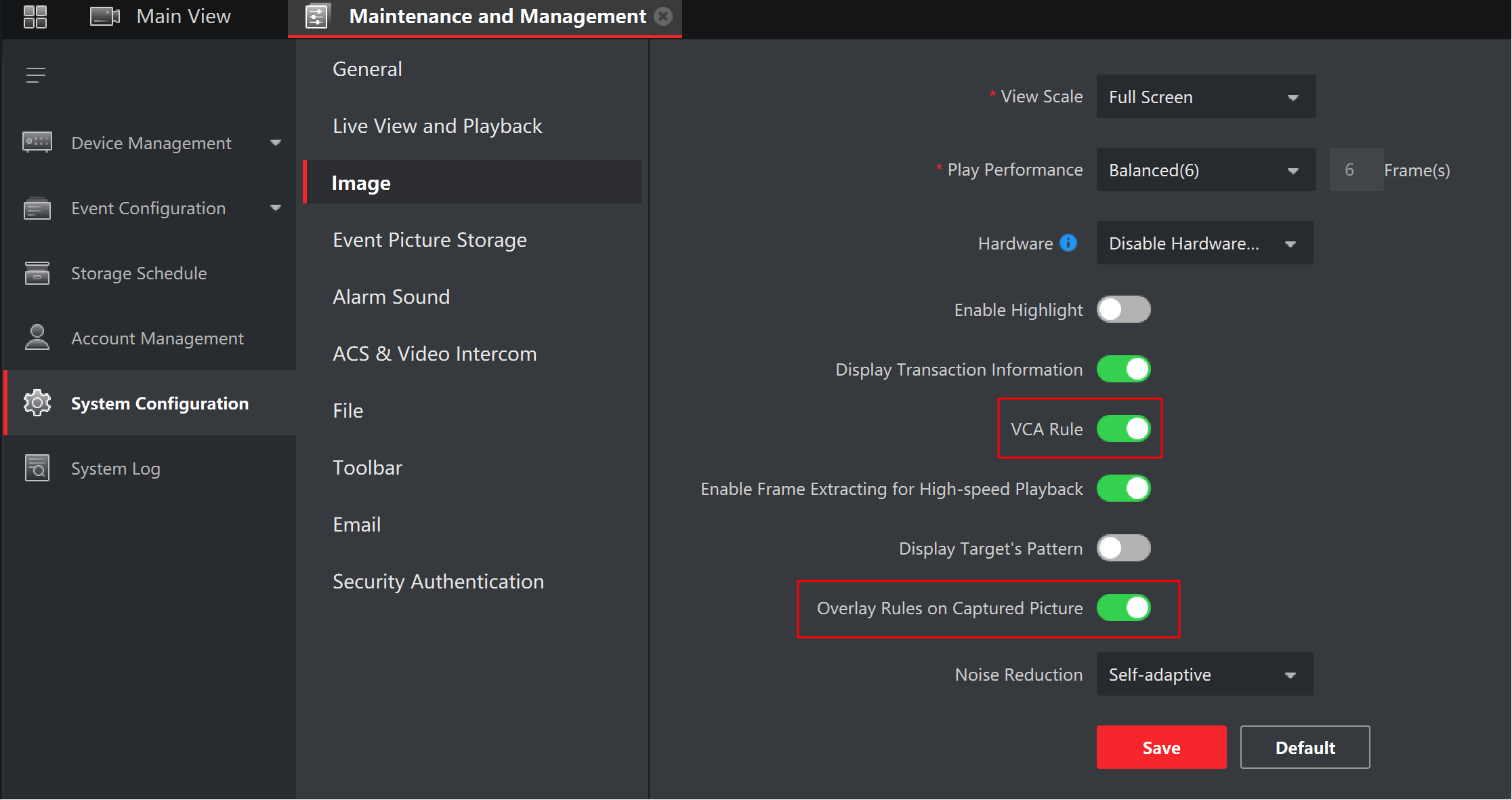

On iVMS-4200, you need to go to System Configuration>Image and make sure that both VCA Rule and Overlay Rules on Captured Picture are turned on:

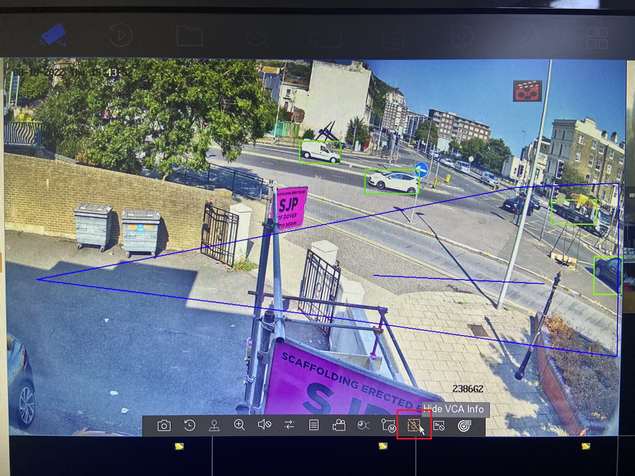

When viewing on the NVR's local interface, you should see a toolbar appear when you hover over the camera streams in live view and playback - you just need to click on the Show / Hide VCA Info button on this:

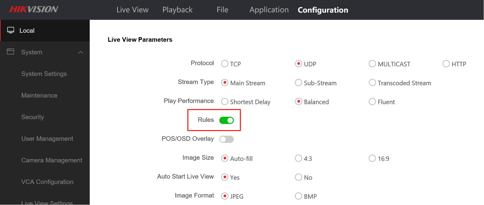

If you are using a web browser, then you will need to use Internet Explorer initially to enable the rules.
When you connect to the NVR in IE you should see a Local menu under Configuration - this is where you enable the rules:

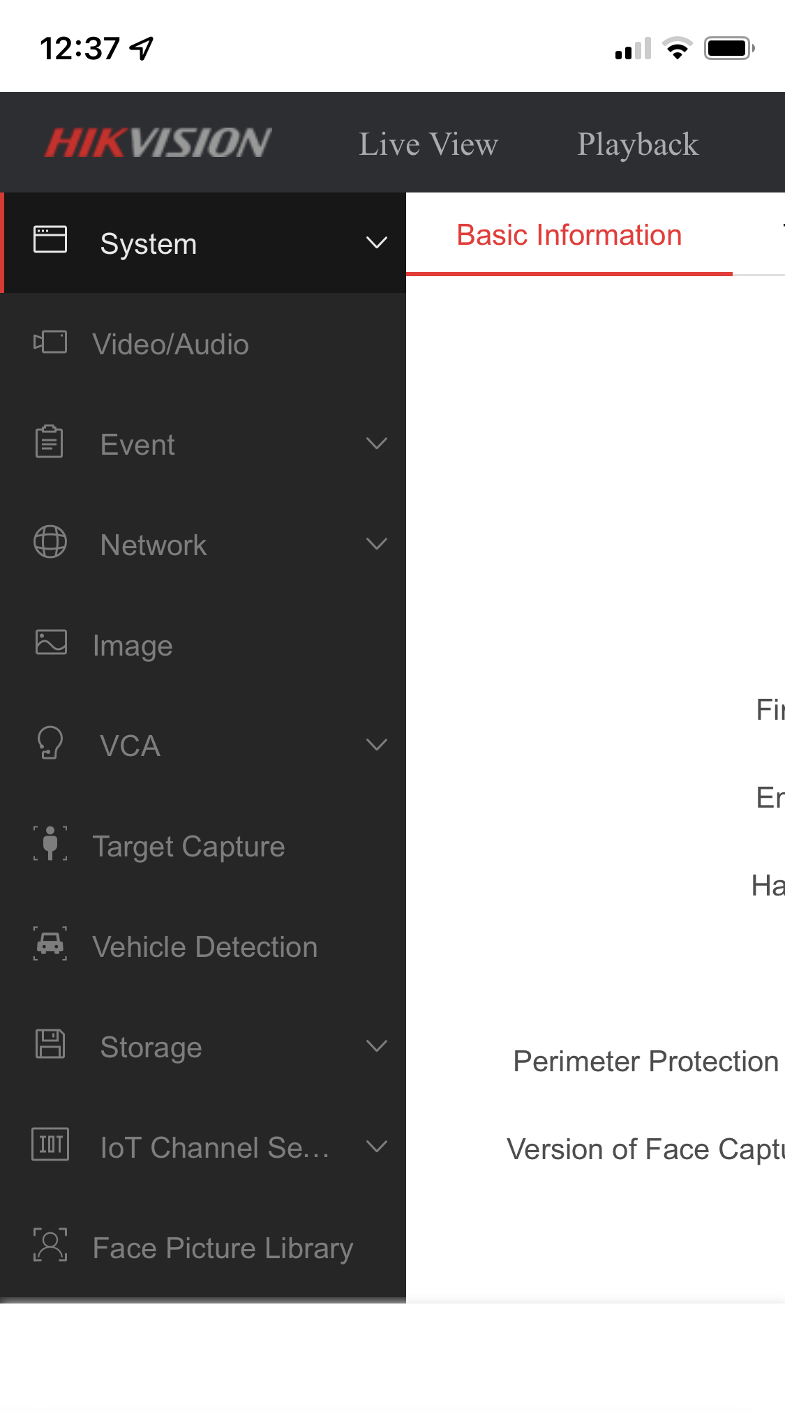

Actually I have not have a local option when I log in from web browser
