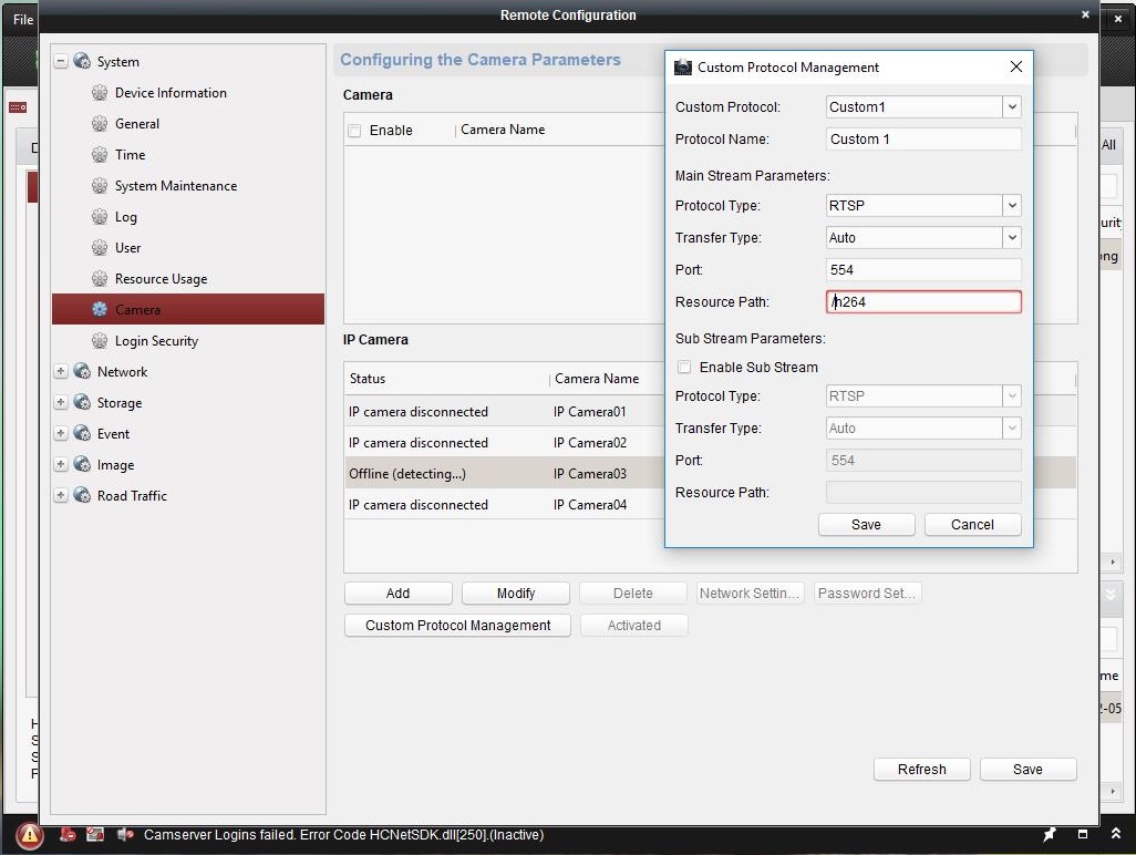

If I set the camera as a custom one, using either if the 2 known rtsp streams that work with iSpyconnect I get an 'The network unreachable' error.

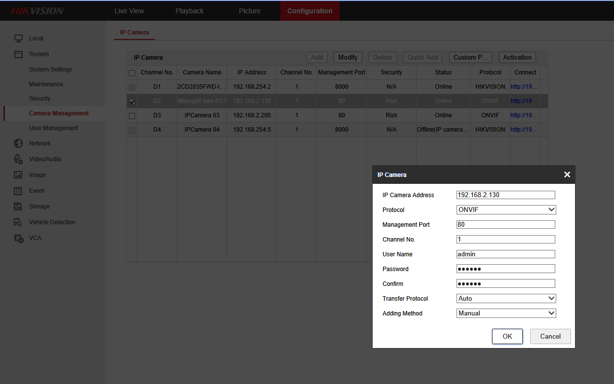

Have you tried manually adding the cameras in the NVR's Camera Management section using ONVIF?
Or via a direct-connected monitor:

I've tried the ONVIF option, and get an 'unknown error'. The cameras are sold as PSIA compatible.
I can't complete the custom adding section as it tells me 'no more cameras allowed'..........

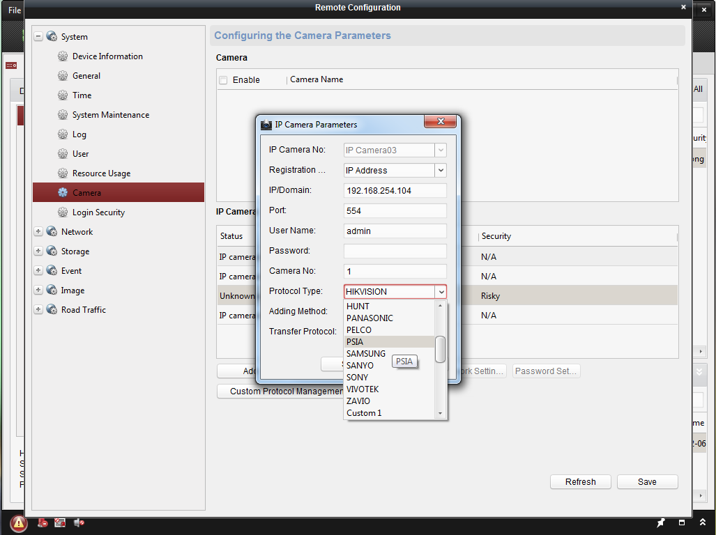

PSIA is an option on all but the very latest version of software for the K1 series.

I can't help but think it's the format of the rtsp stream that's wrong, or i'm inputting the wrong or incomplete information in the custom camera fields.
Try a firmware version where PSIA is an option and set it up as per my browser access screenshot of Camera Management above.
(switching ONVIF in my example for PSIA in your case)

Currently cycling through various rtsp steams, all of which are giving me network unreachable errors.....sigh..
