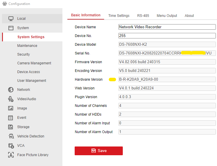

This is my DS-7608NXI-K2 but as you can see this a B-R-K20A9_K20A9-00
I don't know what this means and if yours is a newer model.
The firmware is an NXI-K2 but it is a different date than the one on the ftp server.
I also believe that an Accusense K firmware size should be more than 150MB although they have placed a 61.50 MB as Accusense in the folder of 4.73. This firmware should be for a non Accusense K. I never installed a small size firmware.
You can also try one of the latest ones which are more than 150MB
