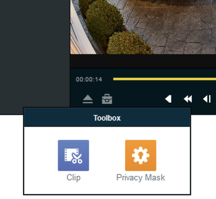

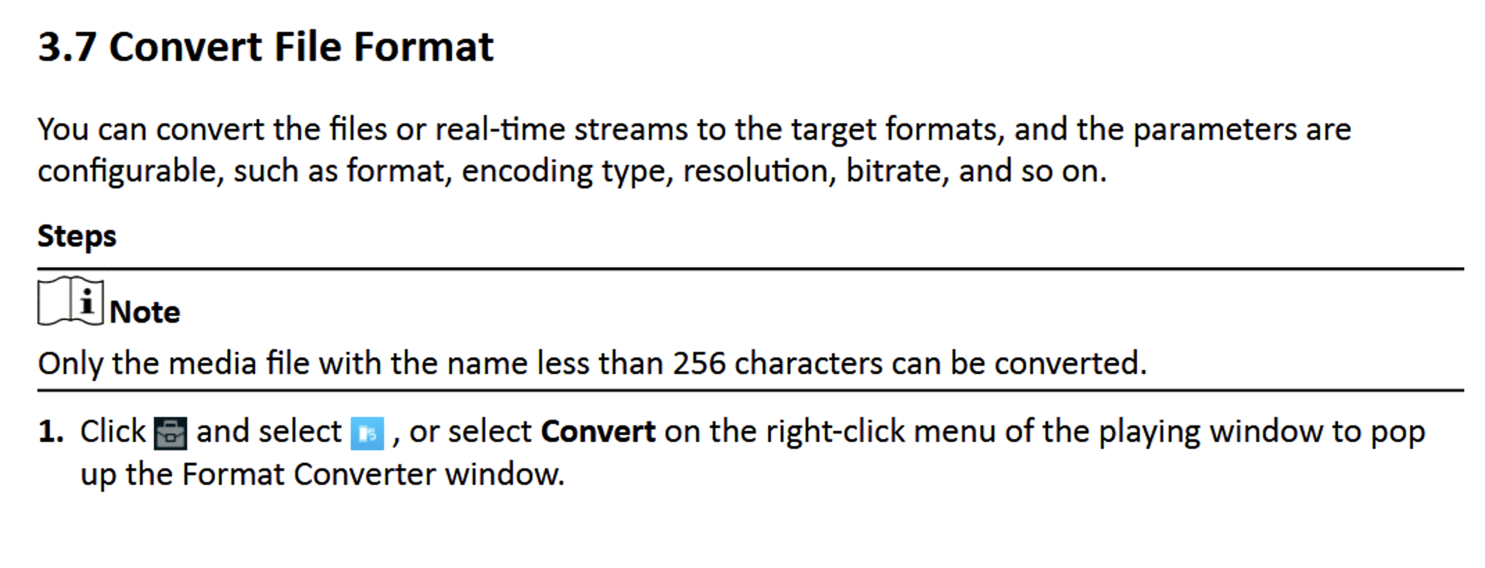

Hi @Dan - I've rarely bothered with VS Player. However I've just exported a clip from one of my cameras with audio. It plays fine in VS player. However regarding the ability to convert the file from within VS Player, the instructions from within the app show the following:
When you click that first icon there are only two options and neither are the one shown from the instructions:

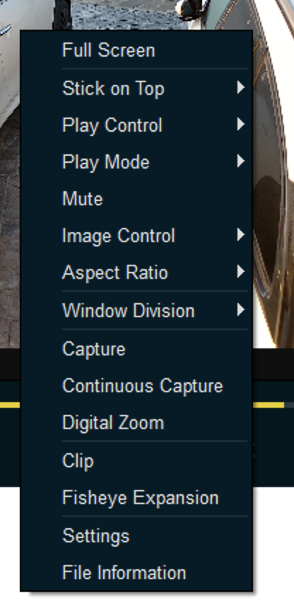

And 'Convert' is not an option in the right click menu:
Is it actually possible to convert a file using VS Player or just Hikvision myth? I must be missing something simple. My VS Player was one version out of date but I've updated it and it's the same with the latest version. I recall a year or so ago having issues getting the audio into another format when there was an accident outside my home I needed to provide footage for.
I didn't realise, but both versions 7.4.4.5 (x64) and 7.4.4.8 (x86) are available to download on different Hikvision pages.
7.4.4.5 does not have any convert option, but 7.4.4.8 does - I've just tested both.
(This is on Windows only.)
I've tried Handbrake too, but like VLC, this does not recognise the audio.
You could try setting the audio encoding on the camera as AAC or MP3, which looks to be supported, but I'm not confident that this will work either (I haven't had a chance to properly test it yet, sorry).
EDIT - for some reason, the link above for v7.4.4.8 actually downloads v7.4.4.5 (I'll ask Hikvision about this), please download v7.4.4.8 here.
