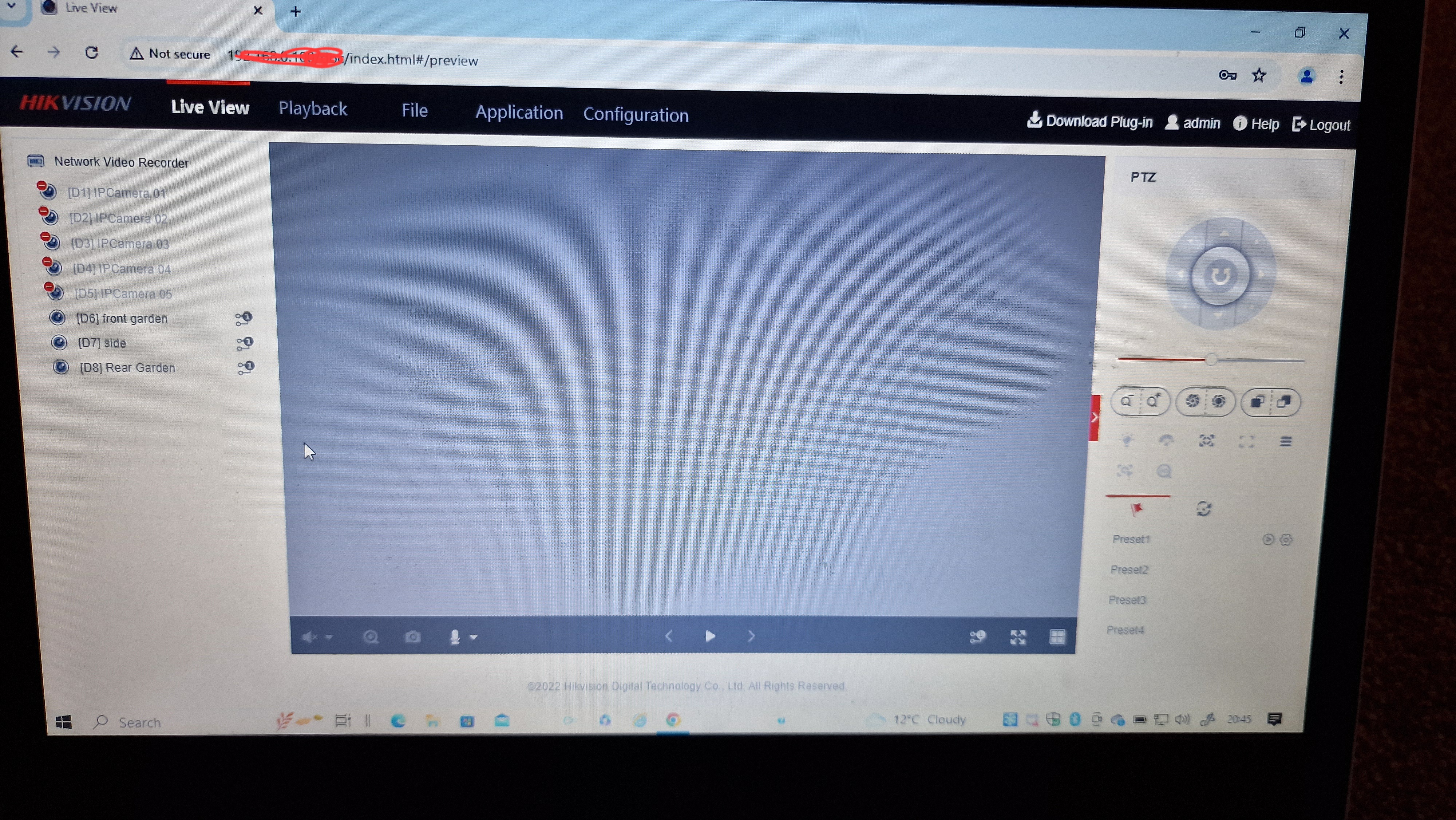

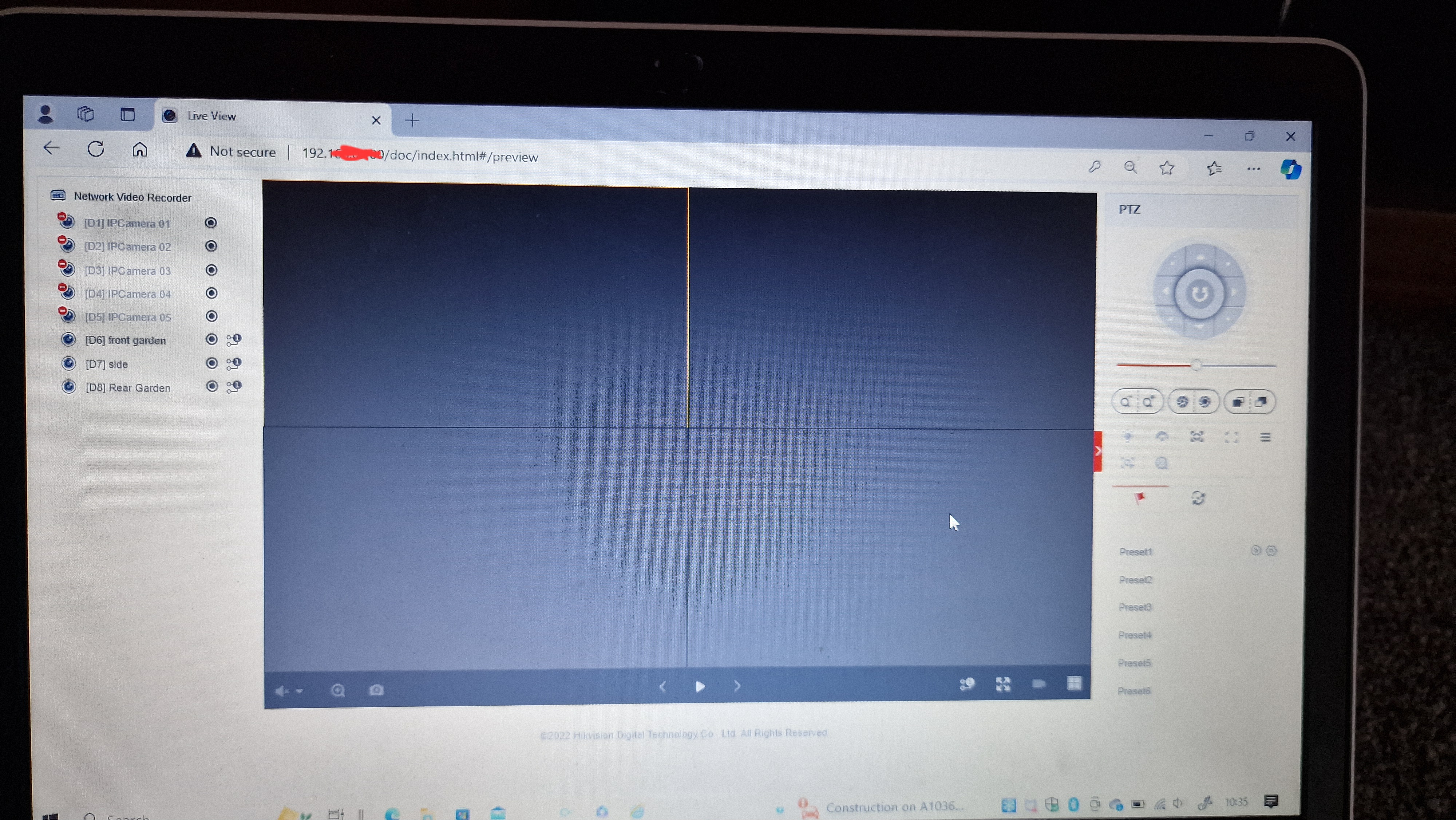

Back in April 2022 I updated the firmware on my NVR ds 7608ni 8p and started to get errors when trying to live view via hik connect. I solved the issue at the time by rolling back the update. However, I still get issues with playback not loading at times and getting stuck at 81% etc. This happens loads at the moment and I get the no more connections error after trying for a while. A right PITA.
In this time to now, has any update fixed any of these issues. My hik connect was updated in the September 27th 2024 release. My nvr is still on the 2022 pre april update due to those green screen issues back them. Did these ever get fixed?

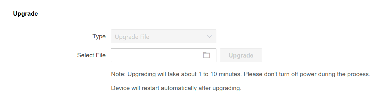

It sounds like you're trying to load the firmware file into "Device Parameter" section - upgrading the firmware shouldn't ask you for a password.
Are you definitely trying to import the firmware file into the section shown below?
Make sure that you're extracting the digicap.dav file from the zip folder too.
If it still doesn't work, try using the Batch Config tool for the upgrade:

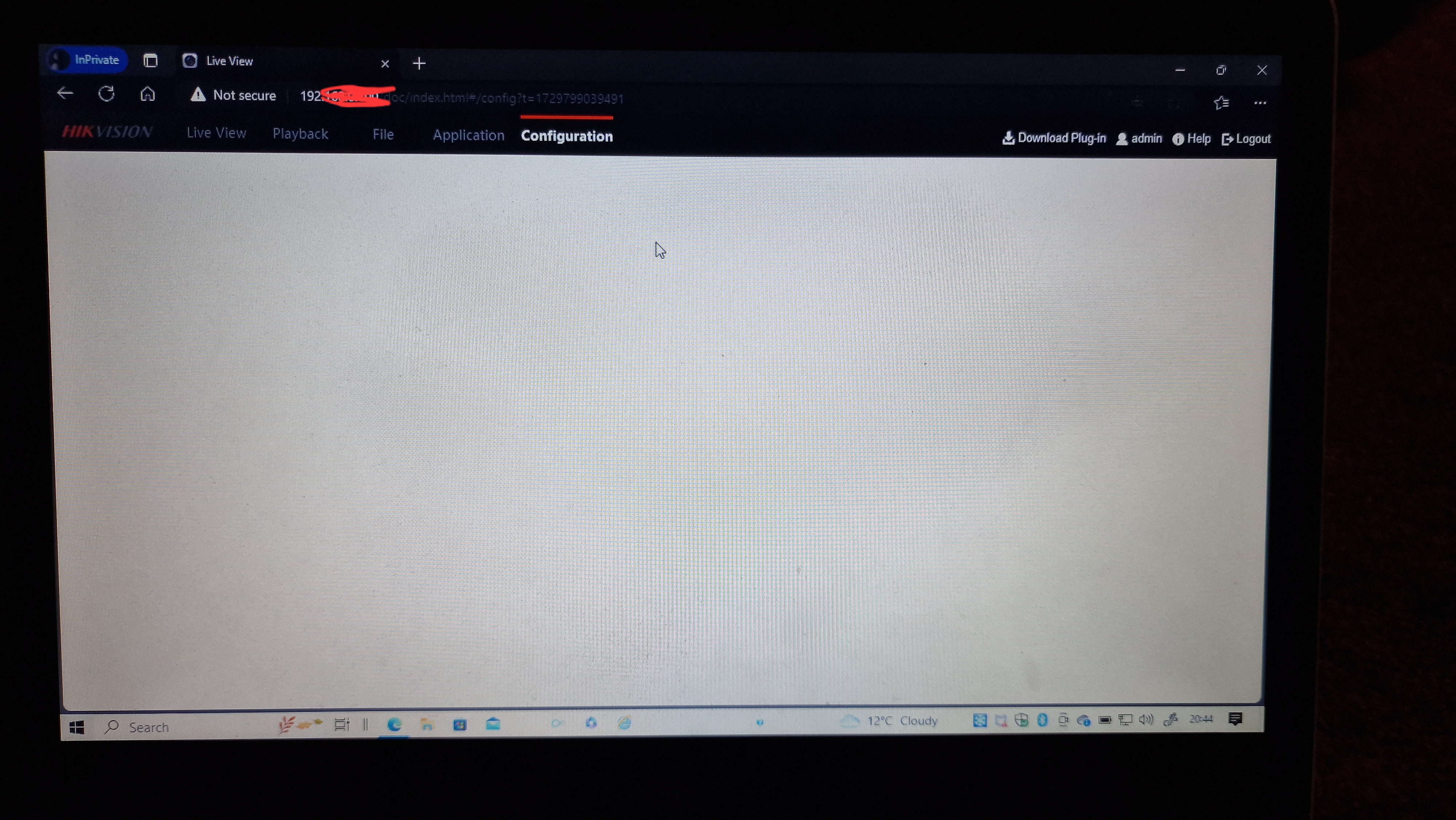

Done it. Updated it and had to clear cache as you said. But now when I log in to the Web page as soon as I press configuration button the screen goes white. It happens on chrome and edge. In fact on edge when I open the nvr page it doesn't even have the bar with the configuration button on it.
Which firmware version did you get to?
Try clearing your cookies and cache again (Edge is probably best).
Failing that, try Edge in IE mode until you get updated to the latest, or use the Batch Config tool linked in my post #10 (which doesn't need browser access or plugins to do firmware updates).

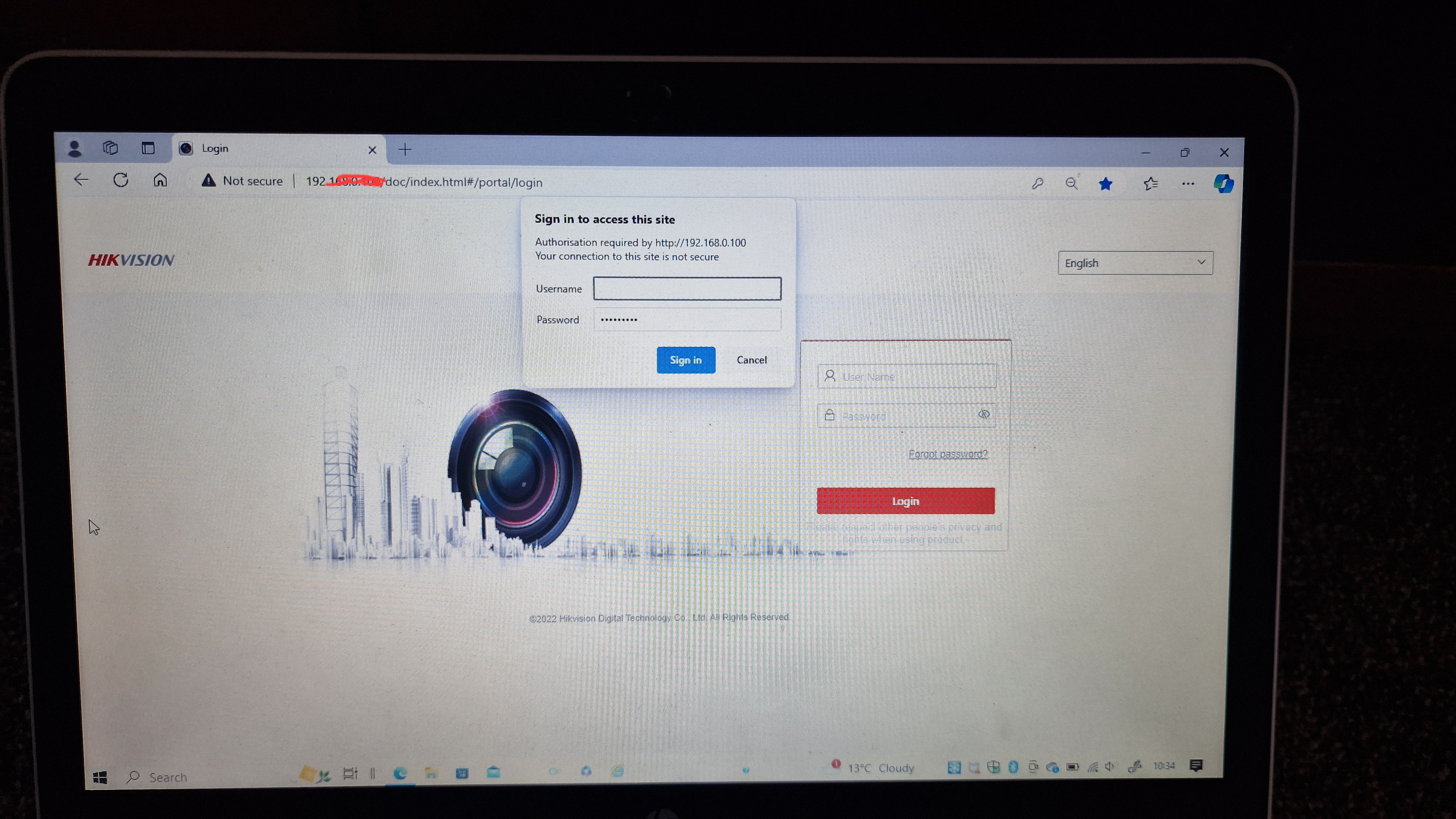

Is batch best then? I do get a pop up window now on the log in page asking for the log in and password before doing it on the page. Then another pop up on the nvr page says change password.
In the nvr it's self it does say 2 illegal log ins yesterday. I think I caused that by mistake logging in.
