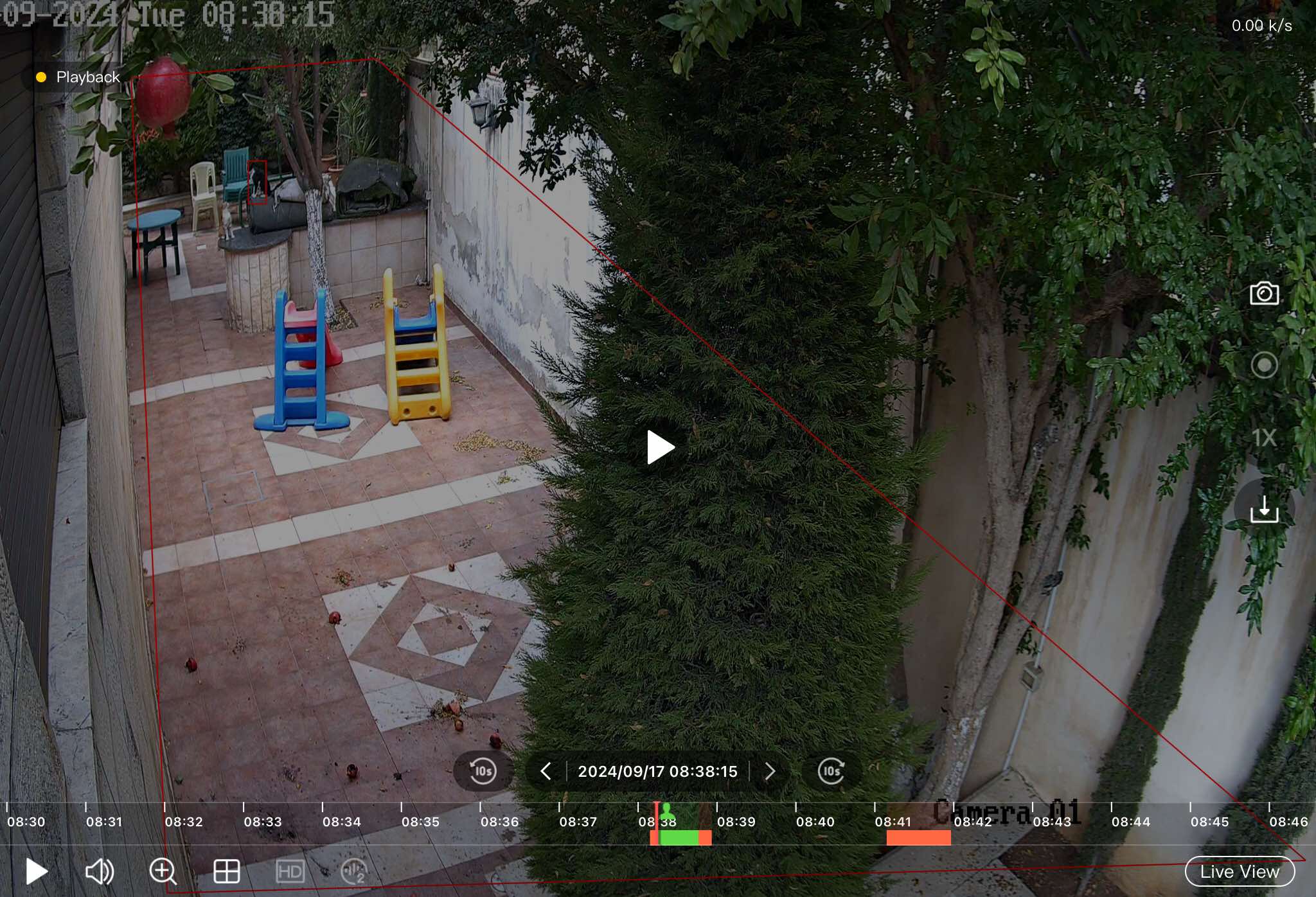

Getting false event alarm Every day i get false event alarm this happens when only " black street cats " pass
Any advice how to solve it .

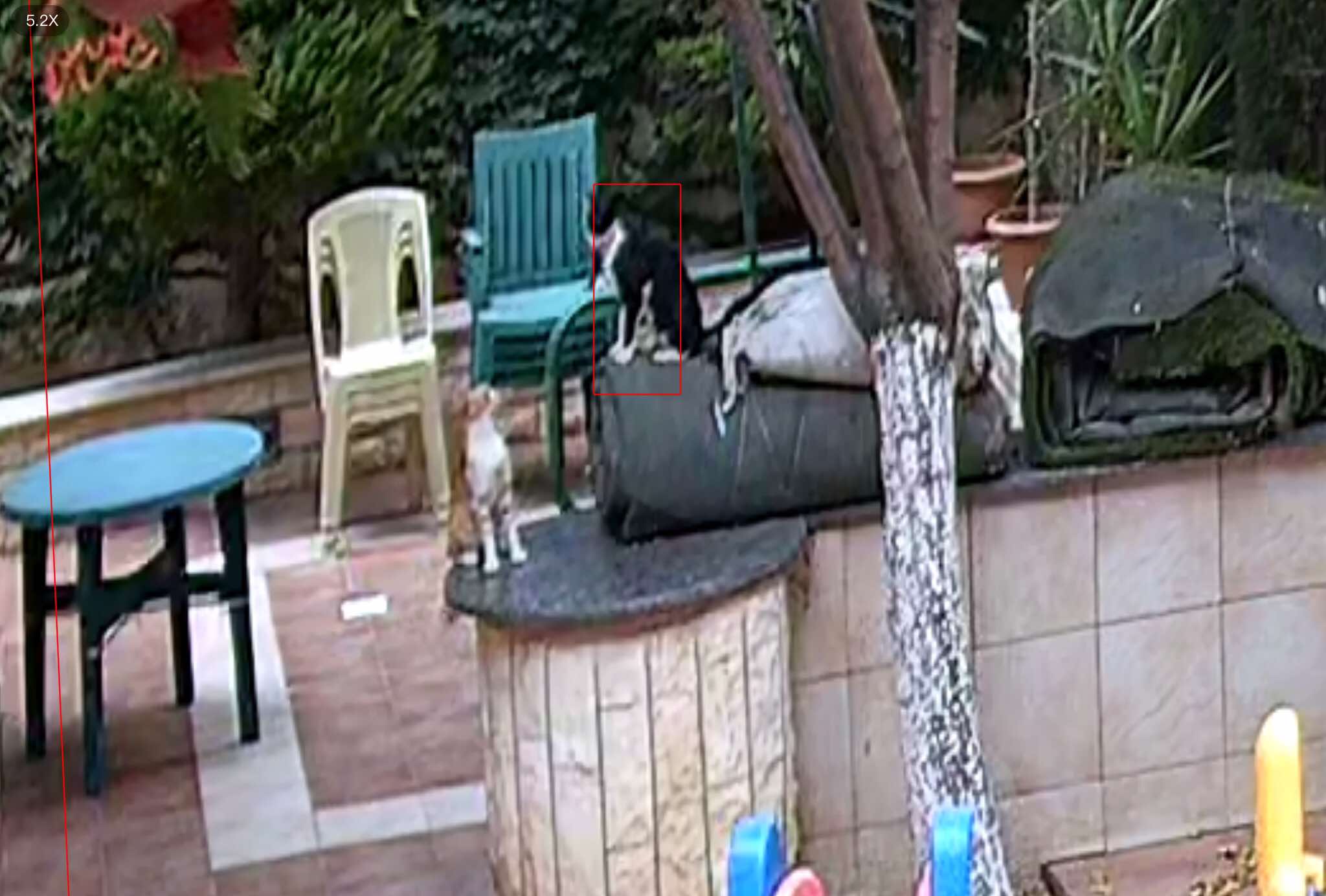

Thx for help
But iam Surprised WHY the black cat color only Trigger alarm

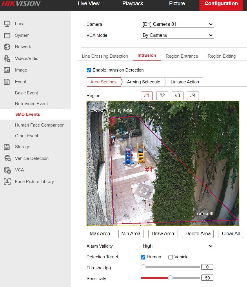

any way this is my settings
We don't know exactly how the 'Human' filtering algorithm works exactly. I suspect it just sees an upright group of pixels moving in a uniform direction and makes the decision based on that. It could be that the higher contrast between the black cat and background makes the trigger more likely. Start by setting those Minimum and Maximum areas. Minimum wants to be set smaller than a human at the far point of your intrusion zone, while maximum should be larger than a human at the near point beneath the camera. And as stated if you're on the newest firmware for your camera you may have those additional settings I mentioned (False Alarm Filtering)
Where are your Min/Max values? Make the minimum value bigger than the cat, and Max value bigger than Human.

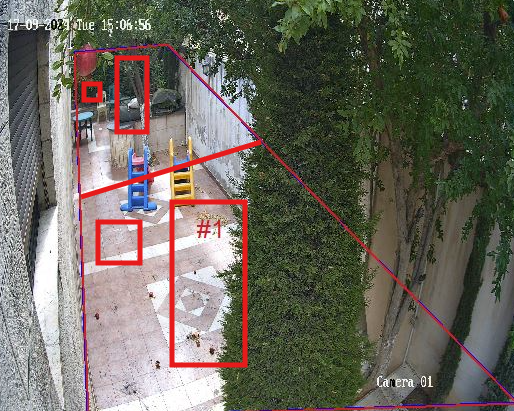

Also i would split this region into 2regions, and set up 2x minimum values and 2x maximum values, because cat will become biger the closer is to camera, and smaller the further away it is.
Something like this:
