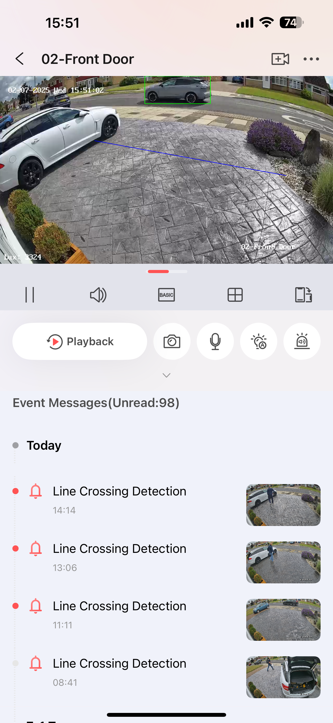

The blue lines from the line crossings I have set up don’t appear on HikConnect or the green/red box around people, I have 3x G2H and they are all fine but this G3 doesn’t show up, it still triggers a notification etc but I like to see the lines and what is triggering the event.
And it’s the alarm from the speaker, it works as in if someone triggers it but by the time they have gotten past where the camera is it then goes off , I have it set to our driveway but not the very edge as when people walk past with dogs etc it keeps going off , so I set it back a bit but now it’s like there is a few seconds delay with the event being triggered and the alarm going off.
It works on mine so long as I have 'Display VCA Rule' enabled in 'Me' > 'Settings'. The camera below is one of my two DS-2CD2347G3-LIS2U/SL's. It's set for line crossing - Human and Vehicle. As you can see the line is shown and a passing car is highlighted so it's not a bug:
Do you have Dual VCA turned on for the camera? If not try with that turned on.

Yeah I have it set for dual VCA mate so I don’t have a clue what else to try , I’ve reset nvr and camera , reinstalled HikConnect etc lol.

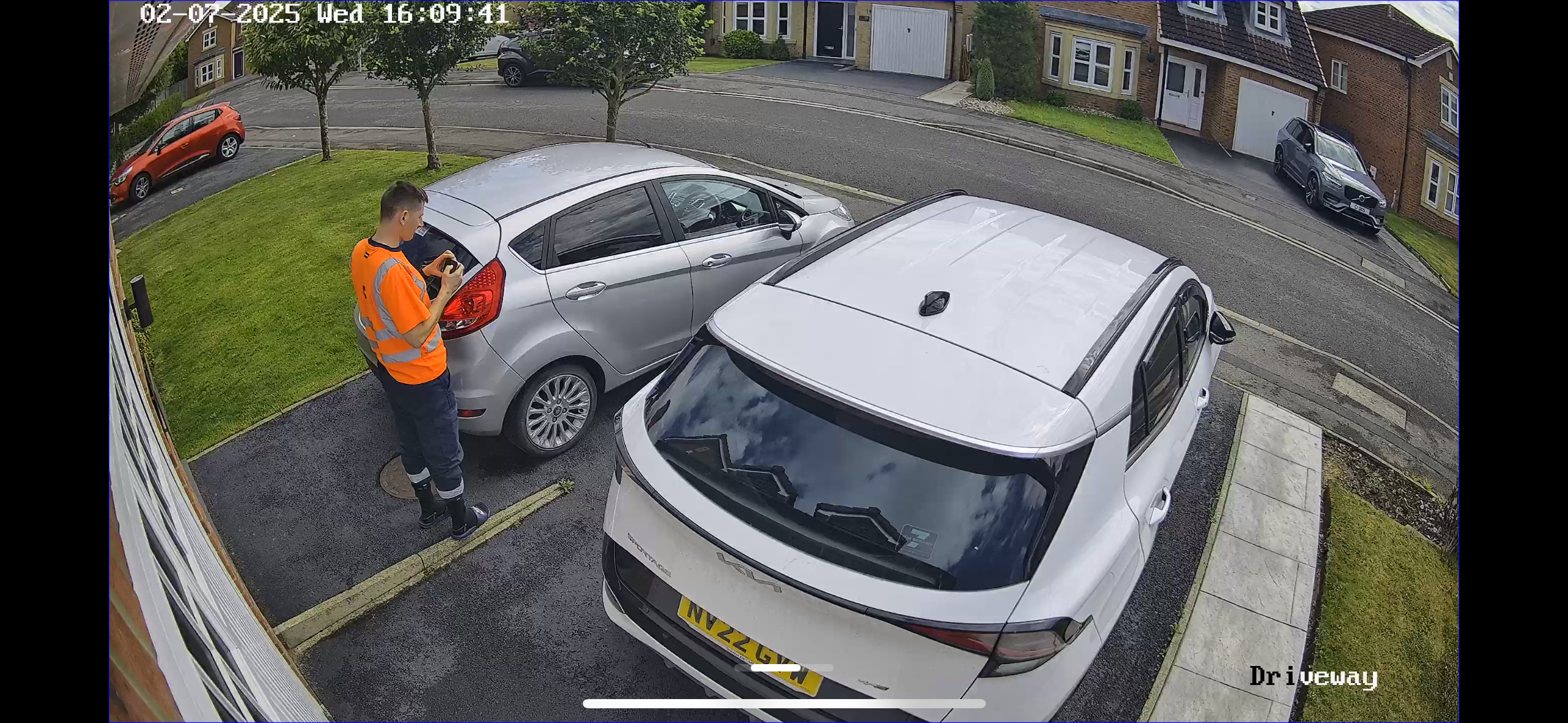

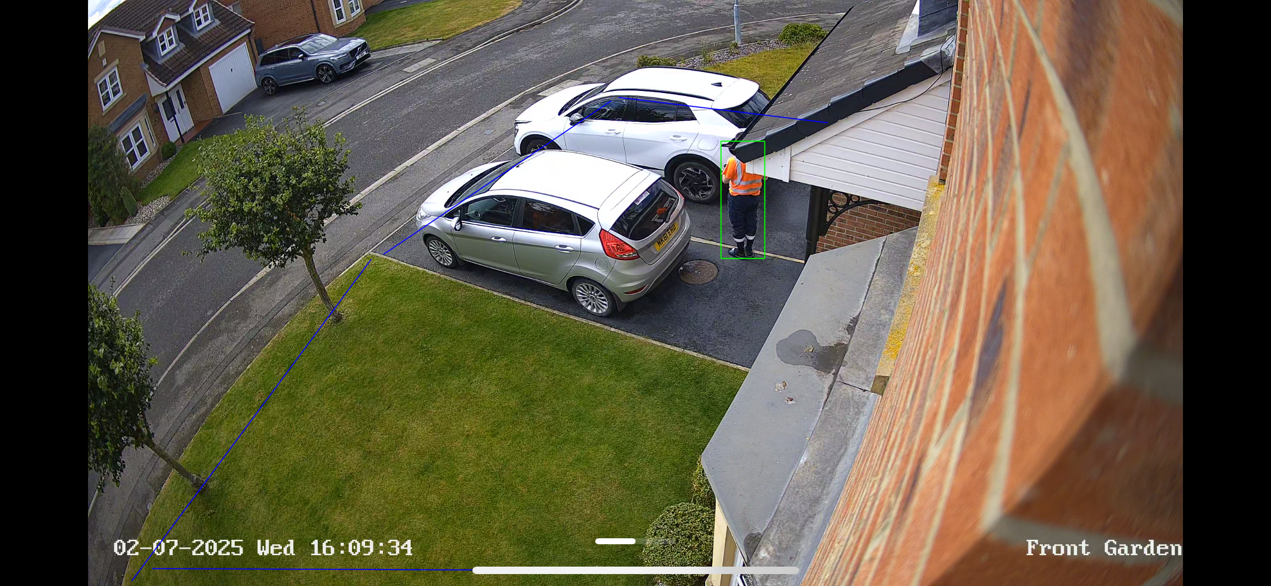

Here is some pics I just took from the 2 different cameras.
And yeah it can be annoying I’m gonna adjust the line tonight as people walk past trigger it lol , thankfully I don’t have it set to 100 volume .
On the second camera there's a full screen outline in blue. Do you have intrusion enabled on that camera?
Ignore that I just added an intrusion area to mine while live viewing in Hik Connect and it appeared as soon as I hit save.
No mate I only have SMD>Line crossing enabled (I’ll double check them all tonight) it’s been like that ever since I installed it , but before I reset the nvr/camera etc if I switched the view from HD to basic it would then show up the blue lines lol
Strange mine is showing on both Basic and HD. I'll have a mess around to see if I can screw it up and lose it.
