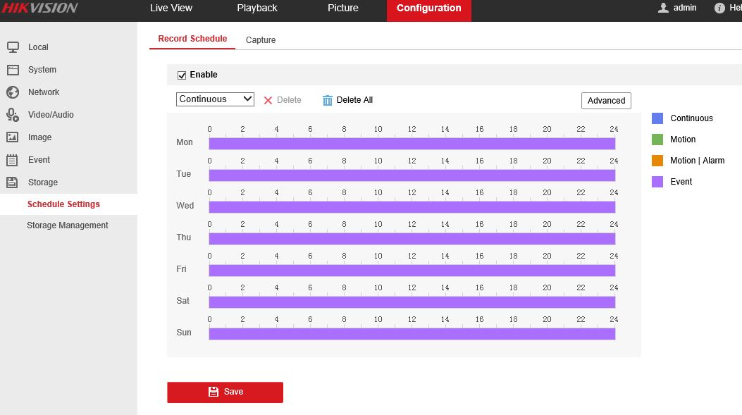

But since then, I connected directly to the camera via connecting to the NVR using IE - and System - Camera Management - Connect and selecting the camera, and then when looking at Storage Settings in the camera - it was set to Continuous but all the bars\periods for all 7 days were coloured purple, i.e. set to Event.
I deleted them all and recreated all 7x24 periods in blue and hit save. I'll be checking tomorrow afternoon to see how it's behaved over 24hrs and to see if the missing footage\gaps behaviour still happens.
I was hoping someone could tell me what happens if the Schedule settings in the NVR are set to continuous (and blue) and the ones in a camera are set to continuous but purple (event)? Would this cause there to be gaps in recorded footage?

Looking at the NVR & Camera Record Schedules - it's back to being Continuous (Continuous - Blue) in the NVR and Continuous (Event - Purple) in the Camera.
NVR:
Camera:
