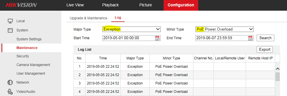

Check the logs on the NVR. Any PoE Overload entries around when the cameras rebooted?

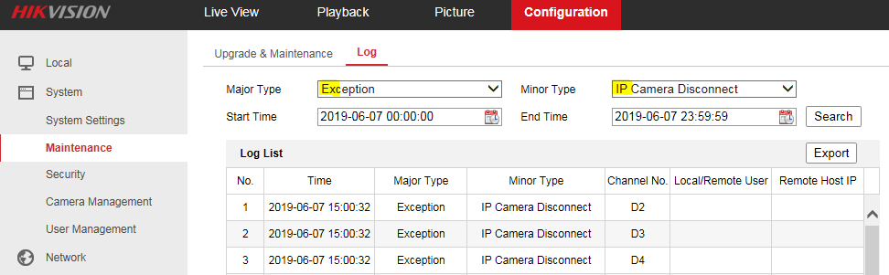

I am seeing a PoE power supply exception every hour.
The IP camera disconnects (with one exception (10 minutes ago), which were occurring in the log at 10 to 20 a day have stopped, coinciding with applying the .005 patch to v4.21 NVR software.
I will check again tonight when IR turns on, but PoE consumption is 18W with 102W available.
The only other anomaly I have noticed is that D2 camera, the feed for which is delivered via Devolo Ethernet over Power adapters is that it is showing as "port short circuit". If I disable PoE bonding on this camera then the camera goes off line. It is as if PoE bonding rather than just disabling PoE, is actually disabling the camera.
