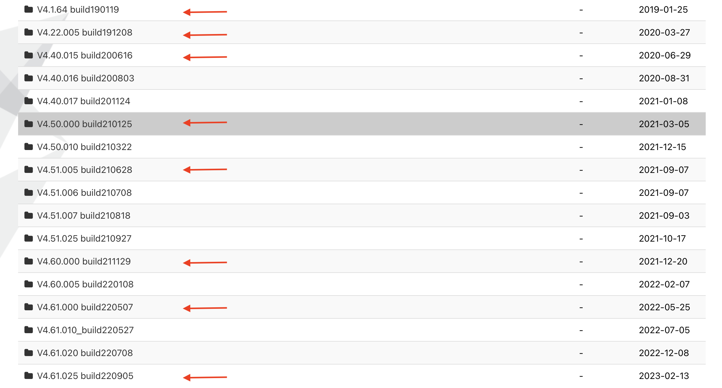

I am in the USA and have a DS-7716NI-1416P Build V4.1.70 181227
Where can I get USA firmware or is the EU ok to use?
Would I start at firmware... V4.22.005 build191208
I am afraid to brick my NVR
It's a question that's come up on here a number of times. It's not clear whether there are any differences between the versions. I think you should be fine as there are other US users on this site that use the firmware. I often use the Hikvision global site for firmware rather than the UK one. If you're on 4.1.70_181227 currently, you'd be advised to step through the following versions indicated on the image below. As a precaution be sure to delete browser history after each update.
What's a bit strange is your current version of 4.1.70 isn't in the list and 4.1.63 in the list, an earlier revision, has a later build date of Jan 11th 2019. Unfortunately as this is a UK forum, there's no-one who can confirm 100% whether you're ok using UK/EU firmware and it would be at you own risk.

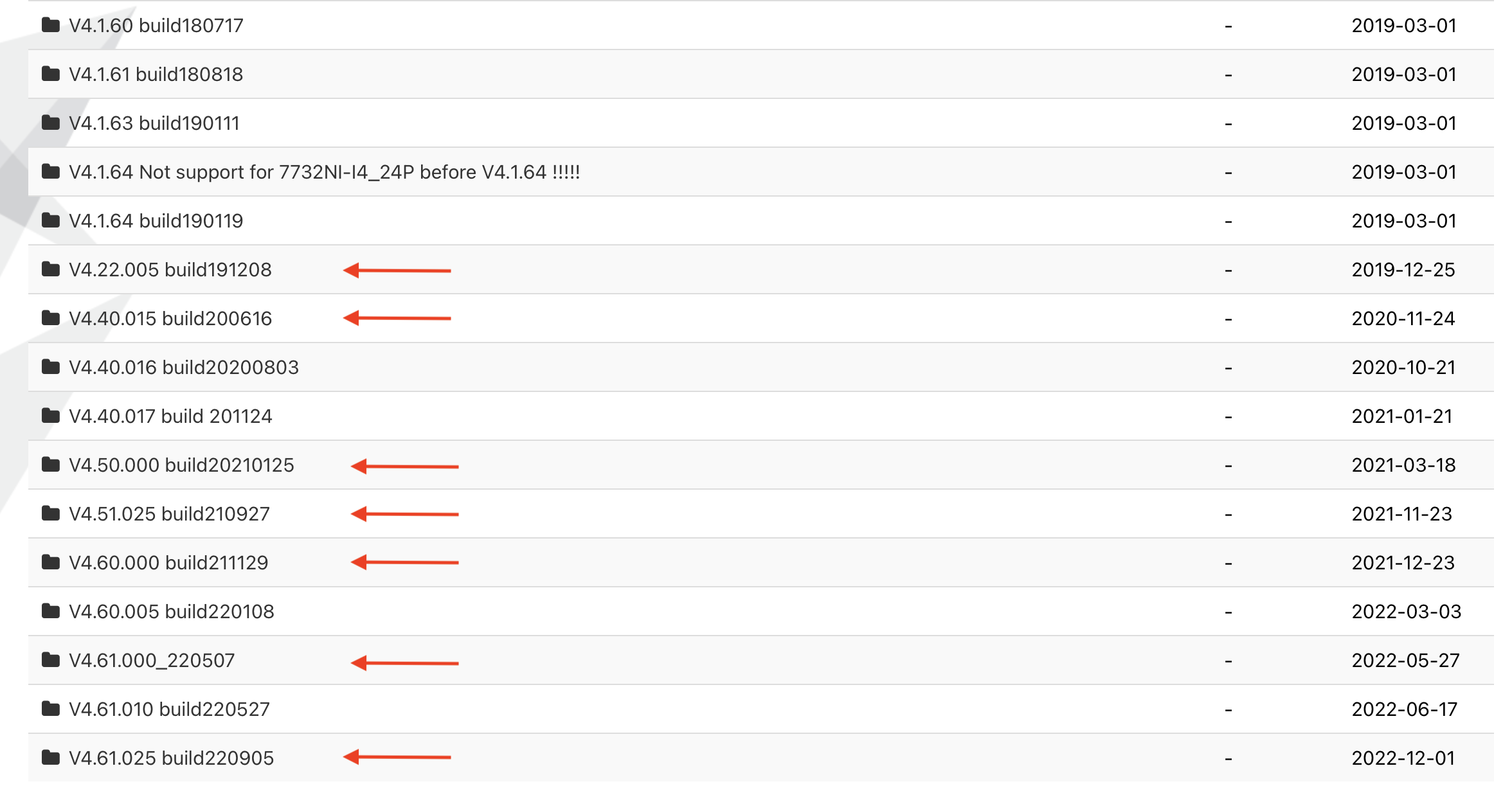

Thank you, I hope I don't brick the NVR. I found this site.
I don't know how to do screen shot but I saved as a PDF
  • Video recorders _ Hikvision US _ The world’s largest video surveillance manufacturer.pdf
Well looking at that one of those 4.60.005 versions shown in your linked page has the same build date (220108) as the one EU portal so they're likely the same.
