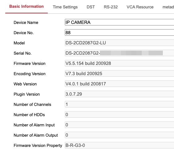

The first thing for the cameras.....They are G2 model but could either use G3 or G5 platform firmware - it's not something that's obvious. Log into the camera via web browser and you'll see in System Settings > Basic Information "Hardware Version Property" at the bottom. You can see in the image below that this particular camera is a G5:

Edit: It appears based on the existing firmware build (but check to be sure) that your cameras are G3. You will be able to jump straight to the latest version on them (V5.5.800 build 210628). There are two versions - just use the one ending "STD"

Right thanks for that. The cameras do indeed look to be G3 models:

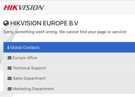

The first stumbling block is that I can't access any of the links you posted, in fact even if I try to get to the portal directly I get the same problem. So far I've tried 3 browsers on the Mac all with the same result.
Yeah for updates, it's advised to step through versions where that middle number changes. It's also helpful to clear your browser history after each update, as sometimes directories change in the camera firmware that can result in anomalies in display. Your G3 camera is currently on 5.5.154 and the latest version is 5.5.800, so there's no need to step through another version.

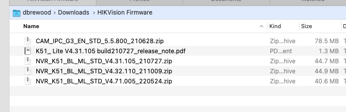

But even if I copy / paste it directly, I still get the error..... Now tried it with VPN on / off, AdGuard on / off, and in Brave, Safari, and Edge. Ah ha Edge with all extensions disabled works!!
So it looks like I need to apply the following?
This is getting scarily real now........

When I click the linking your message it goes directly to the correct page so I don't know what the issue is there - I only use Safari, I regularly link those pages.
Those are the files. You will need to unzip them (when I download with Safari it automatically does that). Only unzip the one you're working with as everything has the same name when unzipped (digicap.dav) or you can rename them so you know what they are - G3.dav, 4.31.dav, 4.32.dav, 4.71.dav
If I'm keeping files I'll unzip, then rename - "G3_5.5.800_210628.dav" for example. I keep them as I'm updating customers systems and like to have previous versions to hand.
The gods only know, I got them in the end so all is good :) I've made a note to use Edge when downloading them.
