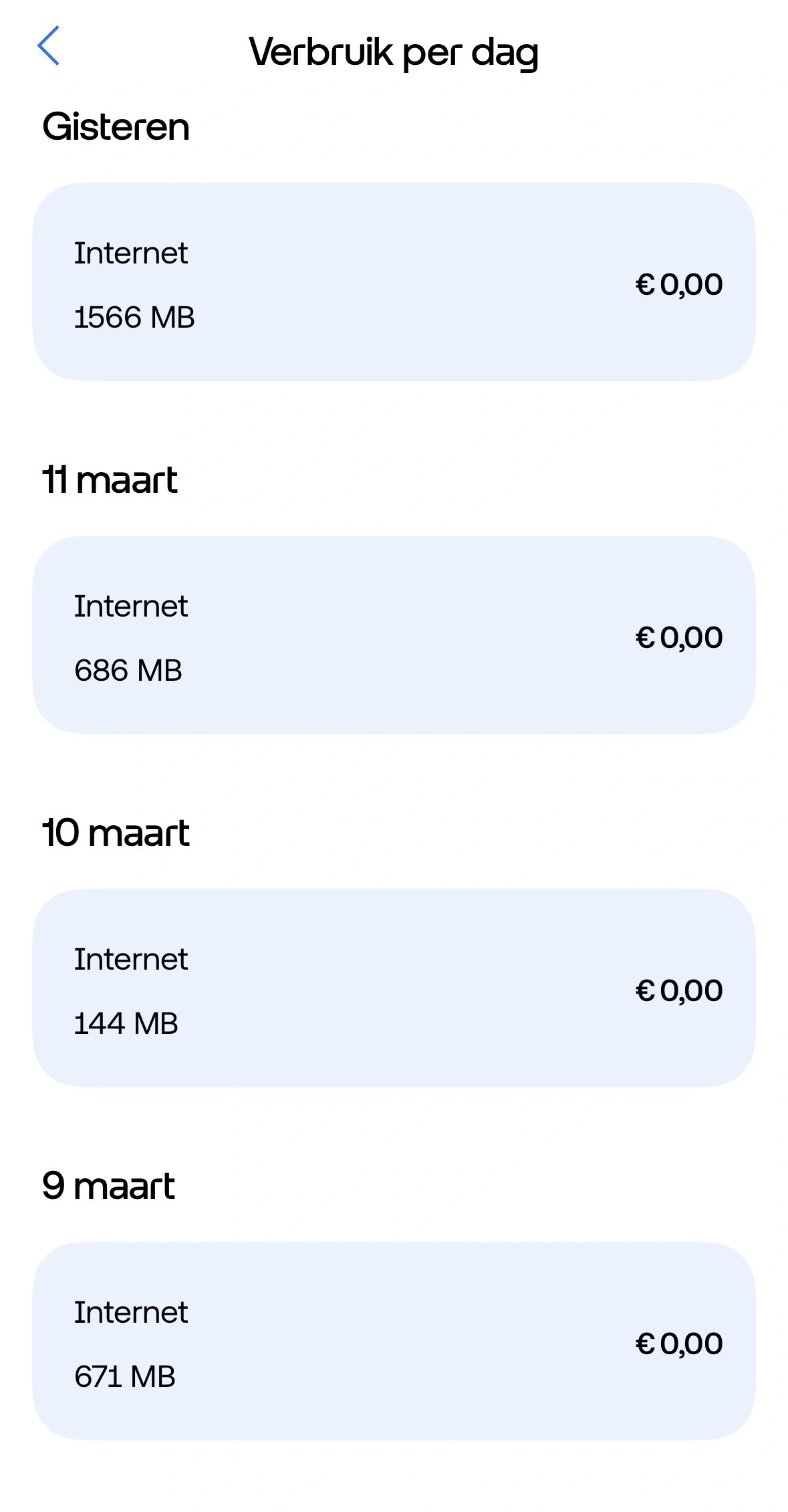

A lot of data has been used in recent days and I am looking for why so much data has been used and especially whether and how I can reduce data consumption.
See attached screenshot of the consumption.

Hi @zdenek
Is the camera configured for continuous or event recording? If it is configured for event recording, then the higher data could just signify more event triggers/recordings captured.
Hi, it is configured for event recording. But Cloud service is off. I assumed the data is only stored to the local SD card to be viewed via de APP occasionally.
Hi @zdenek
Although you are recording to a local MicroSD card, to view the playback/recording remotely on the app the footage has to be uploaded over the internet to be viewed. if you watch the recordings for slightly longer on any particular day, this might be why you've seen a jump in data usage.
@zdenek
Could your remote access password be compromised?
From your image are those the total internet usage figures? Can you break it down to the inbound and outbound data figures?
