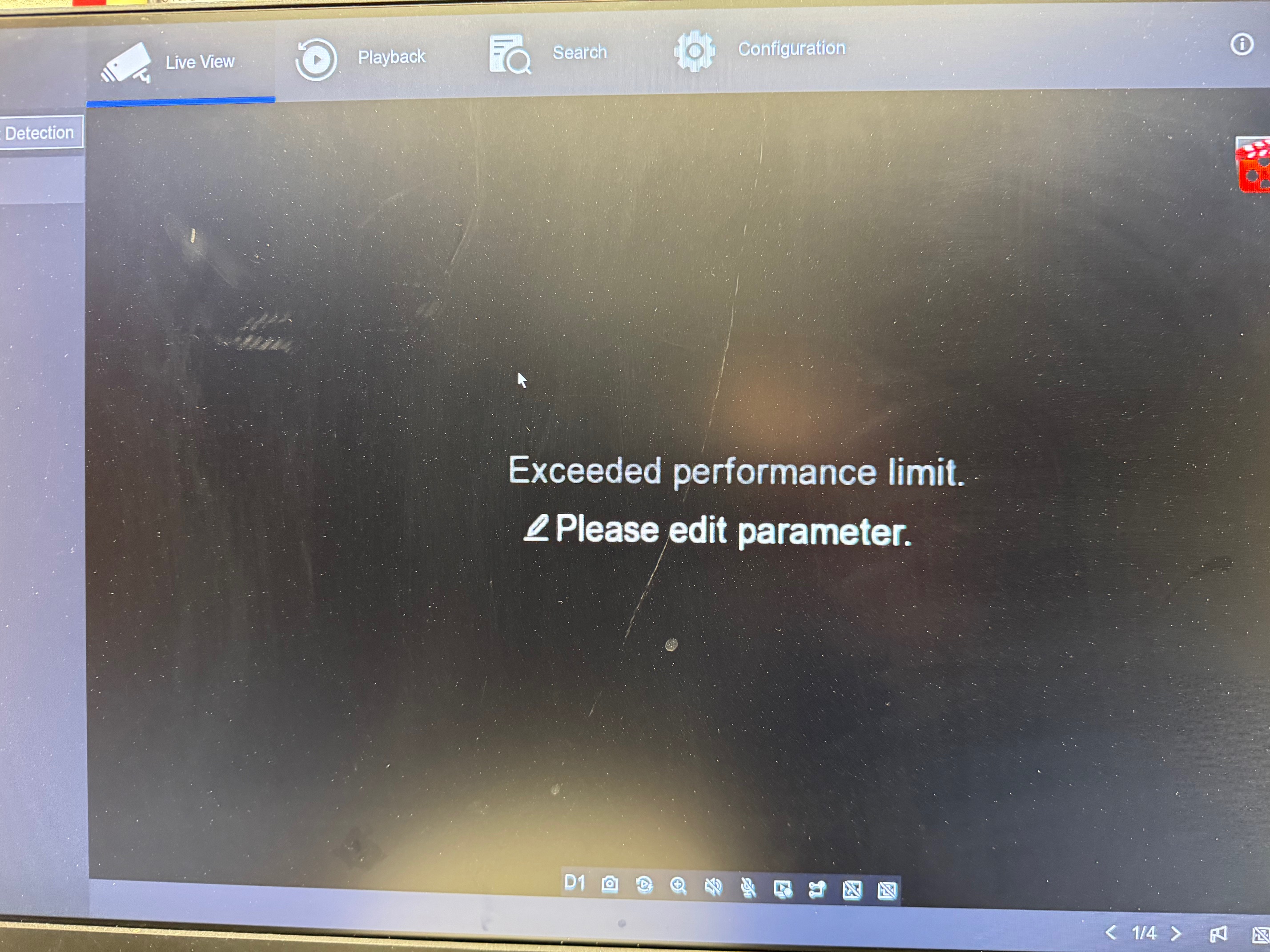

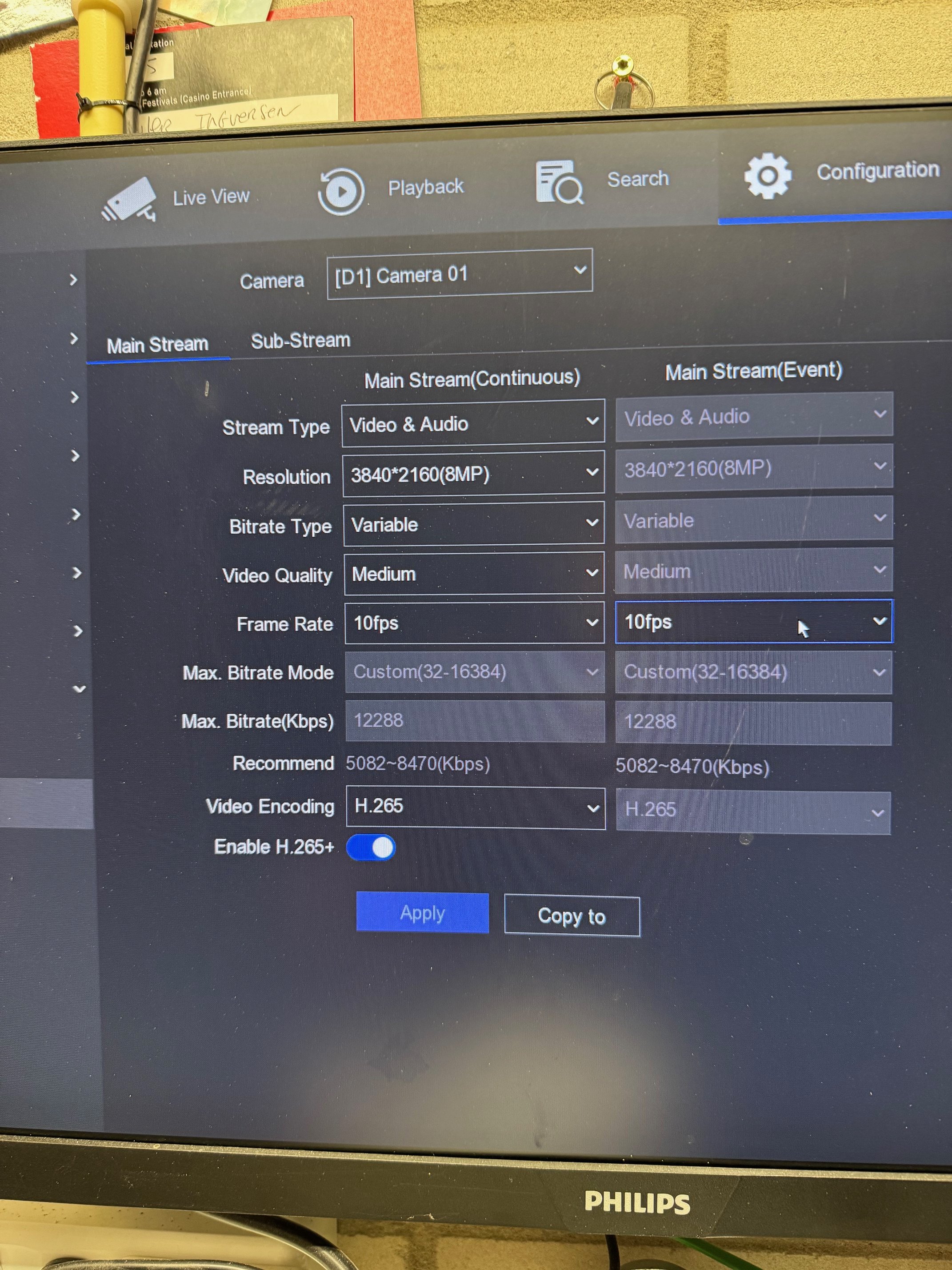

Hello, I bought a new 8mp camera to replace my former camera. Unfortunately, I get the message "Exceeded performance limit" when I connect my new camera (DS-2CD2187G2H-LI(SU)) and choose the 8MP setting. My other 2 camera's (3 in total) are 4MP camera's. According to the spec sheet this should work, is there something wrong in my settings?
My DVR is DS-7604NXI-K1/4P

Decoding Capability
AI on: 1-ch@12 MP (30 fps)/1-ch@8 MP (30 fps)/3-ch@4 MP (30 fps)/6-ch@1080p (30 fps)
AI off: 1-ch@12 MP (30 fps)/2-ch@8 MP (30 fps)/4-ch@4 MP (30 fps)/8-ch@1080p (30 fps)
Thanks! I believe my camera's are below these specs. Could my monitor be the reason for the notification? I don't see this message in the Hikvision app.
This is NVR concern not cameras. It means you can only run 1 live view 8MP, others will show no resource. And you probably use AI ON
K series is not an option for 8mp at all M on other hand is
