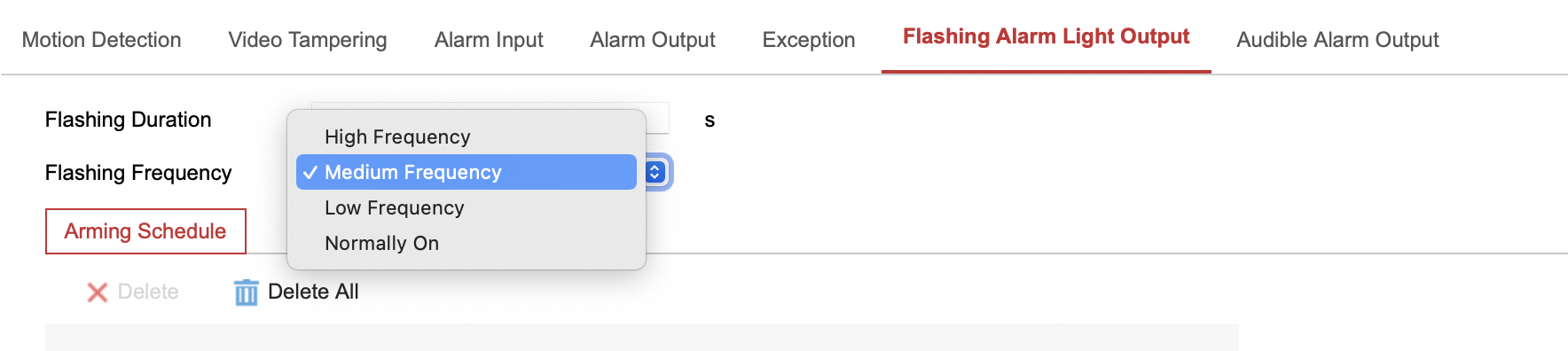

I've not looked at the video but have just had a look at my LSU/SL. there is no 'White Light' linkage as an action, just the 'Flashing Alarm' on the LSU/SL. However the flash frequency can be set to 'normally on' which should do similar. You would switch off the LED illumination but set the flashing light as an action on the event and set the flashing light to 'normally on'
Edit: Just watched the vid which shows the same as what I found.
