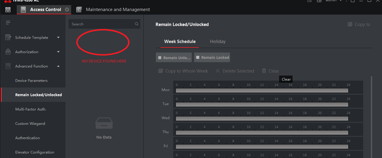

I've been trying to set up a time frame 8am to 5pm (remain unlock) schedule to this intercom access control but I can't find the solution.
I need to use other IVMS 4200 version?
Here is one example, but still I cant Find which is that Version of the IVMS 4200, and also I don't know if the device maybe is not compatible.
Please let me know if you have any suggestions.
Thanks!

Hey @trempa92
Thanks for your help. I just update the firmware o the intercom.
I can see a lot of new options but I still can't find the option for auto unlock schedule for visitors.
I'm using the lates version of IVMS 4200 V3.1.1.11. Maybe i need to use another old version??
Can you please let me know if there any tutorial, example or video on YoutTube that I can use as reference.
Thanks for your help again!!!
