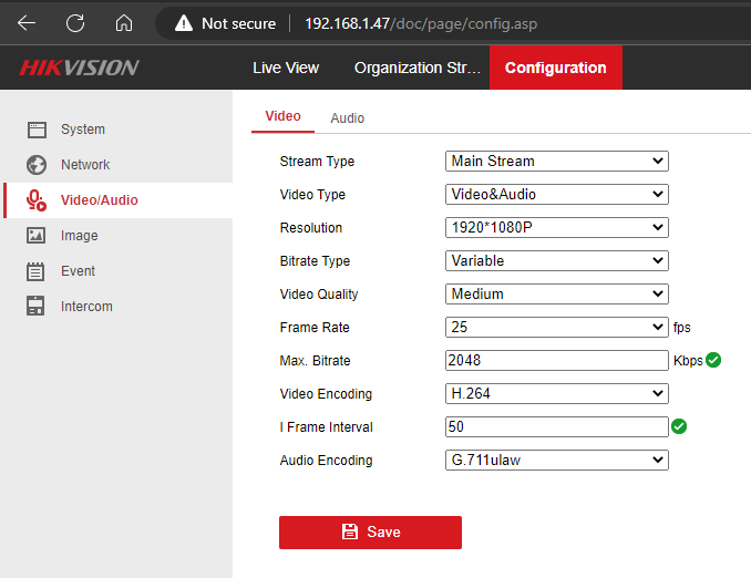

I just tested different configurations of the video/audio settings - nothing makes any difference whatsoever.

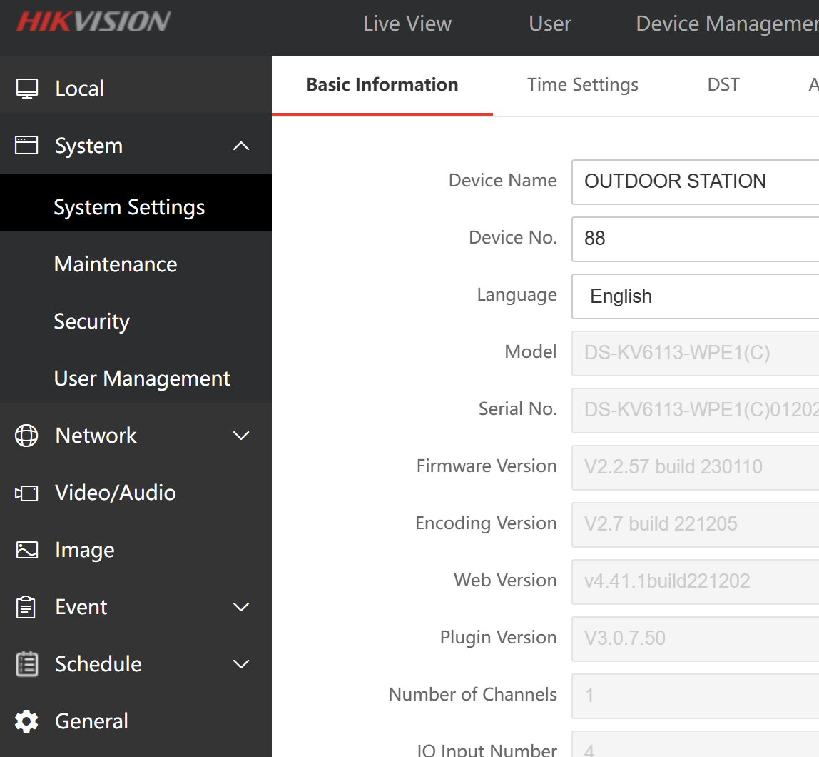

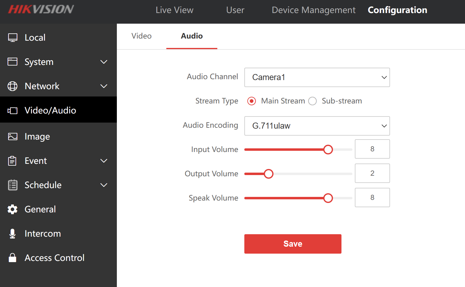

Looking at your screenshot I'm guessing you've adjusted the three volume levels in the audio tab? By default they're all set to 8. My interface looks very different to yours; are you on the firmware? For my DS-KV6113-WPE1(C) it is 2.2.57_230110.
Looks like you have the newest version of the 6113.
I have the very original version, running the latest firmware for that original version.
I have adjusted the volumes. No difference at all. Starting to think I have a faulty unit.
