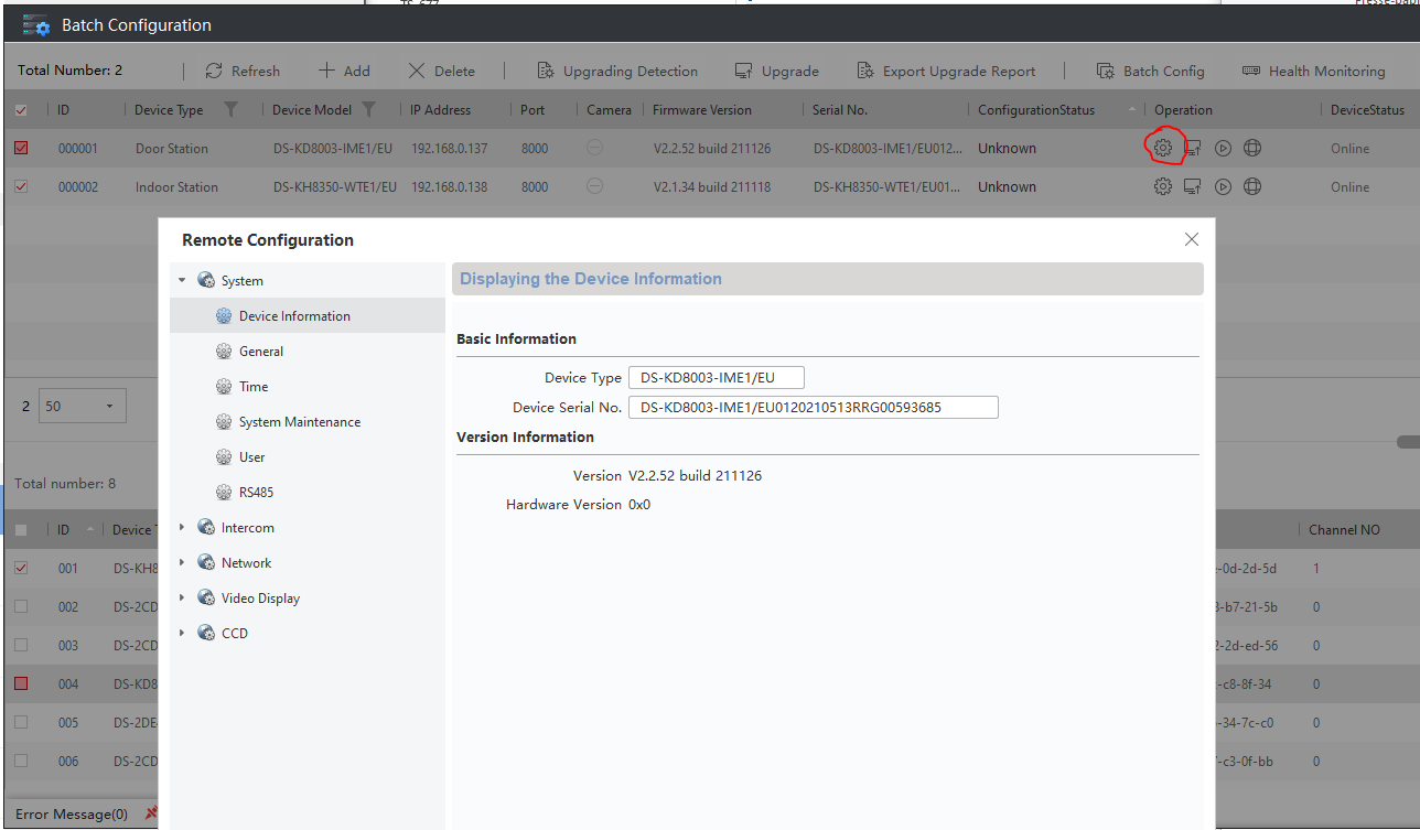

Through batch configuration tool I can access to remote configuration, while IVMS still gives me a blank page...

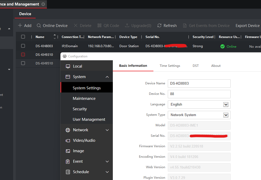

i run this version: V2.2.52 build 220518
i have no issues with this device, hikconnect works, also if i test SIP it works, no issues, quite stable
Maybe its ivms related? try updating ivms too, i remember issues with ivms and newer firmwares , i run 3.6.1.5 build 20210831
They fixed iVMS access to the KD8003 !!!
fw 2.2.56 build 220207 + iVMS 3.8.0.4 build 20220705: it finally works again, iVMS can access the configuration page of the KD8003.
