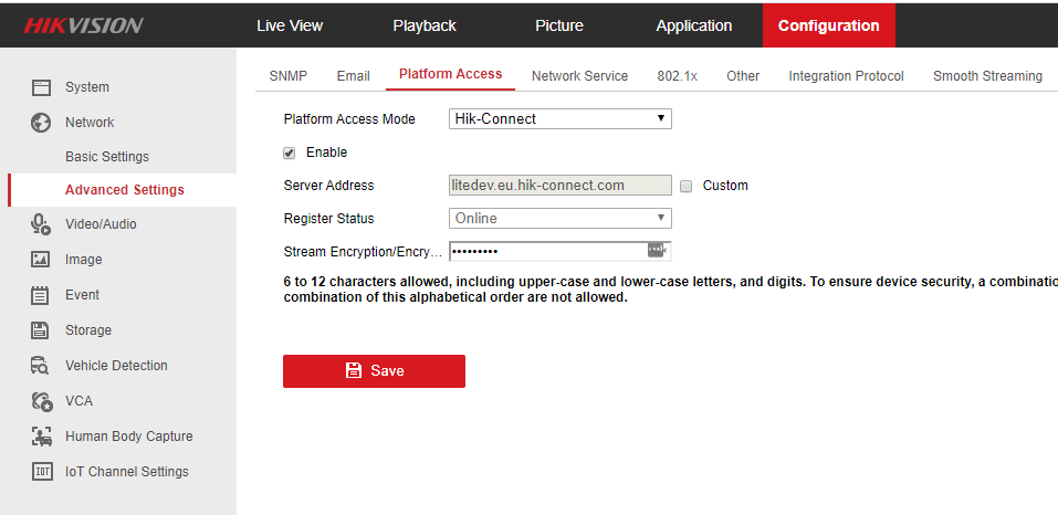

My Hik Connect server is: litedev.hik-connect.com is that okay? It's what it said after the update.
i've tried the dev server and still no good.
Could be your DNS setting. Disable Auto DNS and try 1.1.1.1 as primary and 8.8.8.8 as secondary. Reboot the NVR after the changes and see what happens.
I'm having the same issue on a DS-7732NI-K4, since the upgrade, I have not been able to connect to HikConnect.
The server seems to default to litedev.hik-connect.com which cannot be pinged, but have tried dev.hik-connect.com which can, and still Offline.
It's fine to use the litedev url.

Try litedev.us.hik-connect.com
i had so many problem with it before but it's now fixed my problem awhile back, in fact it made it so much better!!!
Thank you Paul, this domain seems to connect! None of the EU ones do.
Thanks again
Hi fellas. I eventually got time to get back to this. I reset the system back to factory defaults and it has come back online. I am able to connect using apps etc.
