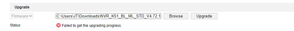

I have a DS-7616NI-K2 / 16P which is currently on V4.32.116 build 220112. I decided to upgrade to the latest version as I am facing a few issues with accessing the recorded events for a few cameras. I can see the events via playback via the phone apps (android or iphone), but when I access them via a web browser, it says No recordings found.
When I tried to upgrade the firmware, it showed me the pop up that the NVR will restart following the upgrade. However instead of showing me the progress of the upgrade on the pop up window, it shows a message - Failed to get the upgrading progress, and doesn't upgrade the firmware.
Can someone please advise what's going on?

It looks as though have the correct file. However ideally you would upgrade to the 4.71.xxx version above it in the list on the portal first. You don't need to upgrade sequentially through every version but when that middle number changes, you should update to one of them first.
It's likely just a browser issue. Try a different web browser for the update (but do 4.71 first). If you can't get it to work with another web browser - iVMS-4200 would work.

Ah - I've just looked at the image in your first post....
It looks as though maybe you've not unzipped the file? I always forget this as my Mac decompresses them automatically. When you've unzipped it should just appear as "digicap.dav"
Silly mistake - guess its been a while since I upgraded firmware. All sorted now on the firmware front. Need to focus on the events recordings. I'll follow the steps you mentioned in the first reply.

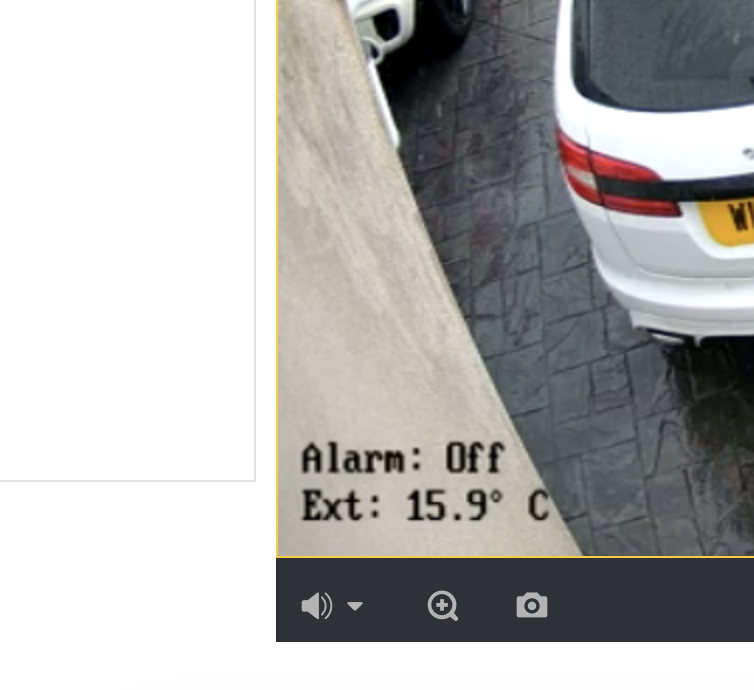

Also when I access the playback recordings on my phone, I can hear the audio clearly with the recorded clip (event based). But if I try to access via the NVR Web browser, I can see the clip but I can't hear the audio....
The Video / Audio settings are checked correctly, and the storage advanced setting to record the audio is also checked. What can be the issue here?

It's muted by default; I take it you're unmuting it in the lower left corner of the image? Otherwise I'm not sure...browser compatibility issue maybe
It's muted by default; I take it you're unmuting it in the lower left corner of the image? Otherwise I'm not sure...browser compatibility issue maybeView attachment 9828
So yes it was muted - and now I can hear the sound in the playback videos via the web browser. But if I download the clip via the web browser, I only get the video. The audio, which I could hear in the playback on the web browser, isn't available in the downloaded clip! What am I doing wrong here?!

Nothing. Use Hikvision VS Player to make sure you get audio (VLC may also work)
I was using VLC - that is my default player for all mp4 files. I'll just downloaded the VS Player and I can hear the audio... - thanks (the nth time).
