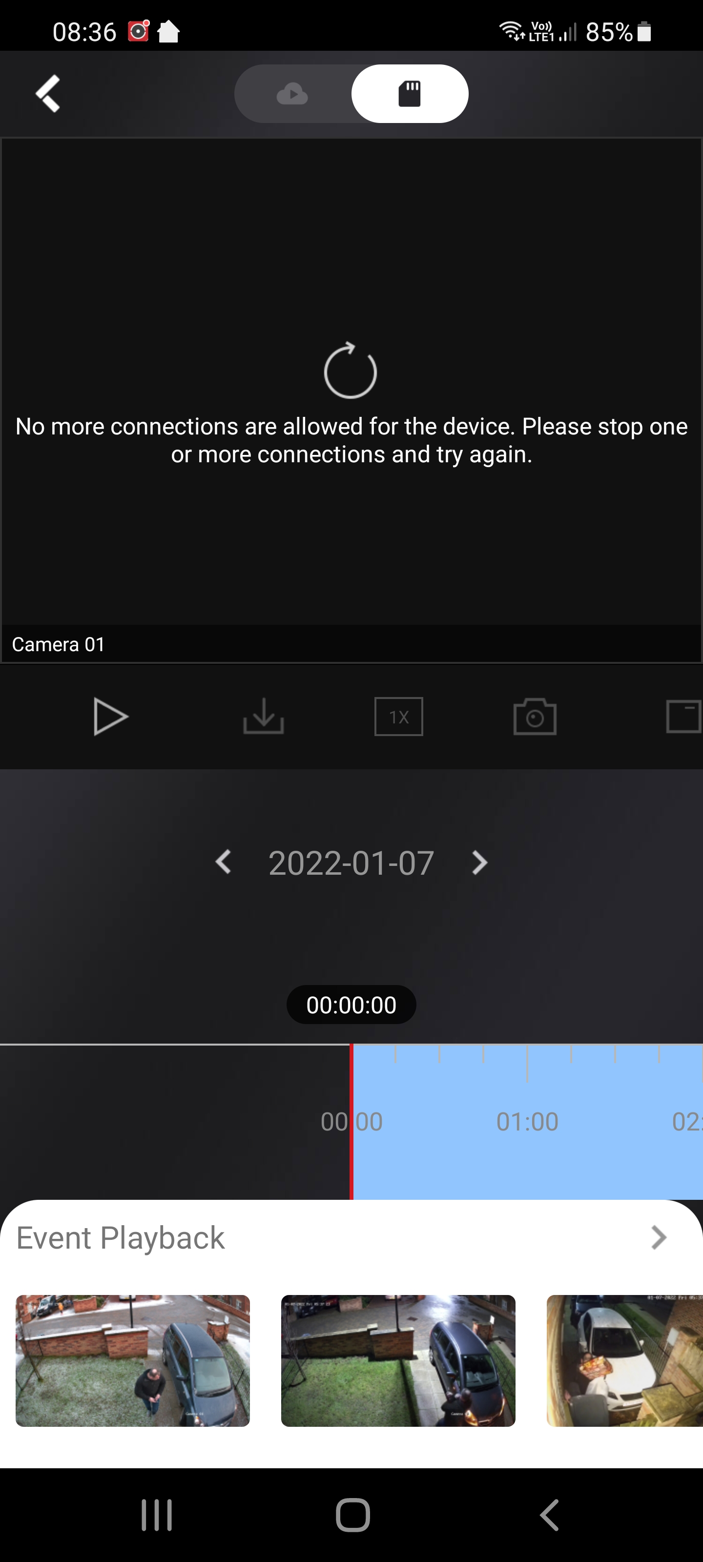

I keep getting an error on my hikconnect app when trying to view my nvr playback.
It says
no more connections allowed for the device. Please stop one or more connections and try again.

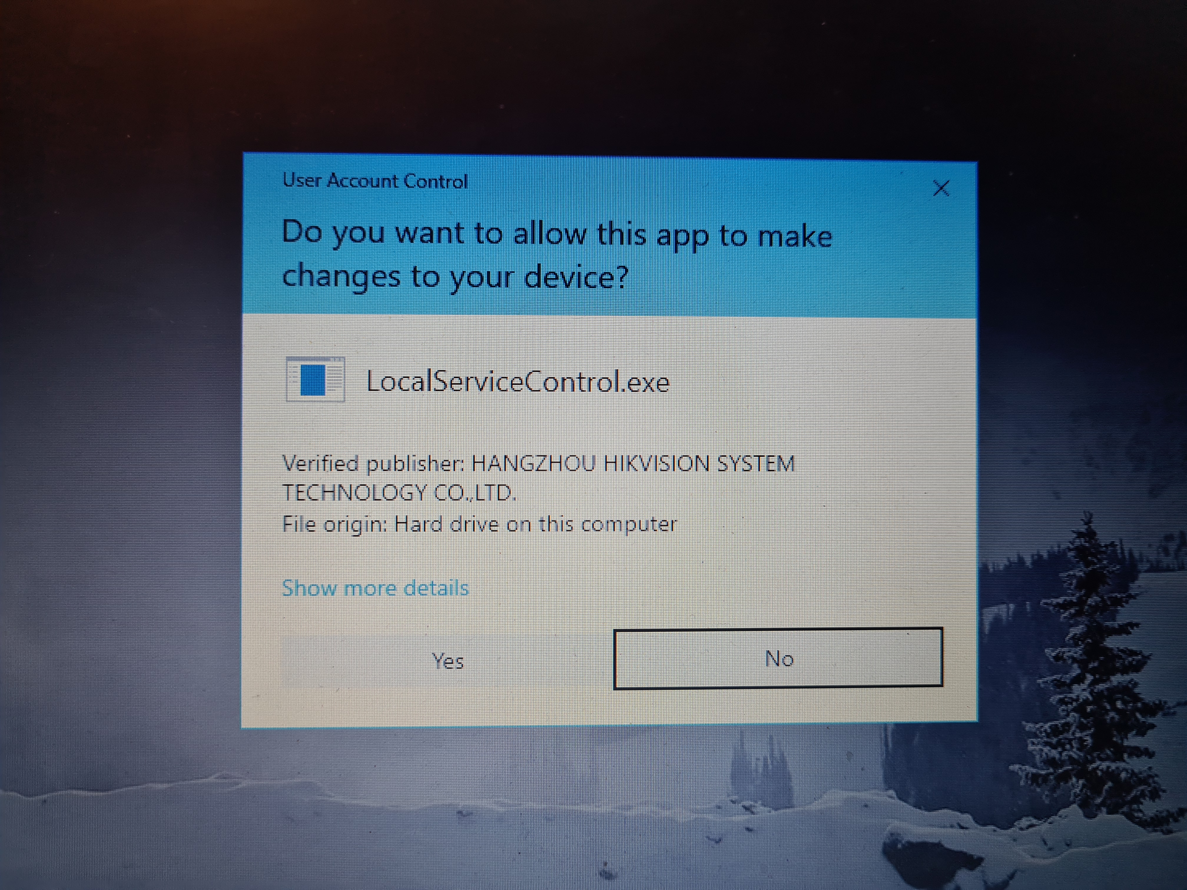

The only thing I get when I turn the laptop on is a prompt to let hikvision change settings on my computer.

Once I get the message in the app I also get a message on the nvr itself when clicking playback. It says "no more playback channels allowed.

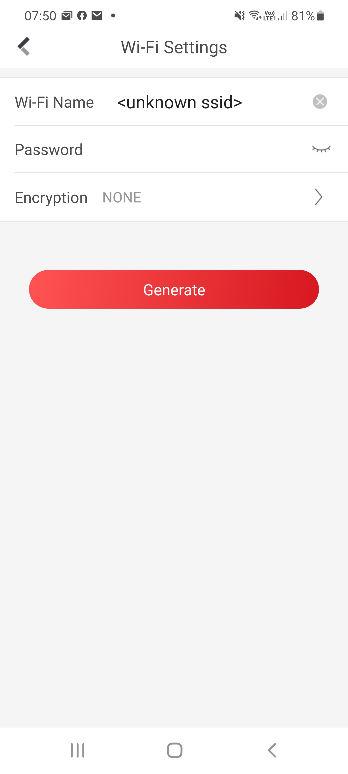

Do the app WiFi settings look OK?

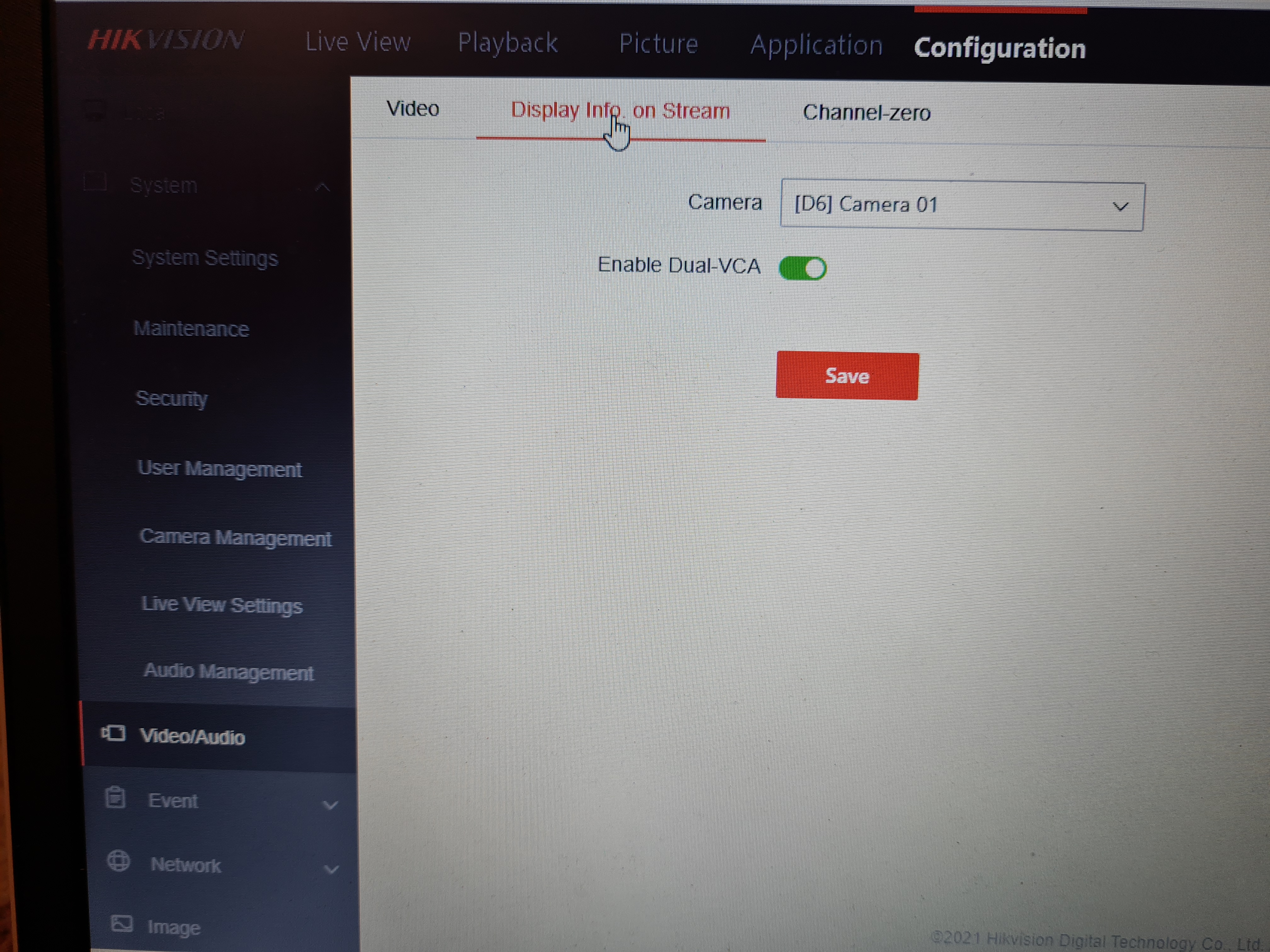

On the Web access for either camera. The device names are the same and so is the device number. .(System settings, basic information ) is that correct? Should they not have a different device No?

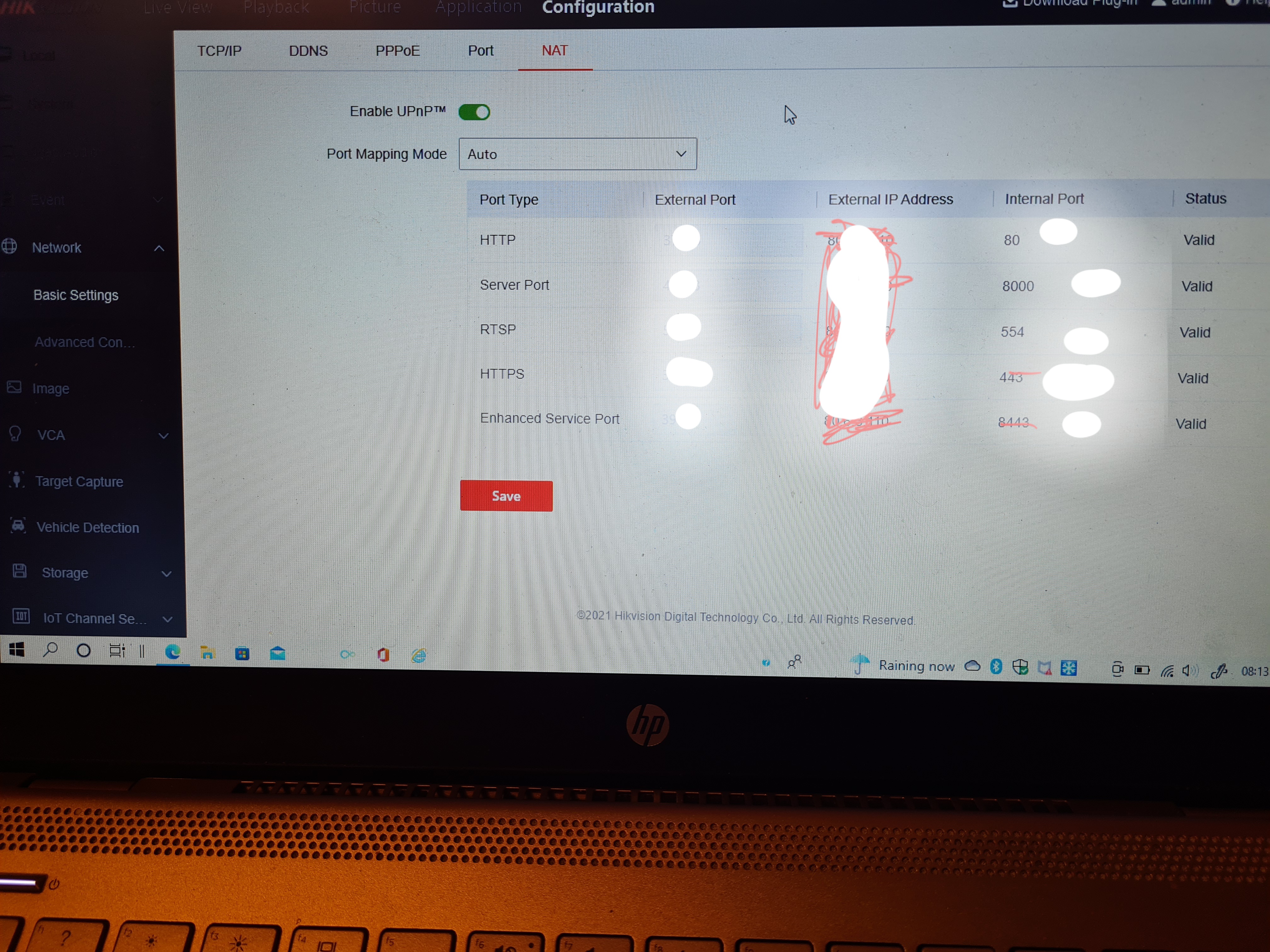

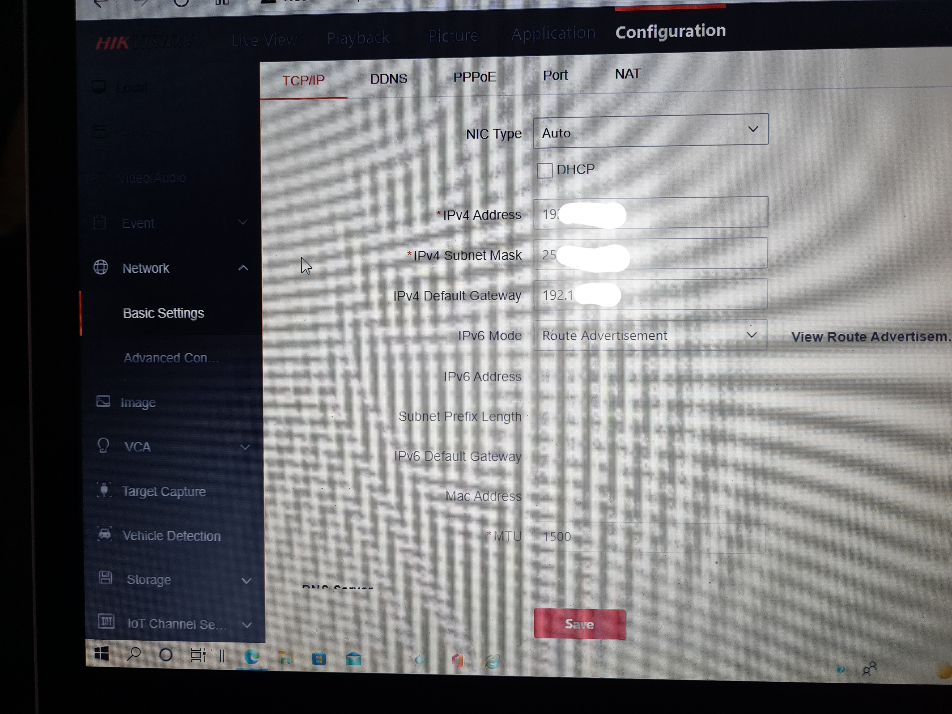

You haven't shown the screen that details whether or not you've set a static IP address for the NVR (Network Settings > TCP/IP tab). In the other thread I mentioned that for the best performance/results you should:
1 - Set a static IP address on the NVR (unknown)
2 - Change the default ports for security (yours are default)
3 - Switch off UPnP (yours is enabled)
4 - Set up port forwarding in the router (instructions were given for your Virgin Media Hub 3)
5 - Configure DDNS in the app (you mention you haven't)
Is this an app issue or an issue with the nvr not being happy with some thing?
Probably the latter - network configuration, the UPnP not working reliably despite the "valid" mappings shown hence the recommendation to use port forwarding
They're irrelevant. In normal use those settings are not needed.
That's fine. The cameras are managed and configured by the NVR. The NVR changes just the IP address in the camera when it activates it using plug and play - nothing else is needed.
The camera settings will have nothing to do with your Hik Connect problem but I notice that although they are connected to the NVR, you're possibly altering the settings directly in the camera webpage.
Unfortunately unless you attempt some of the previous suggestions it's unlikely to get resolved. Tinkering with settings randomly is unlikely to get it working and you could cause further issues.

I can't see the TCP/ip tab.

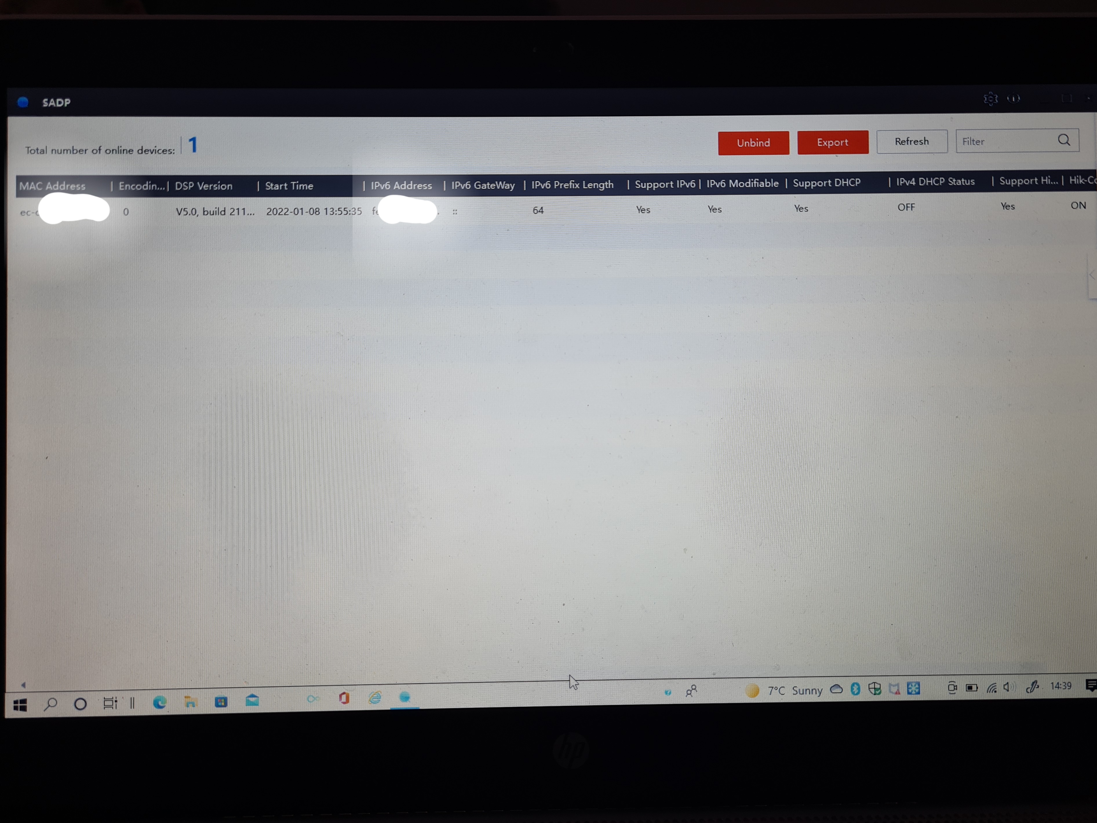

This is a snap shot of SADP should it only list 1 device?

What is the address? - it's OK to show that one as it is behind your router on the internal network - mine is 192.168.0.250 for instance. I use that one (.250) as the router hands out addresses in order, so there's no chance that the router will try and assign 192.168.0.250 to another device (as I haven't got 248 other devices on the network). The reason I'm asking what yours ends in, is that if it's a very low address - 192.168.0.12 as an example; at some point the router may try and assign that address to some item with DHCP. The router itself is 192.168.0.1 - so once there are 10 devices on your network, it's possible that the router could assign 192.168.0.12 to another device.
Yes - SADP should only show one device - the NVR. That is the reason that the cameras, when attached to the NVR, are given an address in another range (192.168.254.xxx by default) They are effectively on another network and so cannot be accessed from any device on your home network or from the internet, without going through the NVR using the Virtual Host feature. That makes it more secure and also keeps all of that traffic from the cameras off your network.

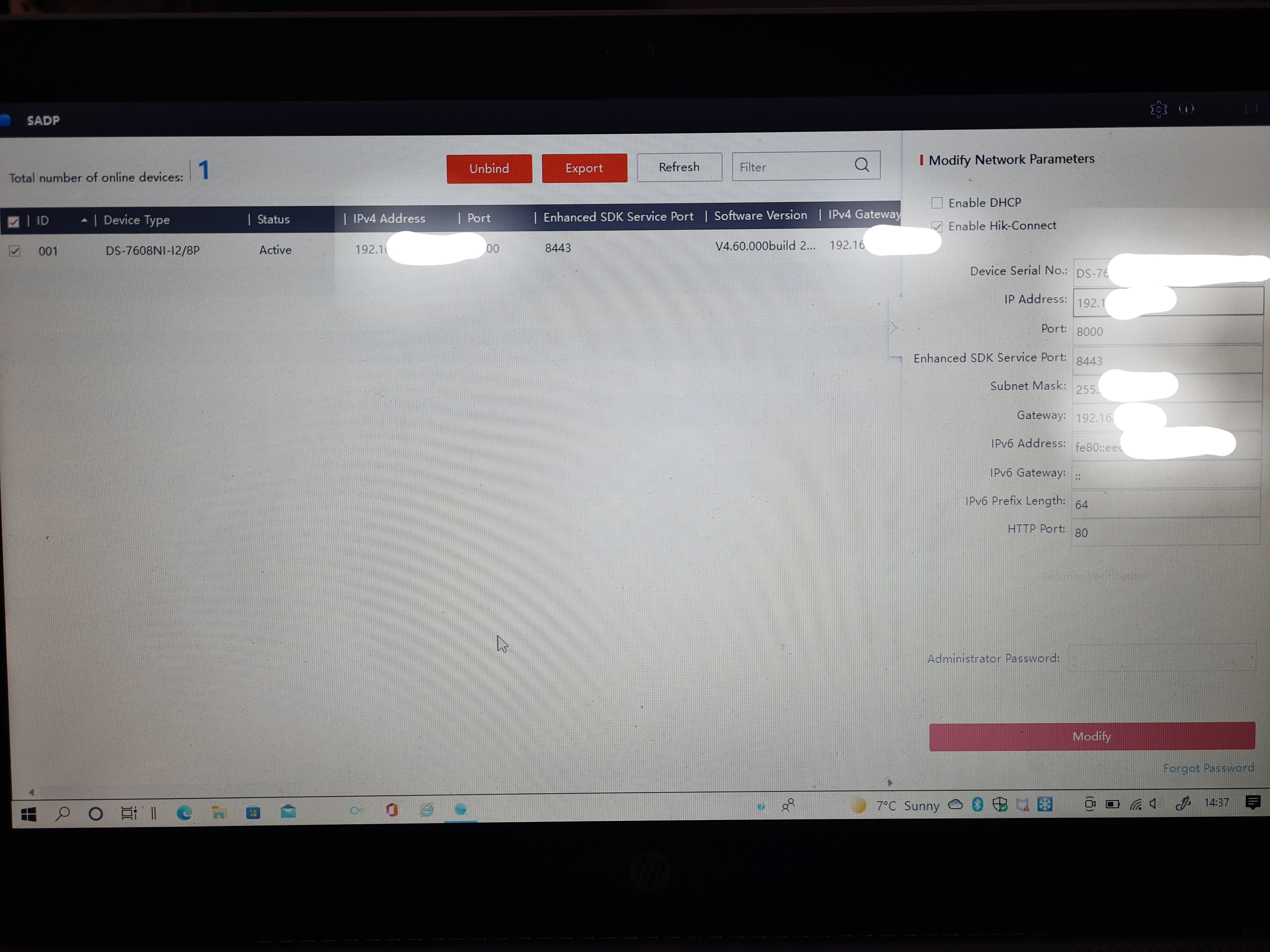

The NVR IP address is 192.168.0.??? If you decide to set up port forwarding in the VM Hub 3 - that is the destination address you will forward the ports to.
Ivp4 address or ivp4 gateway address?
Enable DHCP is unchecked in TCP/ip NIC type auto
It's the IPV4 address I'm interested in.
However while you're in that page, your gateway address should be 192.168.0.1 (same as the VM Hub), DNS address could be a variety of things but if it is set to auto DNS it will have possibly selected VMs DNS servers, which are 194.168.4.100 and 194.168.8.100. If so, untick the auto box for that and set primary DNS to 8.8.8.8 with secondary to 8.8.4.4
Ivp4 address is 192.168.0.100
Yes gate way is 192.168.0.1
