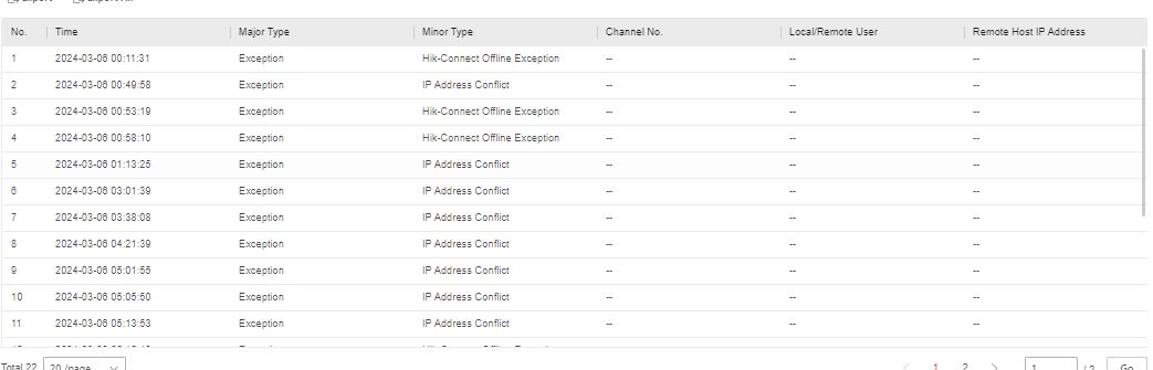

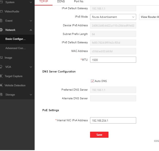

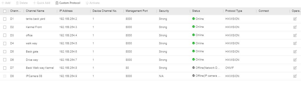

We have a Hikvision DS-7608NI-I2 and we have noticed that we are getting IP conflicts in the middle of the night.
I'm not sure if its internal NIC or the Device IP Address?
Please see screenshots if anyone has an idea?
Thank you

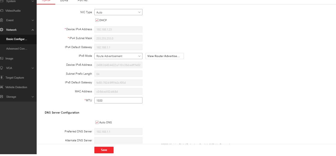

It’s likely to be the internal NIC. You have your NVR set DHCP, so it’s possible you have another device that has a static IP address that clashes with it. If you have more than one router and they’re using the same IP range it’s also possible that DHCP on the second router is assigning an address that clashes.
