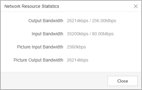

Am I hitting the bandwidth limit of the 7608NI-I2/8P?

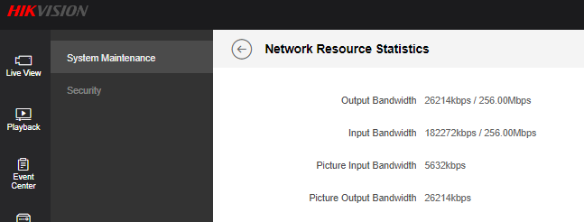

The incoming bandwidth limit on the DS-7608NI-I2/8P is 80MB. You're probably using most of it especially after adding the 2 new cameras. What bitrate are you running on the cameras? There is a "Network Resource Statistics" screen if you log into the web GUI that will show you how much of the 80MB you have allocated (this screenshot is the 5.0 GUI, but it was also in the 4.0 GUI) ...

The I series NVR was the way to go when you got it 3 years ago... If you decide it needs to be replaced, go with the DS-7616NI-M2/16P.... it has 256MB incoming bandwidth vs 128MB on the DS-7608NI-M2/8P... and you have 8 cameras now, not hard to imagine you might want to add at least 1 more camera sometime?

See below Network Resource Stats after having re-added the cameras over RTSP. This seems to suggest there is headroom as I'm only at 35.2/80Mbps.

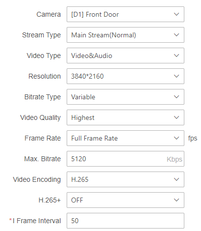

All of the Hik cameras are set to the below config:
Plenty of room there so I it doesn't seem like the Reolink issue could be caused by limited NVR incoming bandwidth.
I might try increasing the bitrates for the 6 Hikvision cameras from 5120 Kbps to maybe 8192 Kbps... the max bitrate on those seems kind of low considering the resolution and frame rate. Your overall incoming would change from 35/80 to about 53/80 Mbps.

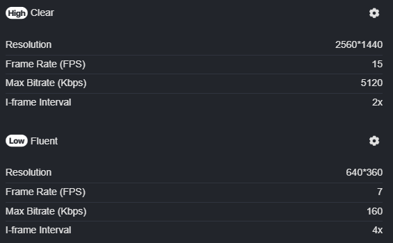

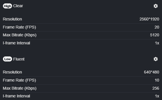

The indoor is an E1 Pro. Link here. The bitrate is set to 5120. See below configs for both Reolinks. 5120 is the highest bitrate I can select.
E1 Pro
Doorbell

I've upped all the Hiks to 8192kpbs.

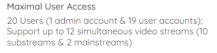

I noticed in the camera specs...
Any chance you are trying to get the mainstream to more than 2 devices at the same time?

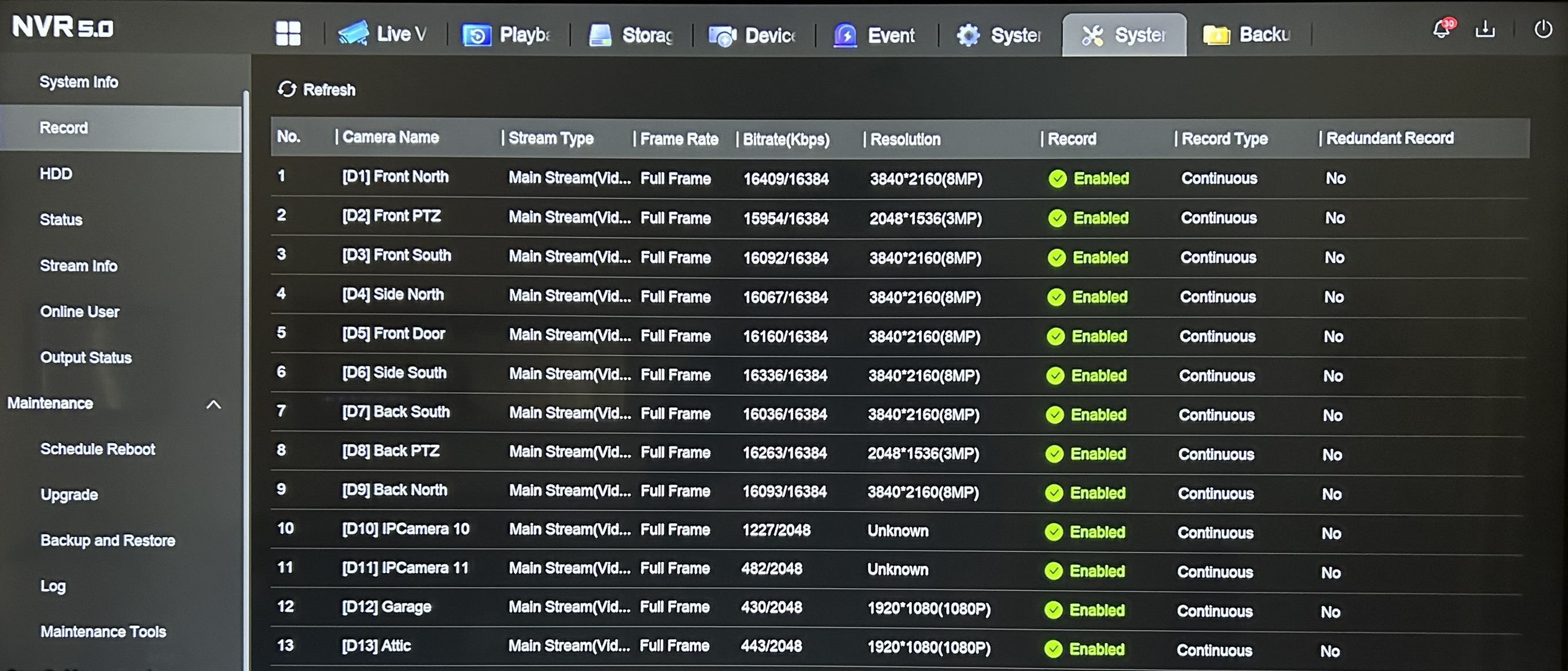

Here's my "system maintenance/running info/record" page:
Cameras 10 and 11 are connected with RTSP... camera 10 has a max bitrate of 4096 but the NVR shows 2048... at night the camera does run at a higher bitrate, and I see something like 4444/2048... I wonder what bitrates you see on your NVR's record page?
Had a think as to whether I was viewing the mainstream to more than 2 devices, but realised that for the impacted camera; the indoor E1 Pro, I was only viewing one stream at any time. So another dead end.
Unfortunately I don't have a monitor hooked up to my NVR as its in a server cab so can't easily check the "system maintenance/running info/record" page.
