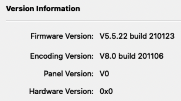

I’ve just done the upgrade (both), but still getting a « no video » signal.
I’m using iVMS4200 on Mac OS, the only one solution to get access to the cam options.
Thanks for the update @Pat007
Many of the models Hikvision offers have received updates to bring better support for modern browsers, have you tried browser access with Chrome, Firefox, etc... after updating the camera firmware?
Unfortunately, Mac users get the worst support from Hikvision as they see it as the lowest priority and focus all their attention on direct monitor access and PC browser/iVMS access, so this does lead to an increased number of problems and challenges for Mac users accessing Hikvision products.
I know several Mac users have reported better access to their Hikvision systems by installing Parallels which allows you to run a virtual Windows PC on your Mac.
Also, many Mac users have used the SecuritySpy software which is a much more up-to-date and Mac-friendly VMS than iVMS (and supports most Hikvision cameras, but you might need to check with them if the thermal camera you have is supported).
