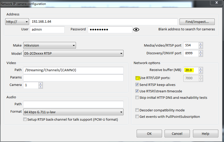

Is this what you wanted to see?
Yes, that helps. Matching the Frame Rate and I Frame rate is important. Have you increased your Receive Buffer and disabled RTP/UDP ports.
2208
What are your settings here?

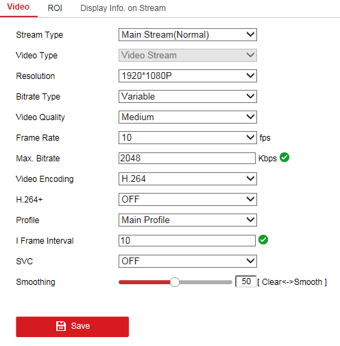

Let's try a few other changes to narrow the issue down.
On the camera:
Set the Bitrate Type to Variable
Set bitrate to 2048
Lower the Frame and the I Frame Interval to 10

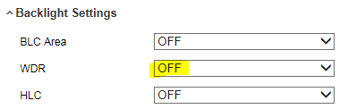

Under Configuration>Image, turn off all the BackLight settings. WDR mainly, but disable BLC and HLC if your camera supports those settings.

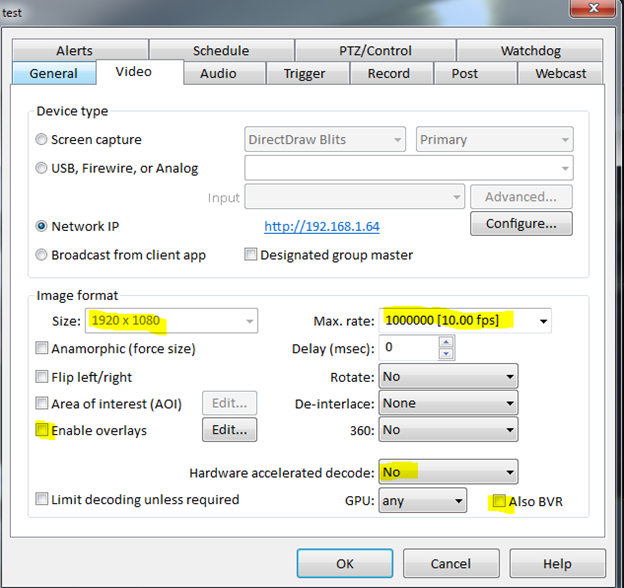

Then match the new settings in BlueIris under the camera properties.
Size and max rate match the cameras resolution and frame rate.
Hardware accelerated decode NO
Enable Overlays unticked (it has to re-encode the frames if enabled)

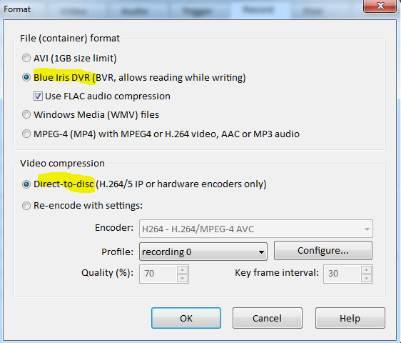

BVR unticked
Limit Decoding unticked
2239

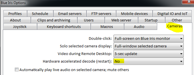

After I made those changes above I went into BI and changed the buffer from 6 to 20 and it started freezing and the horizontal line was gone. Now I know if I go back into BI and reselect Hardware accelerated decode to No even though it is already No it will stop freezing and the horizontal line will come back.
