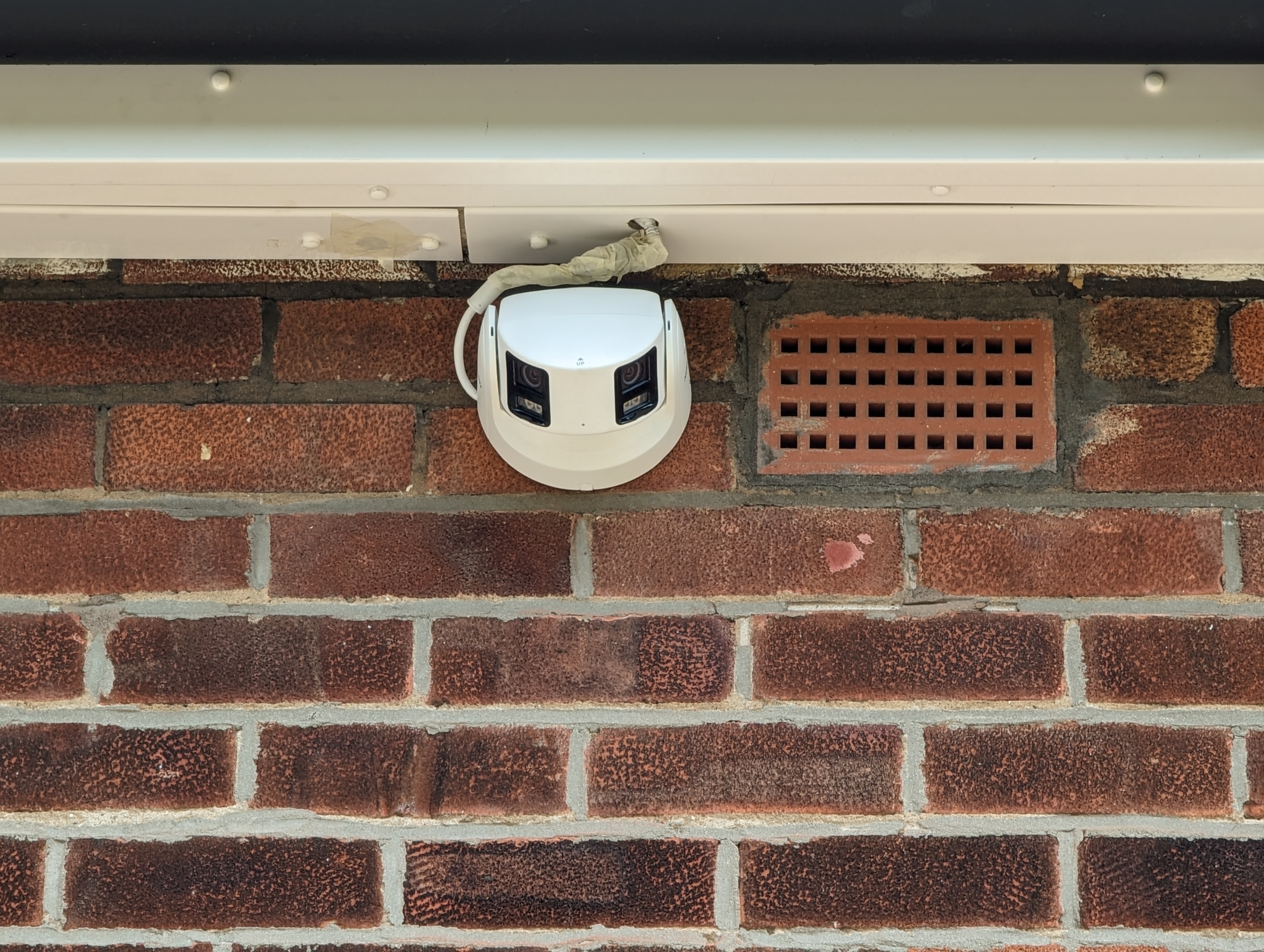

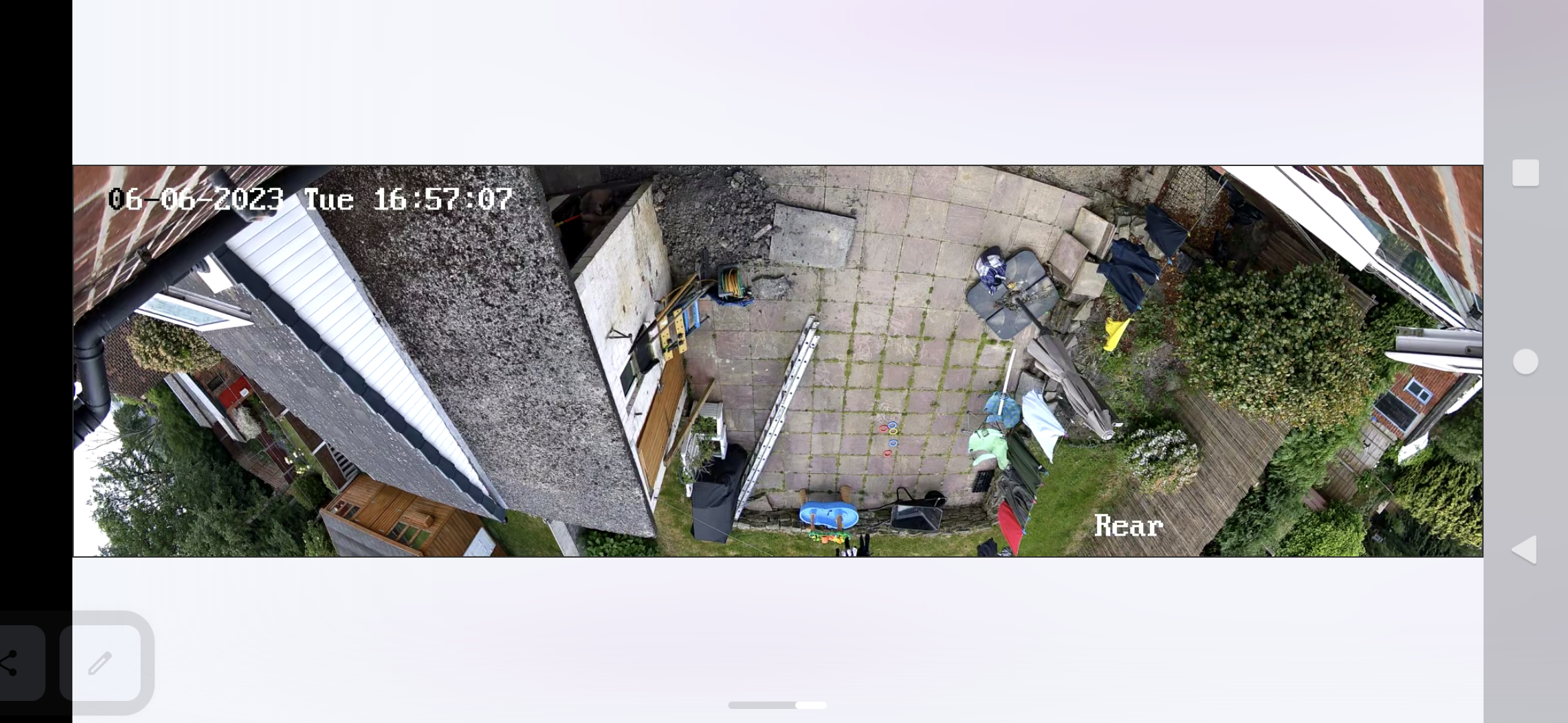

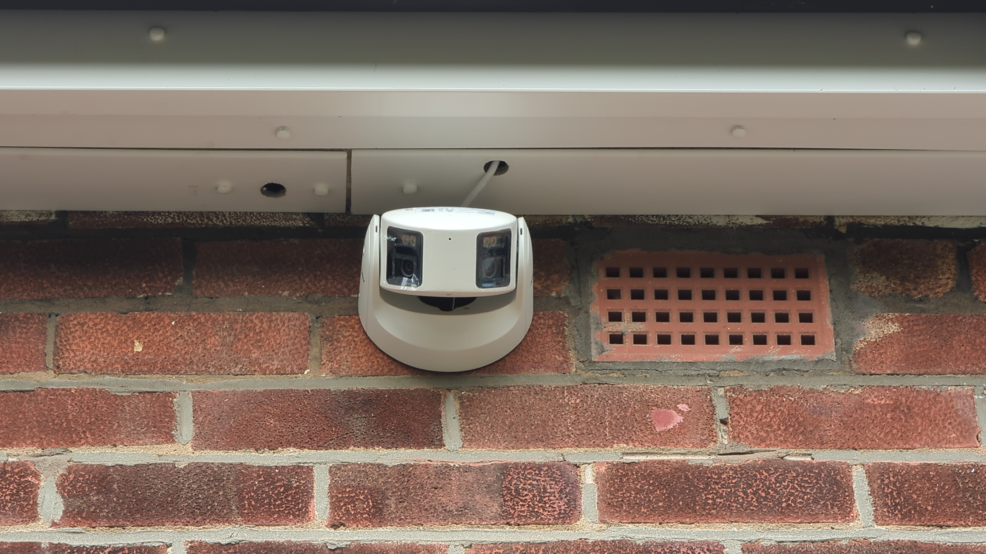

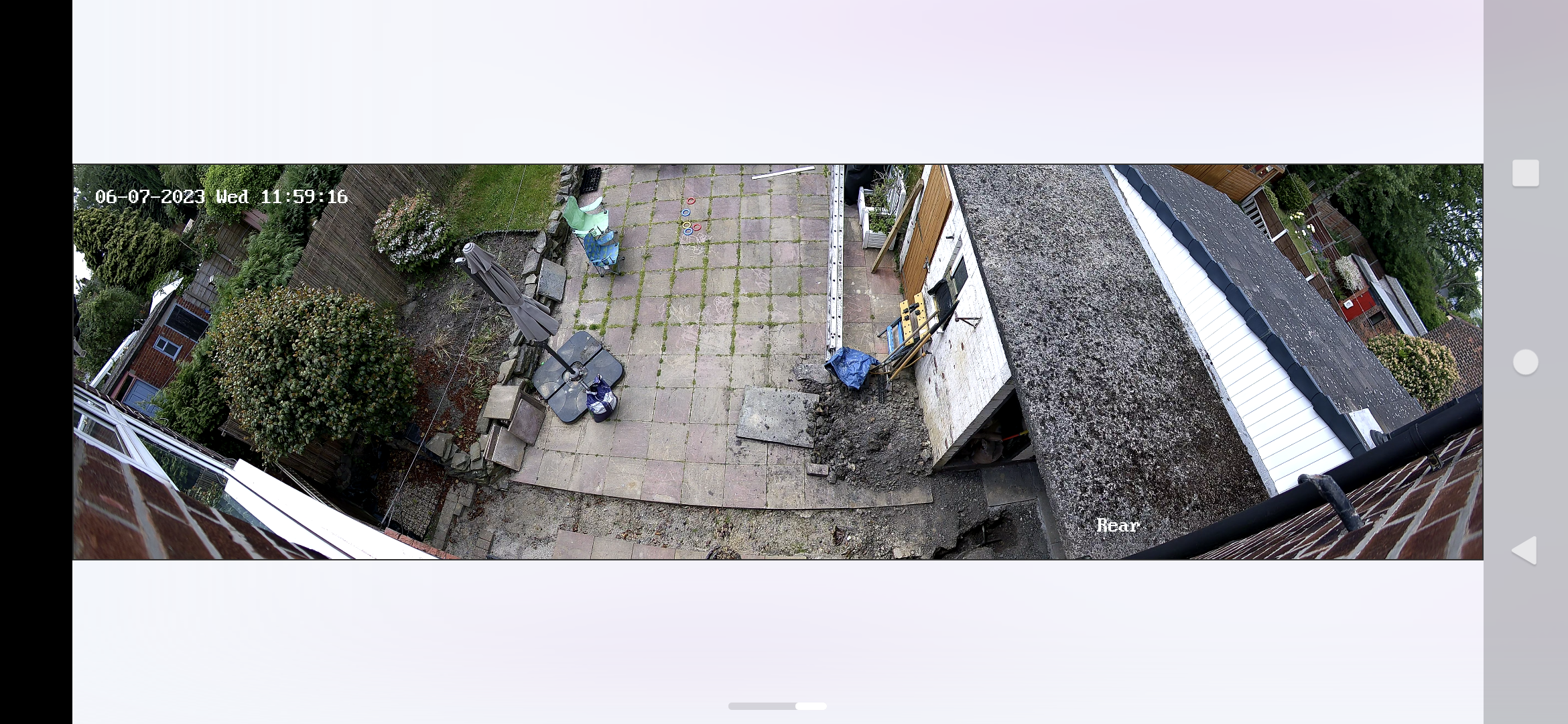

Removed camera, mounting plate, turned it around 180 and it's now "upside down" but the camera is now mounted the correct way around with the cable coming out of the left.
Doesn't look as nice but at least it's not upside down anymore.
Baseplate correct way up and camera upside down, cable coming out of the top
Baseplate on upside down and camera the correct way around, cable coming out of the side
