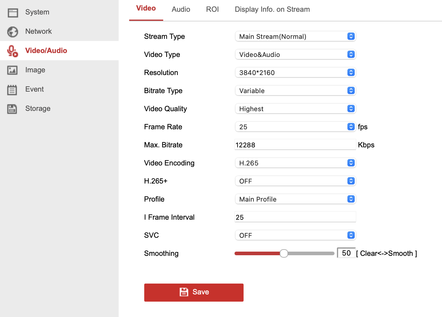

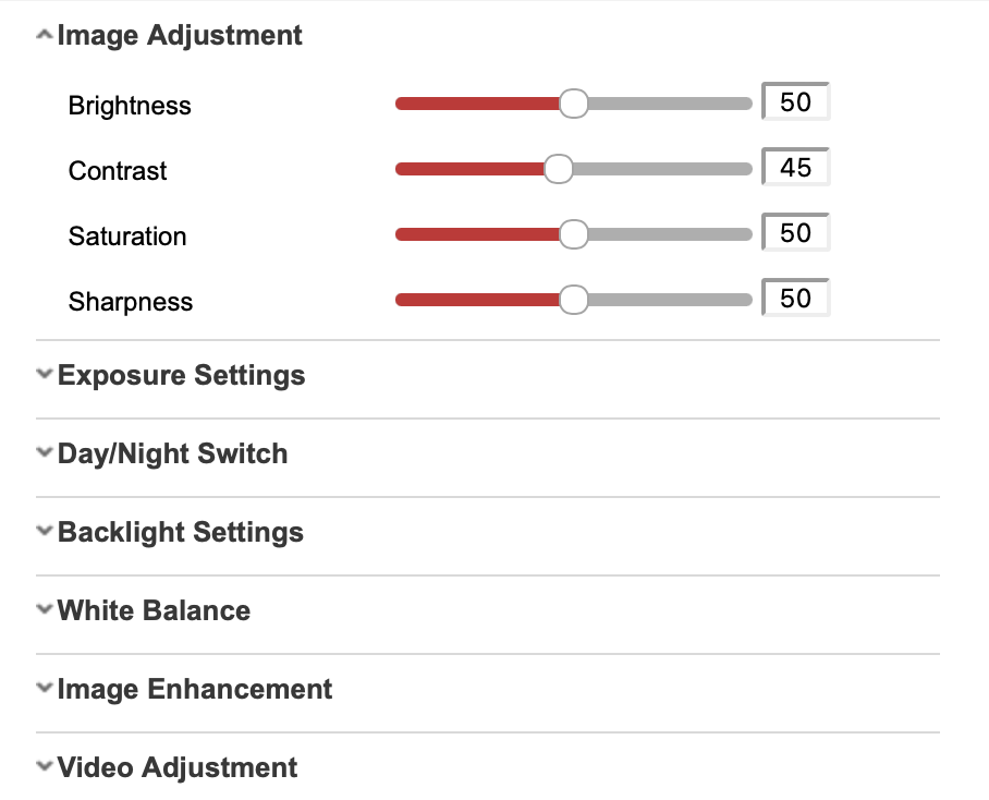

Lol - I knew I'd seen that road somewhere before - I used to do a lot of alarm installations around Hartlepool years ago. I'm in the Boro. I also had a thought about the "675" in your username but could be way off! My settings are below for one of the 8MP ColorVu's. You might find that you have to lower the exposure time to 1/50 sec if there's not much light and maybe the camera is high up at a distance from what you want to see.
