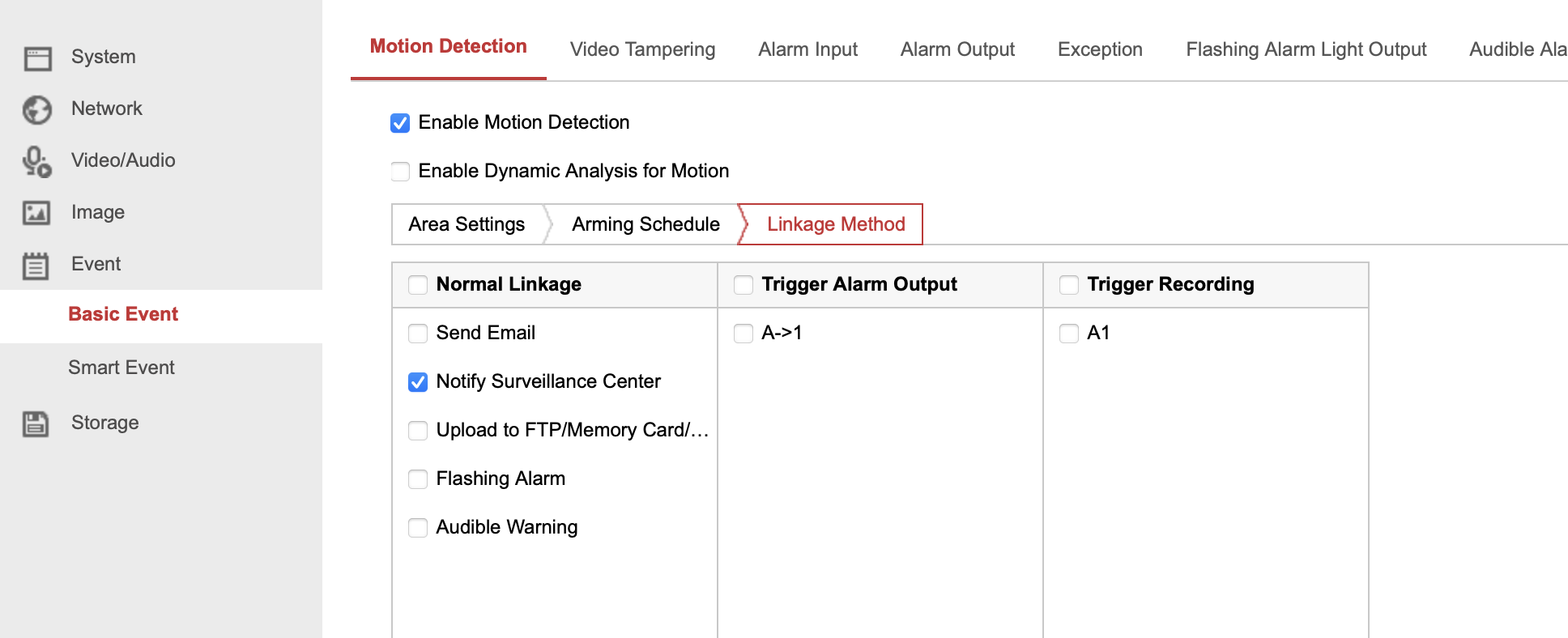

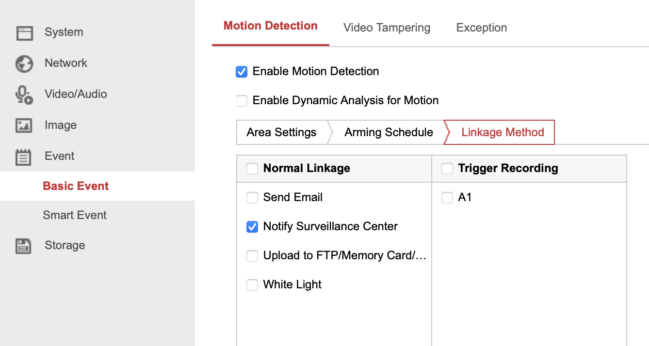

It's actually still available (white light on event) on the new 5.7.13 I posted about yesterday. It's been added and removed several times. This is an LU on 5.7.13:

The LSU/SL model doesn't have white light on alarm, just flashing light on alarm and has always been that way. This is an LSU/SL also on 5.7.13:

Though these are both G5 (C) cameras not G3.
@grantring you won't see the setting in the NVR, after you've set up your event as normal, the white light action can be added by logging into the camera directly.
