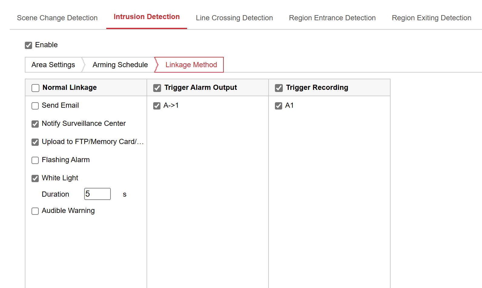

I've set it up to do intrusion detection and added the linkage method as per the attached picture.
but for whatever reason, i can't seem to get notifications on my hik-connect app on my phone.

Are your cameras registered with Hik-Connect? As without that and your phone being logged into the account they're bound to you will not get notifications. Notifications are not available if you add your devices to the app using their IP addresses or a DDNS address - they have to go via Hik Connect.
In:
Configuration > Network > Advanced Settings > Platform Access
Is Hik Connect enabled and is it showing online?
got it working, thanks for the replies.
it was showing online under platform access.
the issue was with how the hik-connect was setup, i had to select use hik-connect server or something along those lines, now its working fine.
