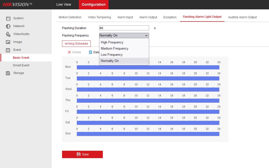

Newer firmware for this camera has the static white light on event (normally on) which does the same thing as LED linkage
flashingalarm-jpg.9224

The static white light on event feature you are referring to doesn't activate the two side white lights, but only the center event light. It is less than half of the luminous flux output, and that isn't desirable at all for the application at hand. It isn't exactly a 1:1 functionality. Please correct me if I am wrong about the 2 lights vs single center light functionality on newer firmware - this is my understanding from the last time I looked into this issue. I'd **love** to be wrong about this.
