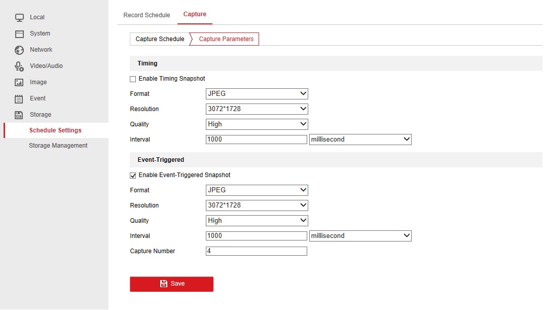

Hey,
Hope this image helps. I think you might be able to change settings of images here.
Hi.
Many thanks for the suggestion. However that is one of the first things I tried with no effect.
The excellent support guys at Use-IP have subsequently found out direct from Hikvision that resolution of pics attached to email notifications is hard coded on this model camera.
It used to be full HD resolution but was lowered in the latest revisions of firmware to cure some issue that some customers were experiencing.
It would be nice if Hikvision introduced a setting for it in the future, but for now it is what it is.
Cheers
