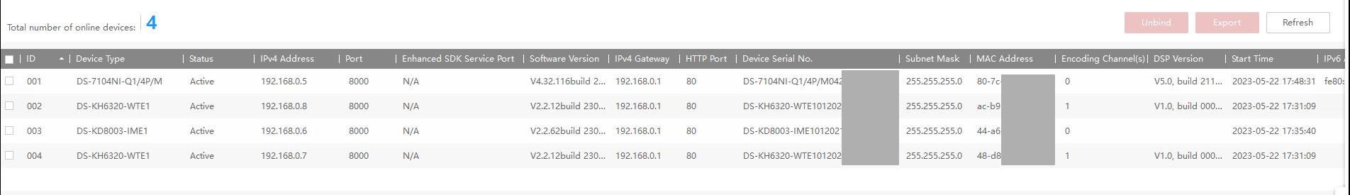

1. I had set up all Hikvision devices with fixed IP addresses and made sure it's outside the DHCP range. I verified my setup using SADP and it looks ok, BUT I see two indoor 6320 units with two different mac addresses.. but I have a single unit installed in my house! Is that normal?!

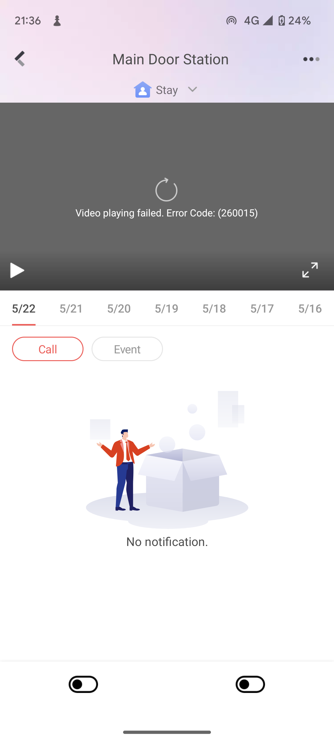

3. Registering the doorbell device to the android HikConnect app through the HikConnect service (using the serial + validation key) works, and I see the device online, but I can not watch the video feed from the app. Loading the video feed in the app just stops at 80%, and after a minute waiting it says "Video playing failed. Error Code: (260015)". I have UPNP enabled on my ISP's modem, so that should not be an issue.

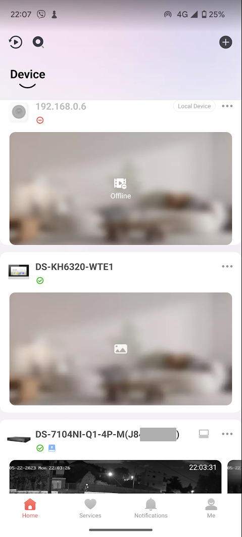

Note that I also have a DVR device DS-7104NI/4P/M installed with 2 cameras in the house, and they are working flawlessly, locally as well as remotely, through the HikConnect android app. I have zero issues with those, though I wonder if maybe the DVR takes the port from the doorbell unit when HikConnect tries to connect remotely..? I have all devices on the default ports (port 8000 and http 80). I attach the SADP screenshot of my setup..
