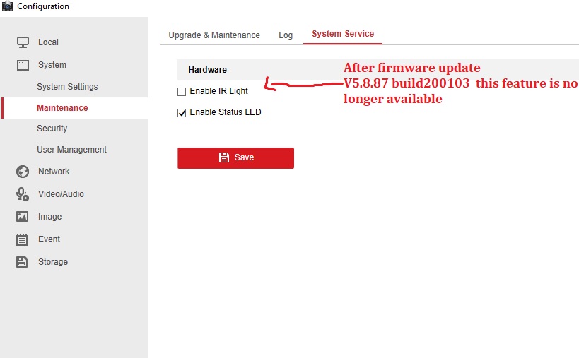

The latest firmware version for G0 5.5.87 worsens worse from the camera menu after the update can not stop the infrared

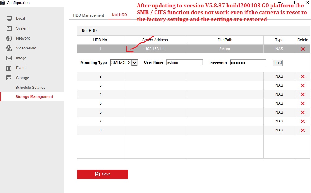

and the camera no longer connects to the nas server samba cifs
It does not work anymore

I managed to downgrade to version V5.5.82_Build190130 (1X43GO 1X53GO 2X4'51G1-IDW1'2)
I have downgraded with the Hikvision Batch Configuration Tool now it works just as well as before
in the update note he wrote that no downgrade can be done but I did
Note Do not downgrade the device with factory version 5.5.87 to below 5.5.87

I have following issues identified on this camera:
1) no option to disable IR
2) does not support any of major browsers (Firefox, Chrome, Opera, Edge) - only obsolete IE11 worked for me on Windows 10
