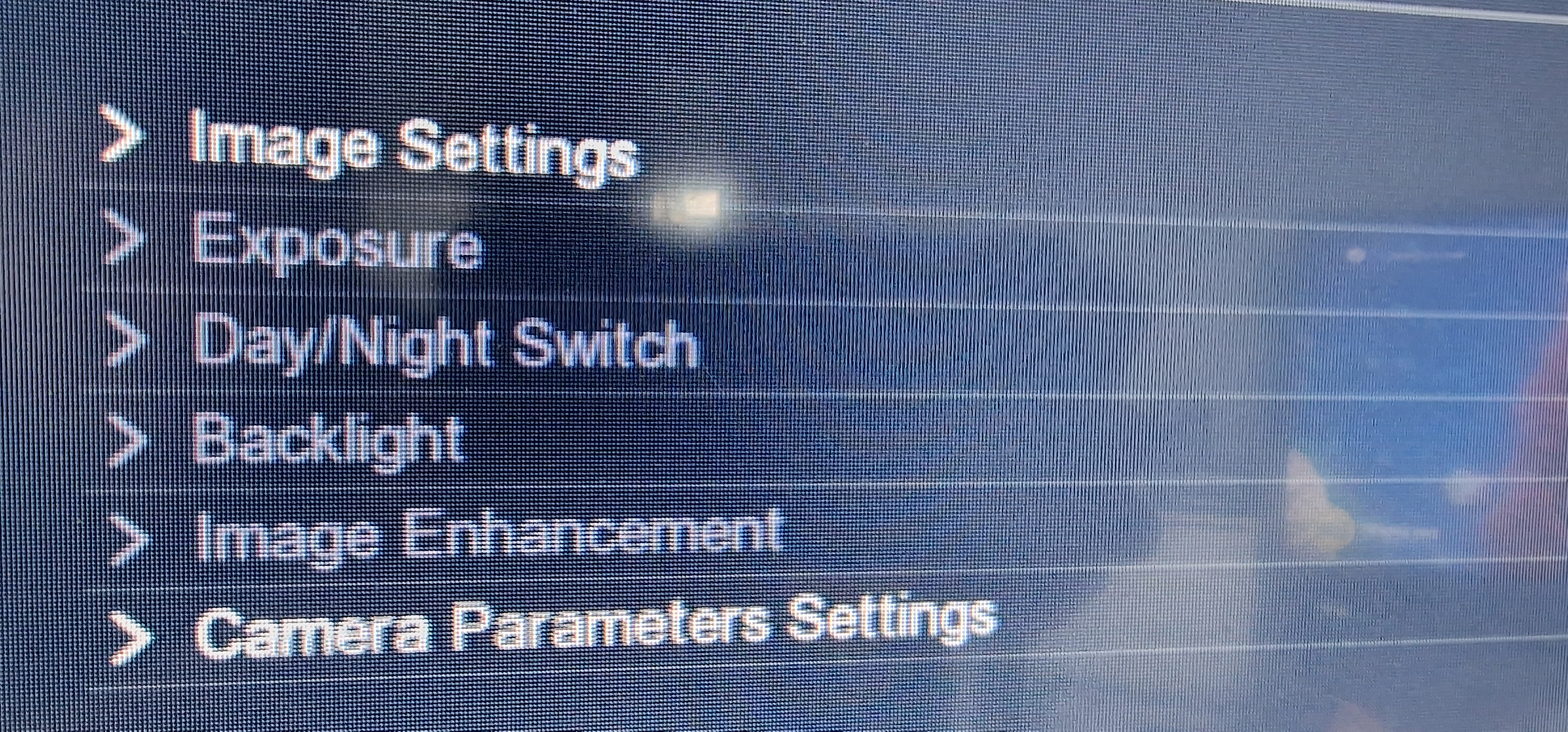

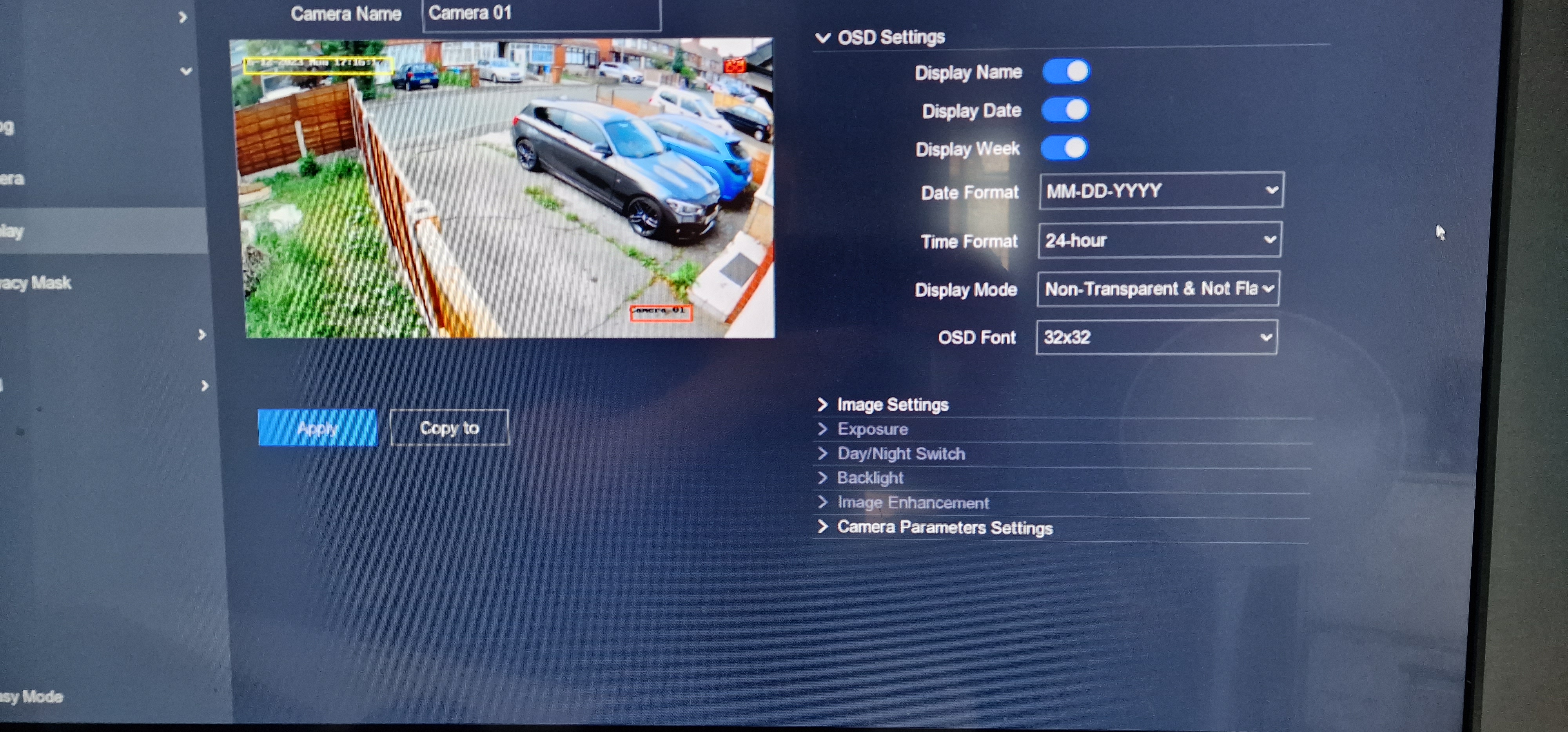

At night it has a light on constantly and i would like to turn it off, Ive seen lots of posts on how to do it on the Day/Night Switch settings but when i go to my settings a few options are greyed out. Attached a picture of the greyed out settings (Exposure, Day/Night Switch, Backlight, Image Enhancement)

Those headings in the menu are greyed out because they're not adjustable from your DVR. Exposure for instance isn't adjustable for the analogue HD cameras that you have (HDTVi) - it's only adjustable in the IP cameras.
