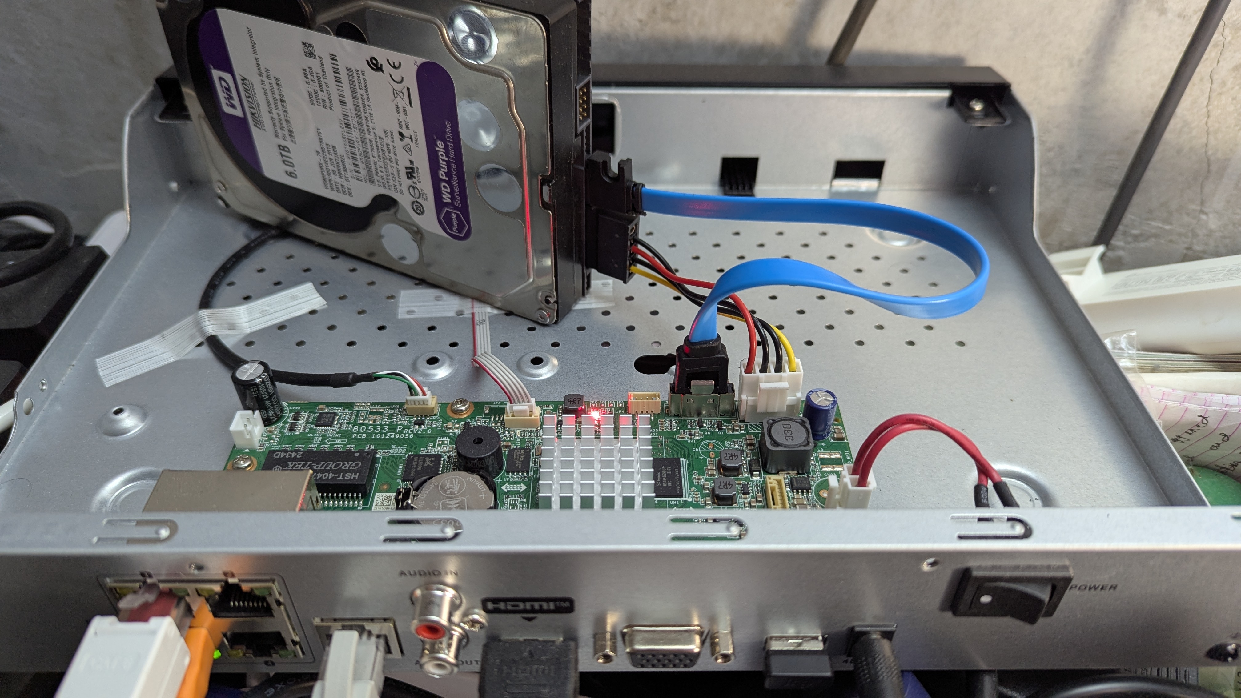

Given what you said about the power cord I just decided to use the one for the other unit, a DVR, I had for now. It fits so that's great. Any idea what that is called and how one would go about ordering another one? I saw someone call the weird sized head on the cord a molex 4-pin
Hmm. I'll attach a picture of it
