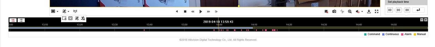

I'm trying to get the events showing up on timeline with continuous record like in 1st pic I have attached.

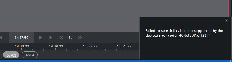

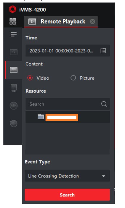

Looking at another thread says it can be done in iVMS Event Playback but I get 'not supported by device'

I'm afraid that it isn't possible to use the Event Playback feature on standalone cameras, so you will need to get an NVR for this to work, as you say.
It's been discussed more in this thread, but we've checked on several NVRs mentioned at the bottom of the thread to confirm it does work on those:
