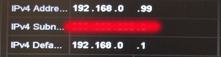

Thank you for your continued help. I have attached an image that I have grabbed by going through Menu>Configuration>Network on my standalone monitor and then it shows my NVR IP at the top of the image and my router IP at the bottom. It isn't working when set like this.
Can you confirm that you needed to change it to what you have shown? Was it as I thought 192.168.0.99 before the change? If you have needed to change it can you confirm which apps you are using on your mobile phone and iPads? - it will be either iVMS-4500 or HikConnect.
Once I know the above we can amend the site details in the app to match if necessary.

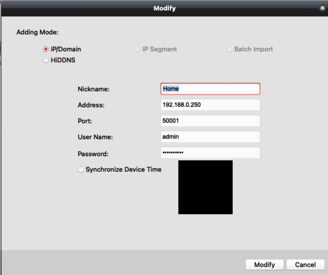

Thank you again for being very patient and helpful. I have attached an image showing the original settings. I have just tried to log in on my mini iPad and it says HiKConnect but for initiatty I would prefer to get the actual cameras, live and recorded view, etc. etc. on my Windows desktop pc which is wired to both the NVR and the router.
Ok so that confirms (as suspected) that the old routers local network was 192.168.0.xxx and the new router uses 192.168.1.xxx
So the setup for getting the system viewable on your desktop is different to the phone.
Now that the NVR is on the same local network as your router, you should be able to access the NVR using your web browser on the PC by entering the IP address in the address bar - http://192.168.1.99 That should bring up a login page where you will use admin as the username and whatever your NVR admin password is. That will allow you to view live and recorded images. You can get additional functionality by downloading and installing the Hikvision iVMS-4200 software on your PC (if you haven't already got it). iVMS-4200 is not particularly user friendly. Try accessing the NVR from the Windows PC using the web browser initially; and let me know how you get on, as that will confirm connection is working before proceeding any further.

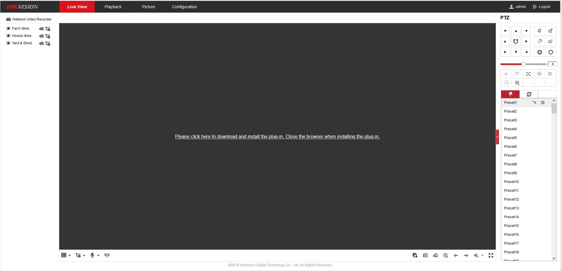

I have added an image after typing in that IP address and logging in. It is nothing like the screen that I used to see when looking at my system. I think I must have been using the Hikvision iVMS4200 software prior to this time. I do have a folder in my Windows (C:) directory of my pc entitled iVMS4200 but it only contains 2 folders: Capture and Video and they only contain captured videos and images when I have used the facility to download them which was in in the bottom right hand corner of the main viewing screen or the Recorded screen.
Ok so it's connected successfully. The ability to view using the web browser is dependant on having the plugin - you can download that and install it as per the prompt. It's also web browser dependant - some work, some don't (be thankful you don't use a Mac as the support for them is woeful!). Using the web browser can be convenient for simple viewing and playback along with configuration without using the monitor and mouse.
If you have those folders you certainly have (or have had) the iVMS-4200 software installed. Those folders are created automatically and just store images and footage that you save while using the software. See if you can find the application itself from the windows start menu and I can talk you through amending the address in the software to get it working again. If you can't find the software you can just download the latest version. It's here:

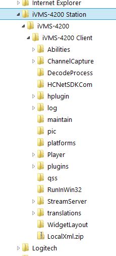

Thank you again. I seem to be losing the plot a bit ! Of course those folders are just storage folders, the program is in the programs folder, as shown below.
Apologies for that.
With regard to downloading the plugin I have read that IE is the best browser to use. I actually use Firefox, Chrome, and Edge as my browsers but I still have IE on my pc if that is really what I should be using.
With regard to versions of the software I am currently using V3.4.106 Build191009. My Menu>Maintenance>System Info>Device Info tells me that this is the latest version. I discovered a couple of months ago that I was still on the same version as per the installation date and that was nearly 5 years ago. A very kind person on this Forum helped me to update but I managed to make a pig's ear of that process and had to get it sorted out !

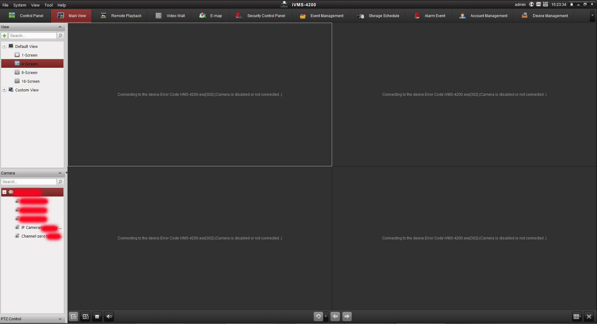

I have also attached an image of what my interface looks like on my pc with camera names etc. hidden.. Obviously there are error codes where the cameras should be. I only have three cameras, one of them being a PTZ which I can manipulate once I have double clicked on that camera and then clicked on the PTZ icon. iVMS front screen.JPG
Apologies for that. View attachment 6245

I have also attached an image of what my interface looks like on my pc with camera names etc. hidden.. Obviously there are error codes where the cameras should be. I only have three cameras, one of them being a PTZ which I can manipulate once I have double clicked on that camera and then clicked on the PTZ icon. View attachment 6247

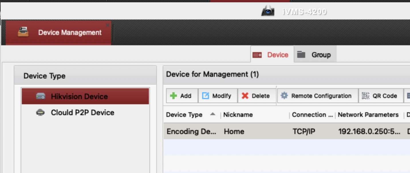

You just need to go into the Device Management tab at the top right of your screenshot. The software will be expecting to find your NVR at its old address 192.168.0.99. Select the NVR in that page and alter the address to the new one 192.168.1.99 and you’ll be back up and running (locally). You will see your device in the top panel of the page - either double click the line or highlight it and click modify to bring up the properties box for the connection - then just alter the one digit in the IP address from 0 to 1 and Save/Apply. Screenshots of mine below - though yours may appear different as my software is the Mac version:
View attachment 6248View attachment 6249
You Sir are a star.:):):). I have now got things working on my pc like they used to Still can't get the iPads to work but I ought to let you have the rest of the weekend off. Thank you very much. If you ever want to know how to lamb a ewe, plough a field, or set a combine harvester then come back to me.
