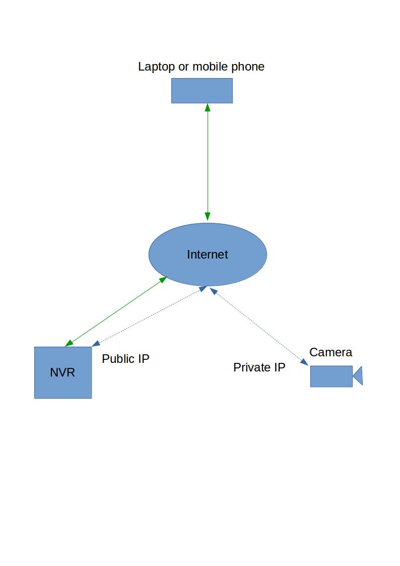

I need to connect the several remote IP-cameras (Hikvision DS-2CD2020F-I) to NVR (Hikvision DS-7104NI-SN) through the Internet.
The cameras have "grey" IP-addresses. NVR may have "white" IP-address. NVR is located before wifi-router.
Could I do this? How can I do this?
Thanks.
I don't know that NVR and its setup possibilities. The only way it would be possible is if you were able to configure port forwarded remote access to the cameras from the internet AND the NVR will allow you to enter the full pathname(s) to reach your cameras.
