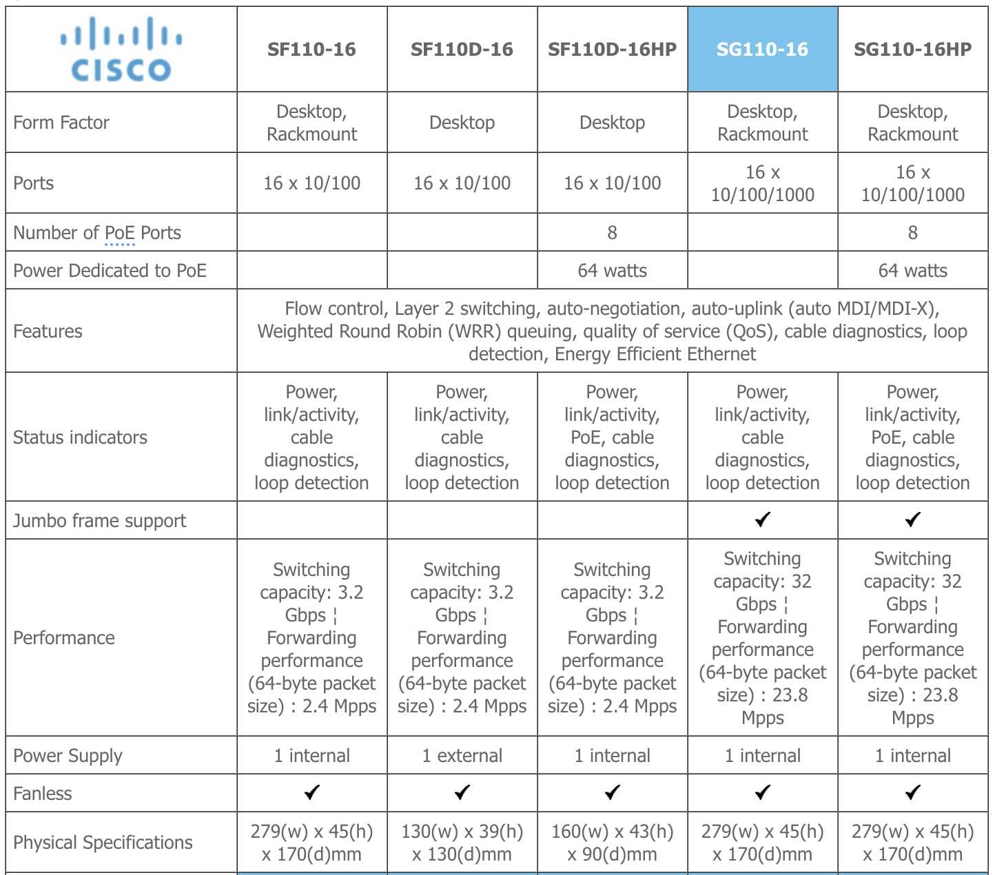

Do you have a CISCO SG110-16 or a CISCO SG110-16HP?
If it is a SG110-16 then that is the non-PoE model, see the table below:

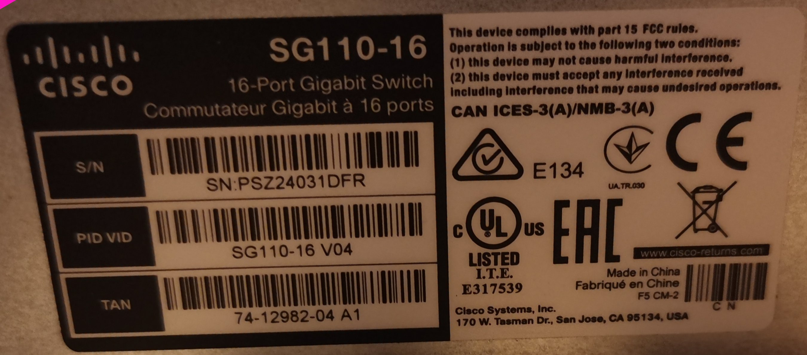

Label shown off the back of the CISCO unit.
It does seem that you have the version of the switch that does not provide POE power :(
