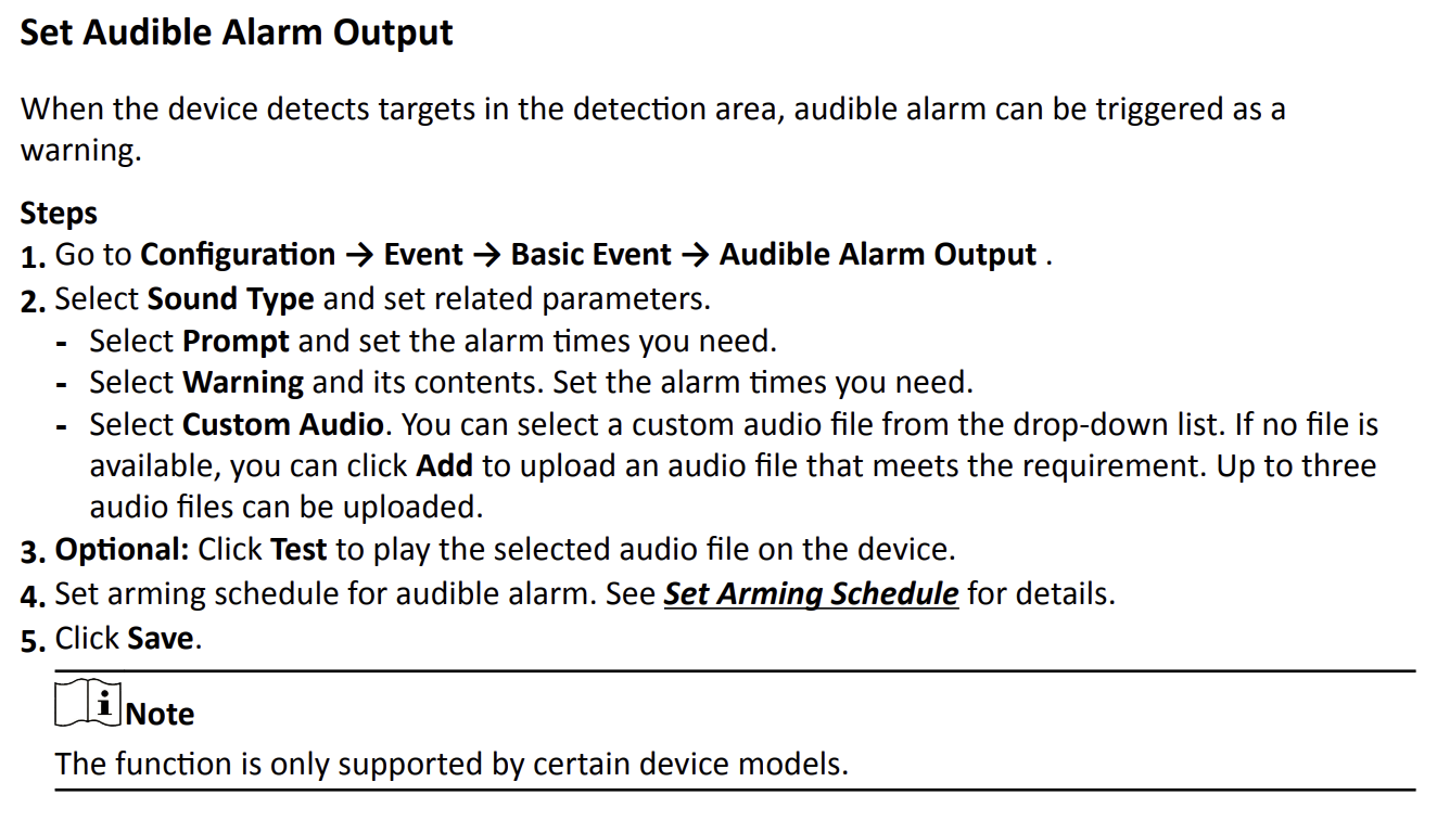

Hi @Lev
I'm not sure if even on the latest firmware you can manually trigger an audible alarm, but below are instructions to configure event-triggered audible alarm output (which should be supported):

thanks, looks like I really need to update the firmware to all of my cameras. Can you tell if this model is also belongs to G1 category?
