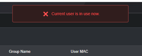

I have multiple Dahua DVRs and each one has multiple user accounts. Each time I want to edit a user account (remove access from a camera, change password, or simply remove the user) I can't, and I get the error that says: "user is in use now" as shown in the image attached below. To solve this, I have to manually go to the user's PC and close the SmartPSS software(or manually log out from the DVR) to be able to make the new changes that I want. How do I make changes to users that have the SmartPSS software already running, or at least be able to log them out without having to do it from their computers?
