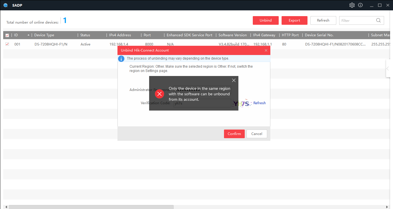

Hi @Dan,
Thanks for the help. The error has now changed when i moved to another LAN with it and it says,
"Only the device in the same region with the software can be unbound from this account."
Please advise on what the solution could be.

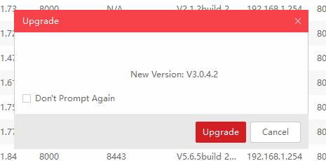

Download the latest version of SADP (V3.0.2.4) from here:
See the attached Release Notes on setting the region to other, and then try again to unbind.
Despite the above version being THE newest I could find at the portals, when I installed it and allowed it to check for updates it then found a newer version V3.0.4.2 which I have now installed (and it does seem to be THE latest).

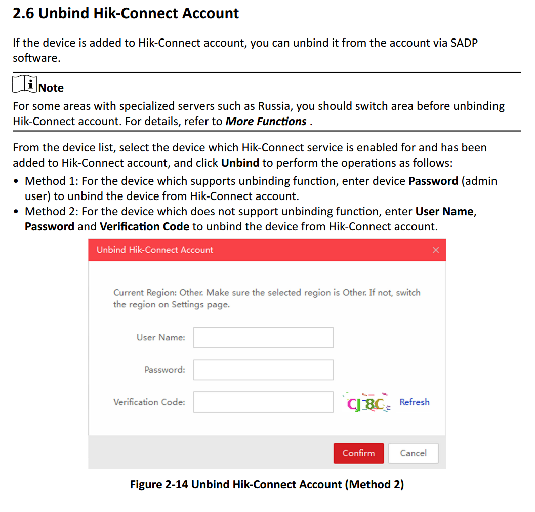

From the user manual for that latest version (attached), here are the unbind instructions:

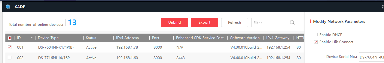

Top-centre in SADP:
(Make sure you put a tick at left side for the device you wish to select)
Are you using a Windows 10 PC?
Wired to the same LAN as the Hikvision device is on?
You have installed that latest version of SADP?
If so, can you upload a screenshot please?
