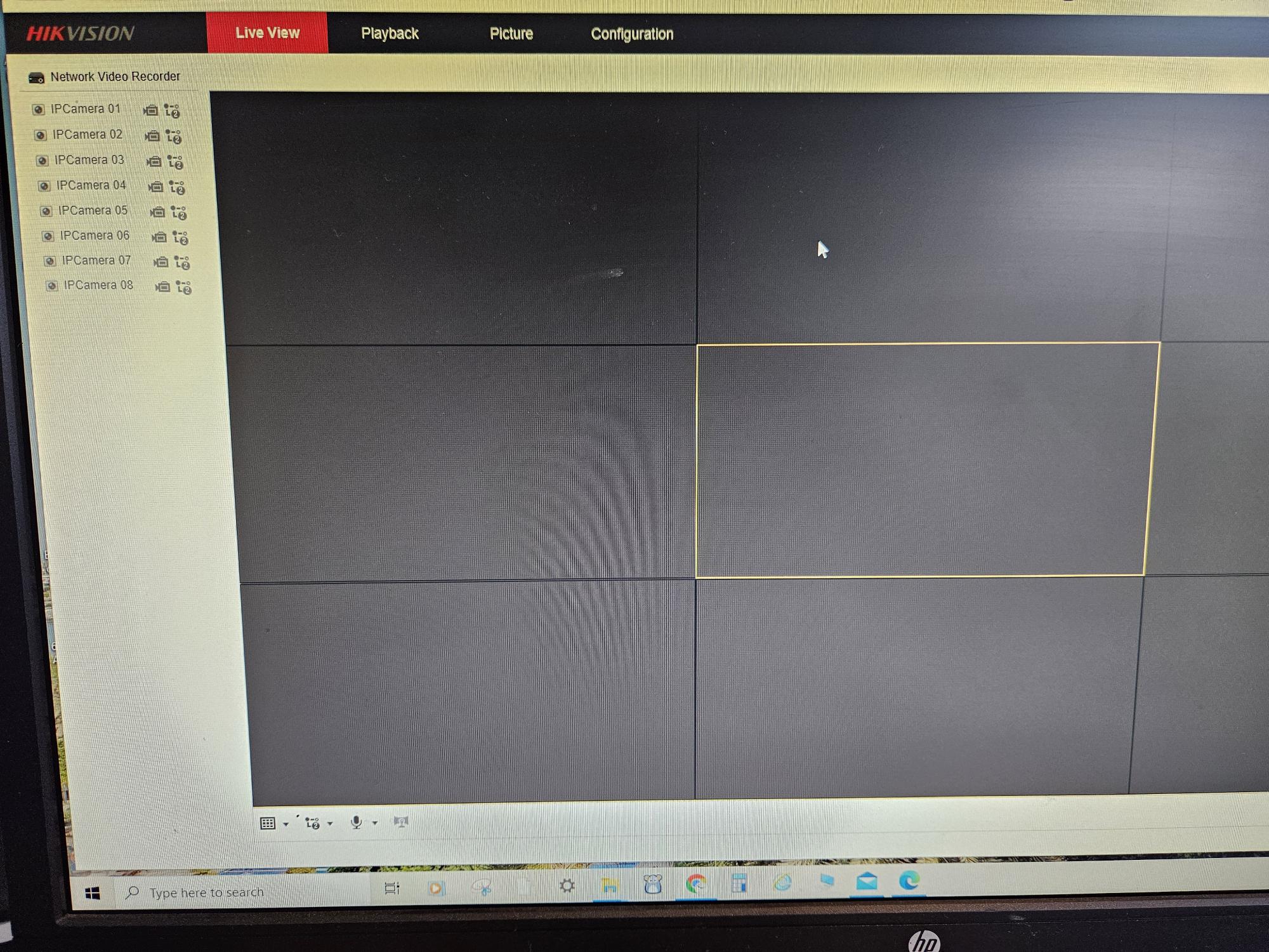

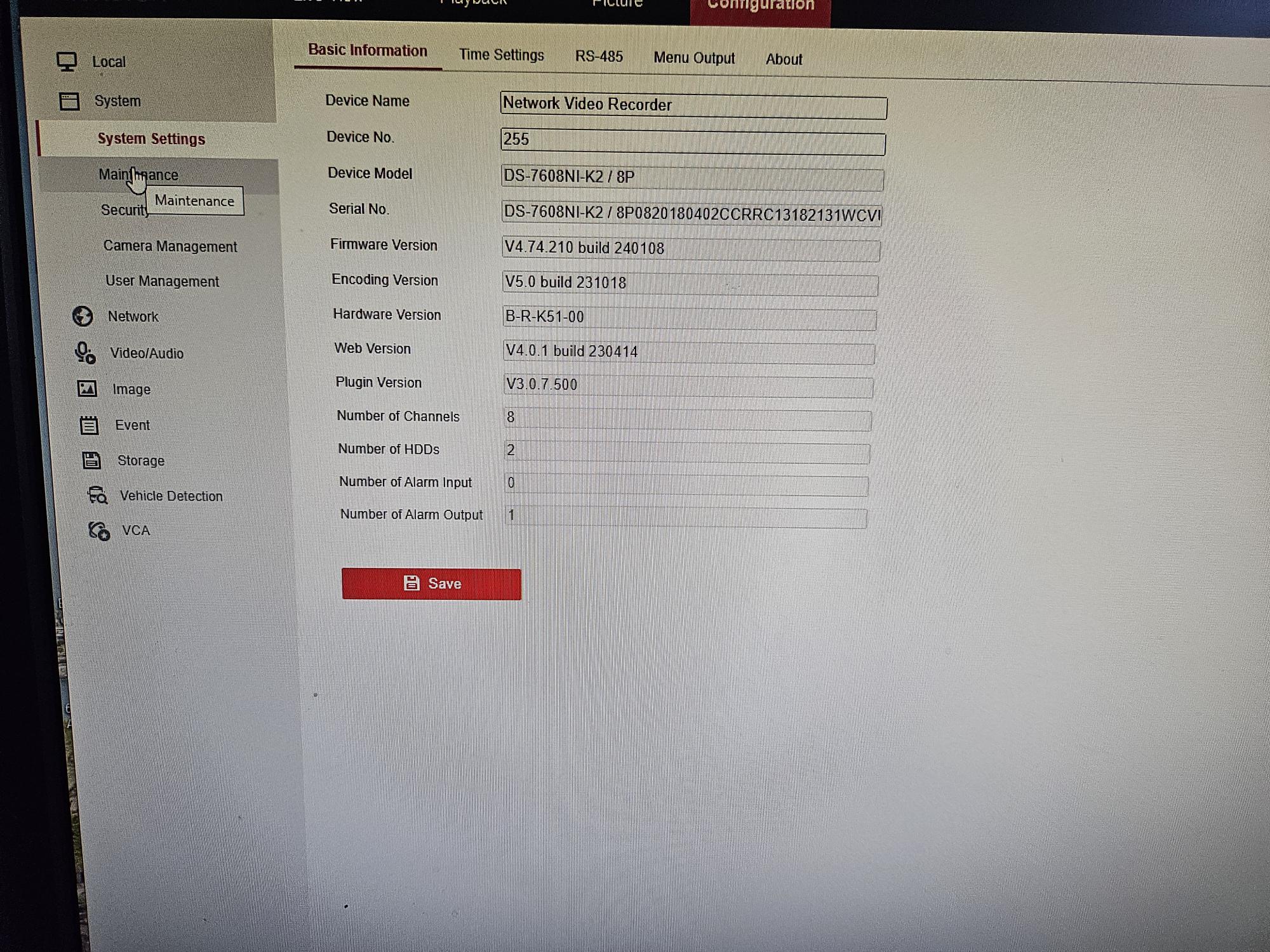

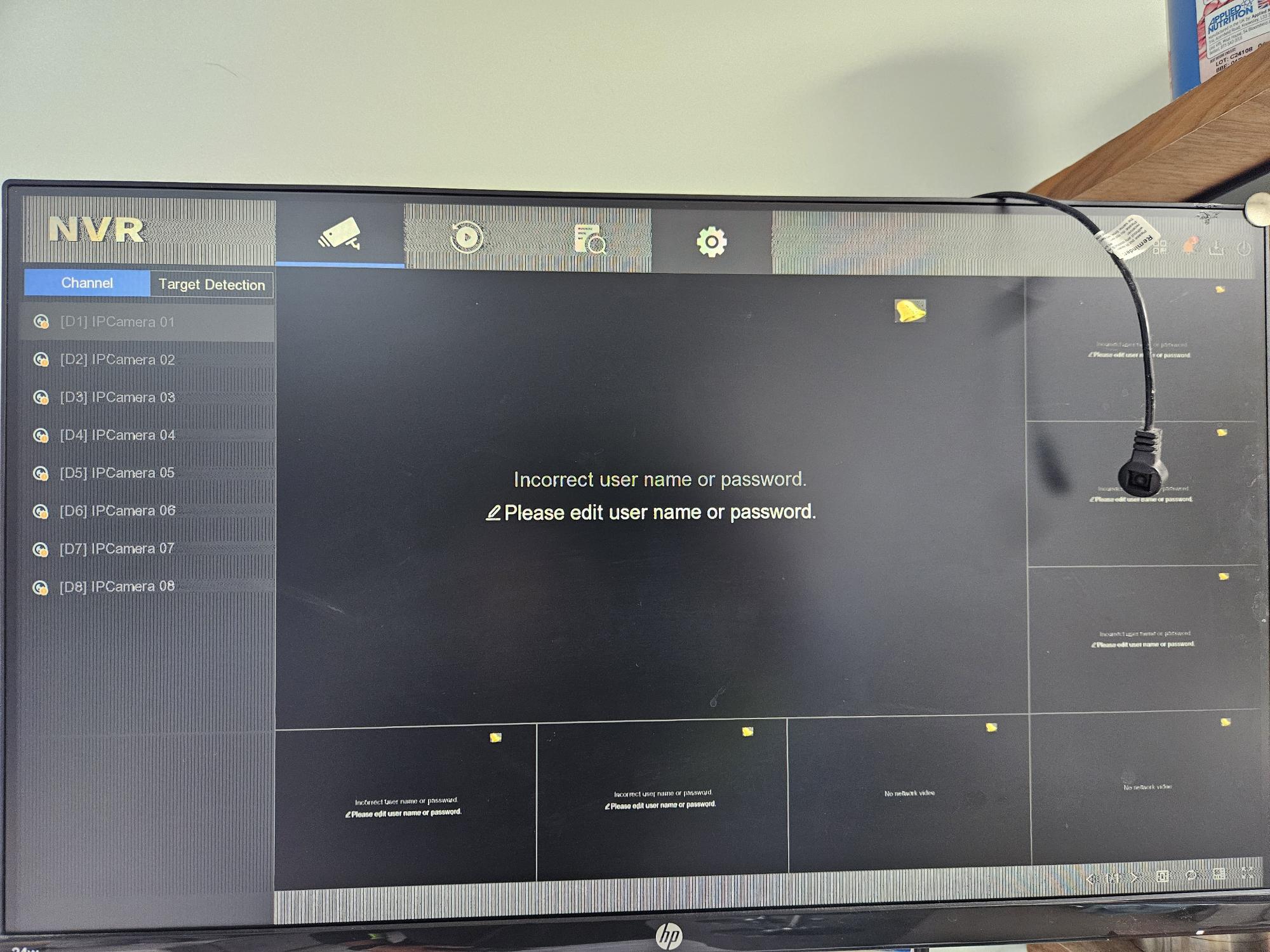

I wonder if you can help. Everything has been working fine with my system until i upgraded my hikvision nvr to the latest firmware today. I've attached a screenshot of my hardware and the firmware details together with a view of the what i see when i Live View.
I suspect the problem is something to do with an incorrect username or password as per the error message (attached). This monitor is connected to the nvr via hdmi. This monitor is used to view the cameras from the nvr, however can't seem to understand why it says incorrect username or password when i have logged in via a browser but just cant see any of the cameras.
Please advise.
I have reverted back to the previous firmware but that didn't work so I have gone back to the latest to help troubleshoot.

Hi @Chet
Can you please confirm the camera models you have connected to the NVR? Are those cameras connected directly to the NVR PoE ports?
Can you remember what firmware version your NVR was running before you updated to the latest version?

The firmware I was using was the previous one to the latest one, the 914. see attached.

Thanks @Chet
In the NVR settings under Camera Management, do you have Virtual Host enabled so that you can directly log in to each camera?
If you don't, please follow the instructions linked above to enable Virtual Host, log in to each camera, and then post in this forum thread the firmware versions currently being used by each camera.
I get the sense from you not being too sure what camera models you have, that you've probably never logged into the cameras and updated the firmware. If that is the case and the cameras have been installed since 2018/2020, they will likely be running very out-of-date firmware and this old firmware could be causing glitches with new NVR firmware.

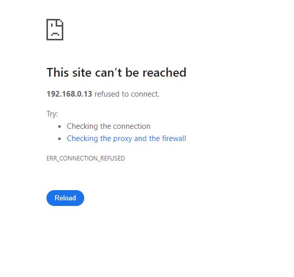

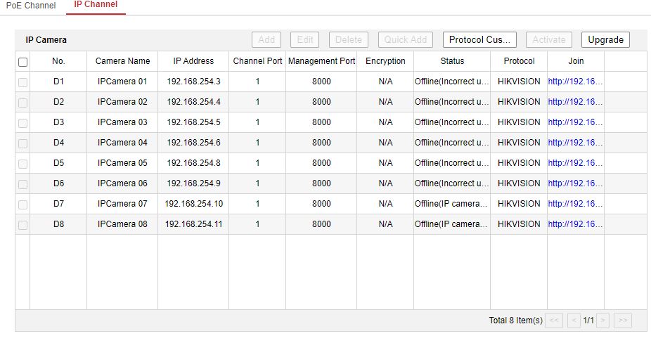

I've attached pictures of the what the IP channel is showing. The cameras appear offline, and when i click on the individual IP address url's for the cameras i get a unable to reach host.
I think you maybe right about the camera upgrades part but i think right now we need to get past the authentication part where its not recognising a username or password (which may be related to the camera upgrade you are referring too).

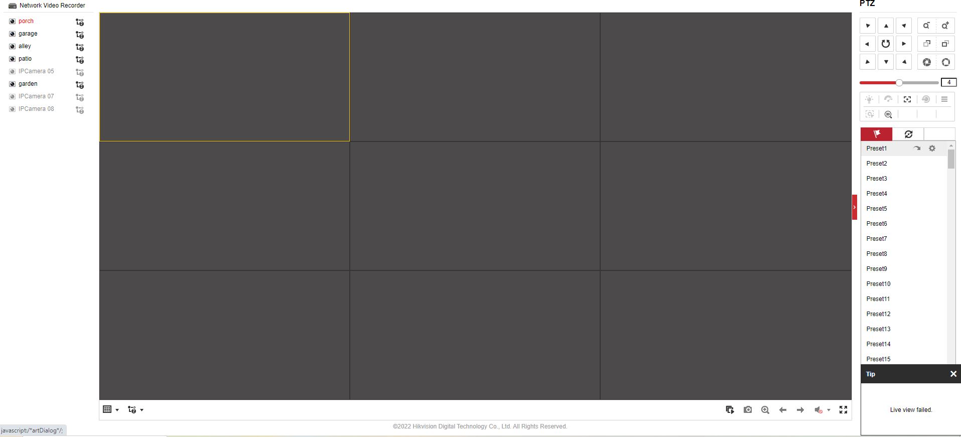

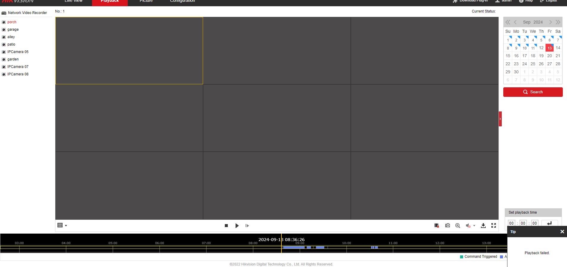

I can see connect directly to the NVR and get view of the cameras however using the ip/browser I get a Live Failed error. It did work briefly today but for some reason its now not working.

ignore the above i've installed the plug in, refreshed page and its now working. brilliant....ticking each issue off. Now for the hik-connect. Any advise you can provide please message back to get this working again. I'll also see what articles are on the forum to assist me
