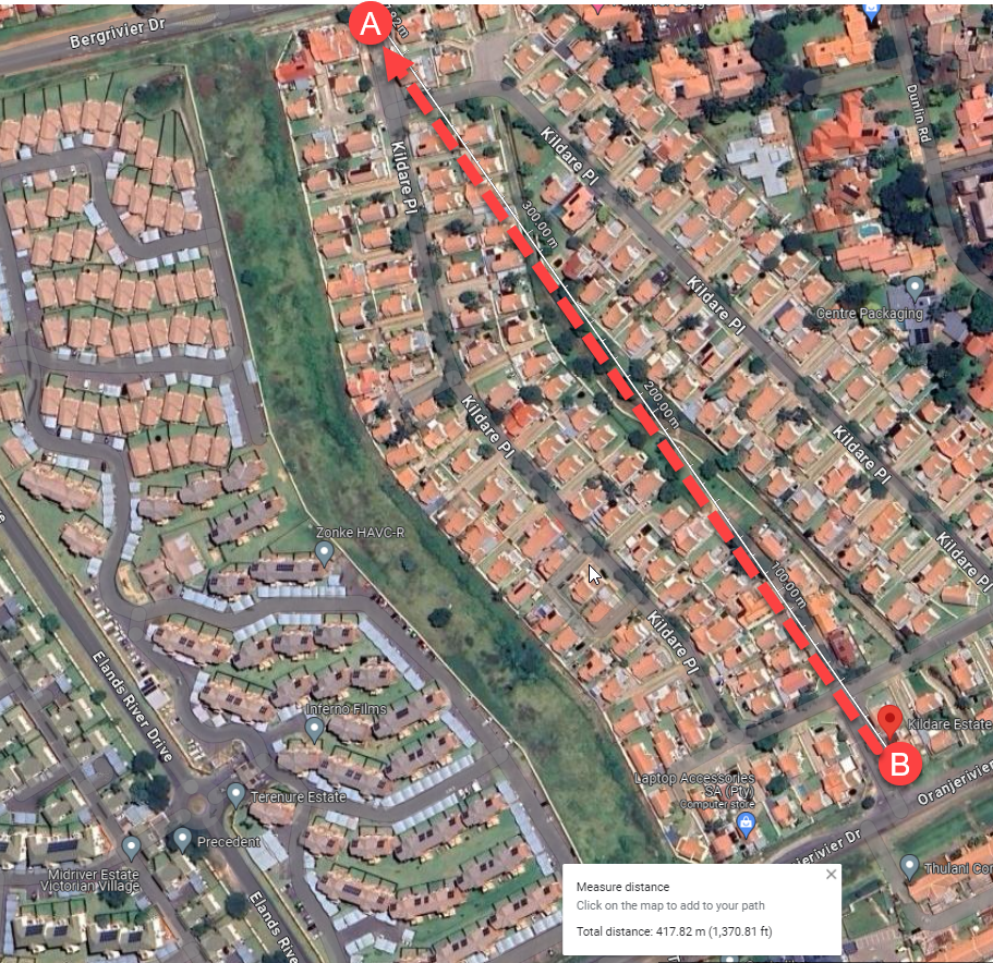

Help experts, I have a project in which I need to have a gate station 500m away from the indoor station.
I can't run a cable because of the distance so I wanted to know if I can use Nanostation (Ubuqiti) to connect the gate station and the indoor station?
I will have 2 POE switch one for the gate station and the other at the indoor station.
Please help with ideas, will this help??????
I will appreciate your help.
I have attached a picture.
In theory, if you can install the Ubiqiti wireless link and get it to work reliably, then it should be fine (transparent).
